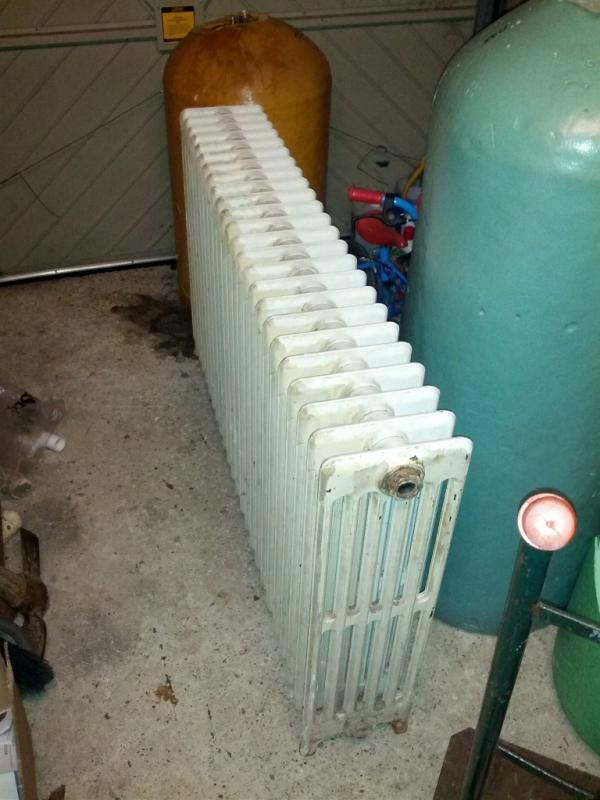

They will work fine, but will need to be BIG.
To get you started - I have a lovely 1300 x 800 x 4/5 column one in my garage for sale.
Just needs a quick clean and a coat of paint.
P&P might be a little steep mind you. It ways I would guess nearly 200kg.
**Edit ** it's 6 columns
