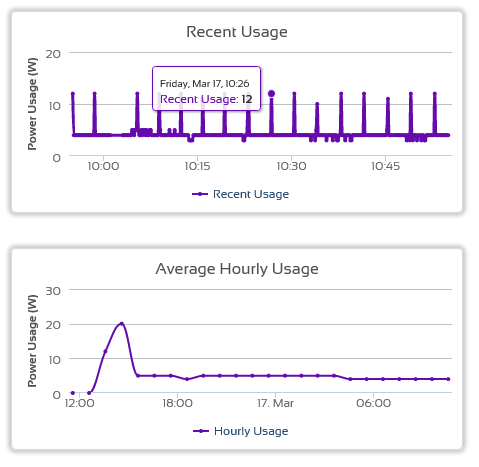

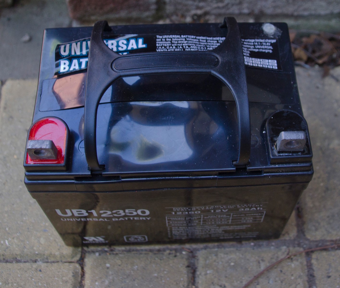

This 1679050605883.png is the charge rate of my jump start unit which also has a VRLA in it, I got it from my late father-in-law so at least 15 year old, and still going strong. But over charging causes this DSC_3937.jpg it was in a mobility scooter, and one cell in the other battery of the pair when short circuit, so even at only 5 amp the charger cooked this battery.
So the Lidi smart charger starts at 3.8 amp, and at a set voltage reduces to 3 amp, and then at 14.4 volt reduces to 0.8 amp and it will not auto revert to 3 amp, so it will not cook a battery even with a shorted cell, then it will drop further to 0.1 amp, when set to over 12 Ah, and alternate between 0.8 and 0.1 amp, under 12 Ah it alternates between off and 0.1 amp. So each time battery reaches 14.4 volts it turns down charge rate, and each time it drops to 12.8 amps it raises charge rate.

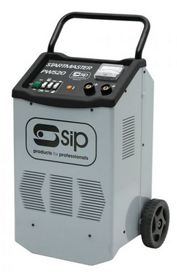

You can get large versions, we have this 1679052110591.pngone at work, 12 and 24 volt, and a lot higher amps available, up to 40 amp charging rate, and price to match around £330, and still designed for AGM batteries, but in the main chargers for AGM are not over 5 amp, and are designed to connect and forget, typically it can take a week to recharge a battery left to go discharged, it may get enough to start car in a few hours, but to fully recharge the battery in extreme cases can take two weeks.
