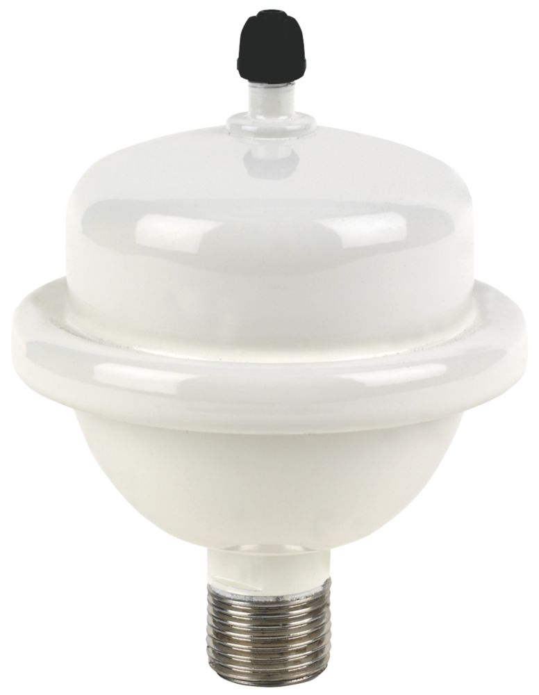

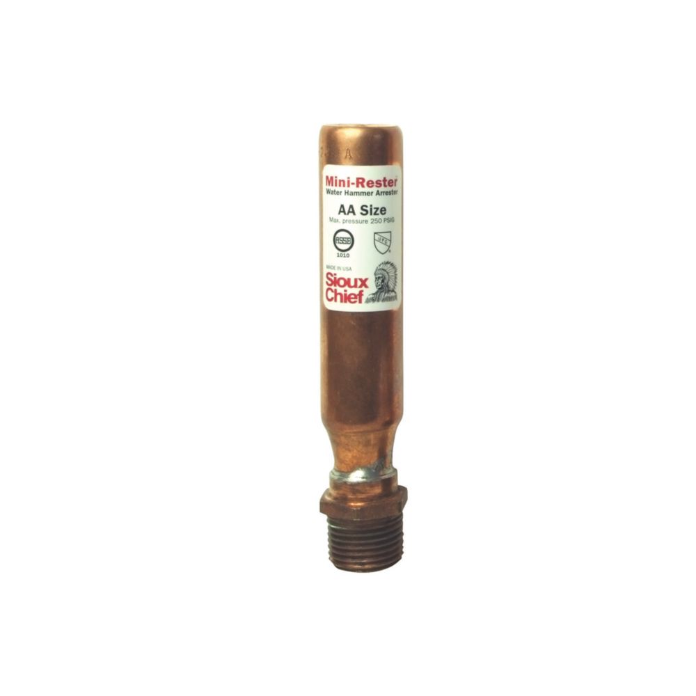

I see there're three types of water hammer arrestor on the market, but which is most effective - and does it need more regular maintenance?
There's the sealed off type with a small diameter piston and an air cushion:
ae235
There's the broader squat type with a piston and spring in it (to my mind, more likely to rock about laterally and pass water by the seal):
ae235
Or there's the type with a diaphragm and is re-pressurisable when/if so required:
ae235
But type is least hassle/works best?

Well, I went for the micro-expansion vessel type - it leaked....
Only slight weeping at the seam between the two halves, but there was/is enough of a drip to damage the LED lighting panel in the ceiling below. Grrr.
It does say rated pressure 15 bar and my regulator is set to 3.5 bar. I recognise that pressures involved with water hammer are many times higher as the pressure wave bounces along the pipe. It does say 'check' pressure in diaphragm every 6 months (obviously I haven't) so there's a chance the bubble has gone.
So now have choice of the other two, piston-in-sealed-chamber types.
Nozzle
