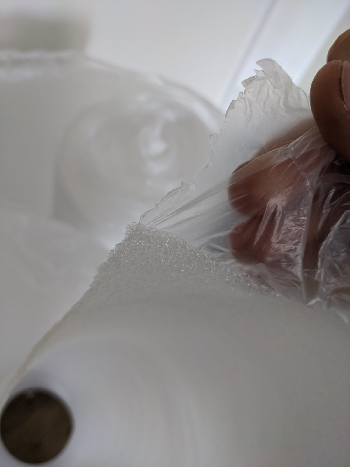

Hi all,
I've got this white foam laminate underlay which has film on one side.
Does the film go against the floor or up in the air?
Also am I best taping the joints or not bothering? And I assume the underlay doesn't need securing down and the laminate on top will ensure its all secure?
Pics attached, thanks. Phil
I've always assumed the the film is a vapour barrier so film side down. Taping the joints just stops it flapping about whilst fitting the laminate.
