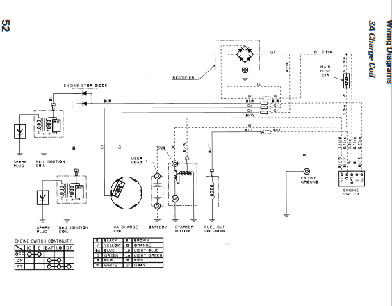

Hello,
I am installing a new engine into a second hand ride on mower and there are no existing electrics at all at the moment. Can someone tell me what type/gauge wire I need to make all the relevant 12v connections from battery to ignition, to solenoid etc.
If it is not to much effort can someone draw a layman's diagram of how everything is connected.
There is a solenoid attached to the engine at the moment.
Would be much appreciated
James
Ps I will be using a 35ah 12v lead acid.battery and there will be no other things like headlights etc .

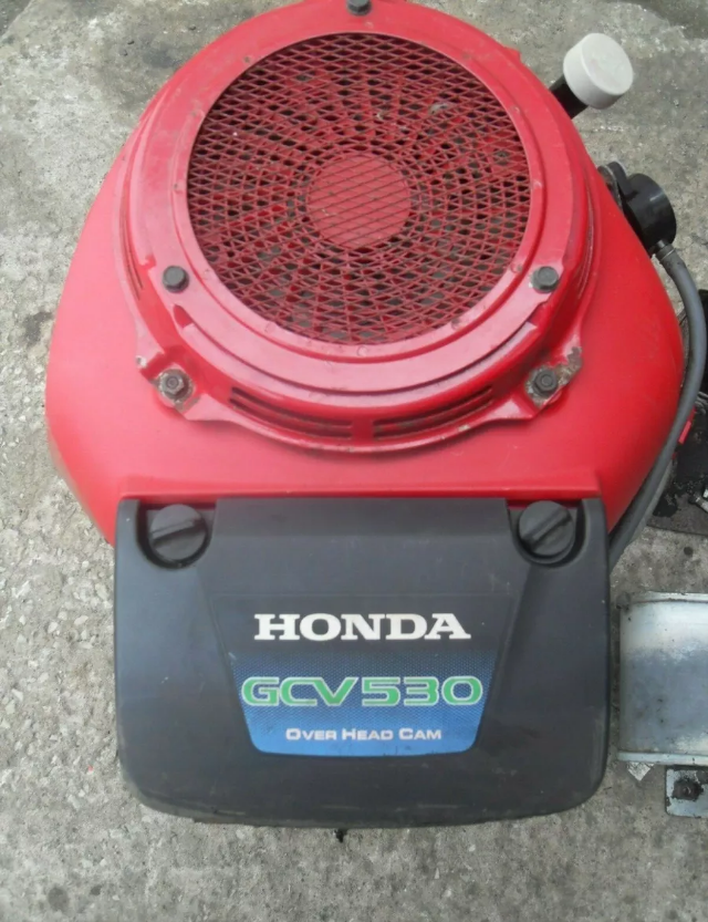

Thanks, this is the engine and it is 16hp. I was going to use a 35ah 12v battery ?
The manual gives you all the sizes, 15 mm² for starter motor clearly in UK 16 mm² and it recommends a 45 AH battery. I did wonder if AWG but think W 2.0sq means white 2 mm² which seems a little small for 25 amp fuse but motor vehicles always seemed to use thinner cable to mains.[/URL]
