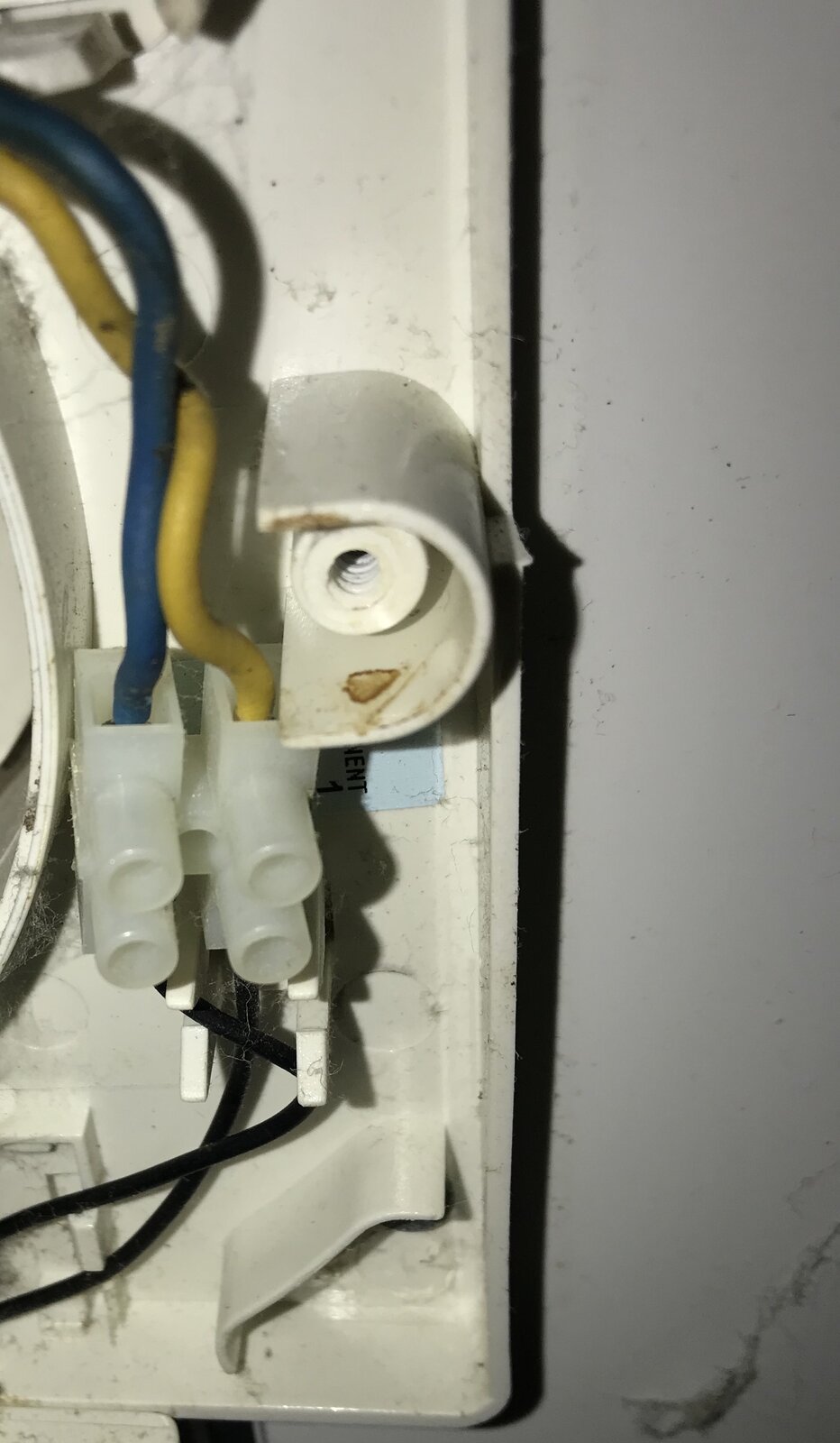

Hi,
Am going to fit an extractor fan and just want to make sure I have the wiring right.
It’s Going to be connected to the light switch and there are three wires present already, red, yellow and blue.
my understanding is the following;
Red=live
Yellow=switched live
Blue=neutral
would that be accurate? Thanks for any help.

I thought you meant you were going to connect a new cable to the light switch where there were three wires present already.
So the wires might be connected to the light and not the switch.
If the old fan came on with the light and the Yellow and Blue were connected to the old fan then you are correct.

The wire that was not connected to the old fan will likely be the permanent live . What's connected to the old fans live and neutral terminals ,yellow and blue ?
I have had a look and the yellow and blue wires are connected. The red wire is there but taped up. I have included picture below. A wire connector has also been used. There are two black wires coming out the fan which go into the wire connector. The blue and yellow then also also go into the wire connector. Does it matter which black wire is joined up to which coloured wire?
I will need to get a 3 way wire connector as well. Never used a wire connector before, do I need to get a specific one or will any type do? Thanks for your help.
No, but your new fan will not be like that, will it?
Why?
Well, they do have current ratings - 5A, 10A, etc. - but for general use, and light circuits, the smallest into which you can get the wires you have is adequate.
Why?
New fan is the same except for being on a timer which means all 3 wires will fit into it.
The wires aren’t long enough to fit into the fan directly and as there are 3 of them will need to use 3 way wire connector.
