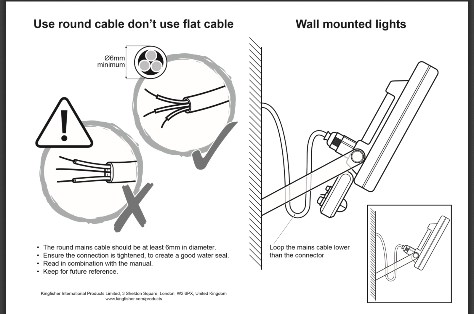

Which wiring/cabling?

Twin and earth is the flat cable used in internal wiring. That is not the type you need.
You need a round, flexible 3-core cable with an overall diameter of 6mm.
Don’t get confused, the 1.5mm you refer to is actually 1.5mm² - this refers to the cross sectional area of one of the live conductors.
The Wickes cables is huge. You need something like this
https://www.tlc-direct.co.uk/Products/CA0dot75F3Bslash50.html
If you don’t need 50metres then Sfx do this:
https://www.screwfix.com/p/time-3183p-black-3-core-0-75mm-flexible-cable-10m-coil/63318
'Round twin and earth' is called 3 core flexible cable.
The measurement of 6mm. diameter is purely to ensure a water-tight fitting and nothing to do with the wire size, whether 1, 1.5 or 2.5 square millimetres .
You need a round, 3-core cable with an overall diameter of 6mm.

:LOL: Actually went for the 1.5mm as opposed to the 0.75mm, but yeah I hadn't read your post in it's entirety obviously:LOL: Guessing I'm ok with 1.5mm right? And yes I found the black instead of blue!
