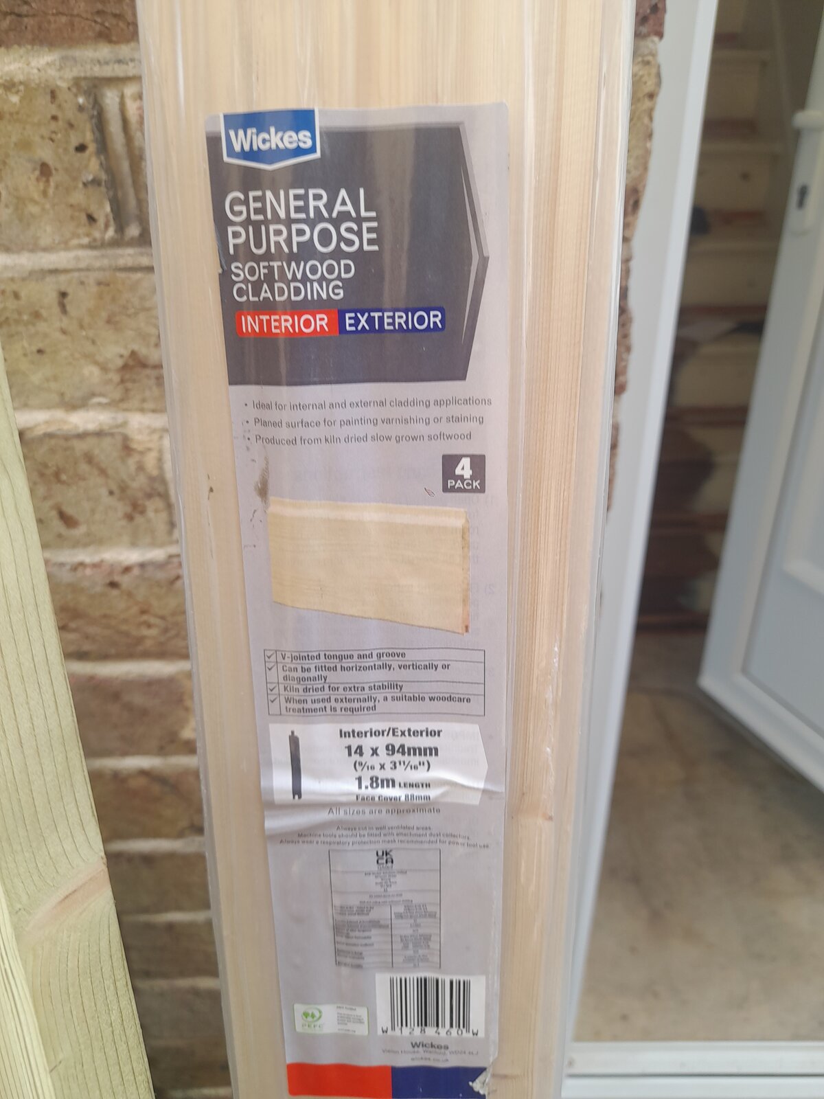

I just bought some of this T&G and some bracing battens.
Though not pressure treated it says it is suitable for outside if treated

Honestly? If you haven't opened it, take it back for a refund. It isn't really suitable for making a door out of with battens unless you want the flimsiest door....
If you do want to use it, make a frame out of 1 1/2" X 3, fit some diagonal braces and top/bottom supports out of 1" thick timber and then T&G the panel with that cladding so that the cladding fitted to the 1" thick timber lines up on the face with the 1 1/2" timber frame, cutting off the tongue/groove at the sides of the infill. But that does assume some DIY woodworking skills and some tools...

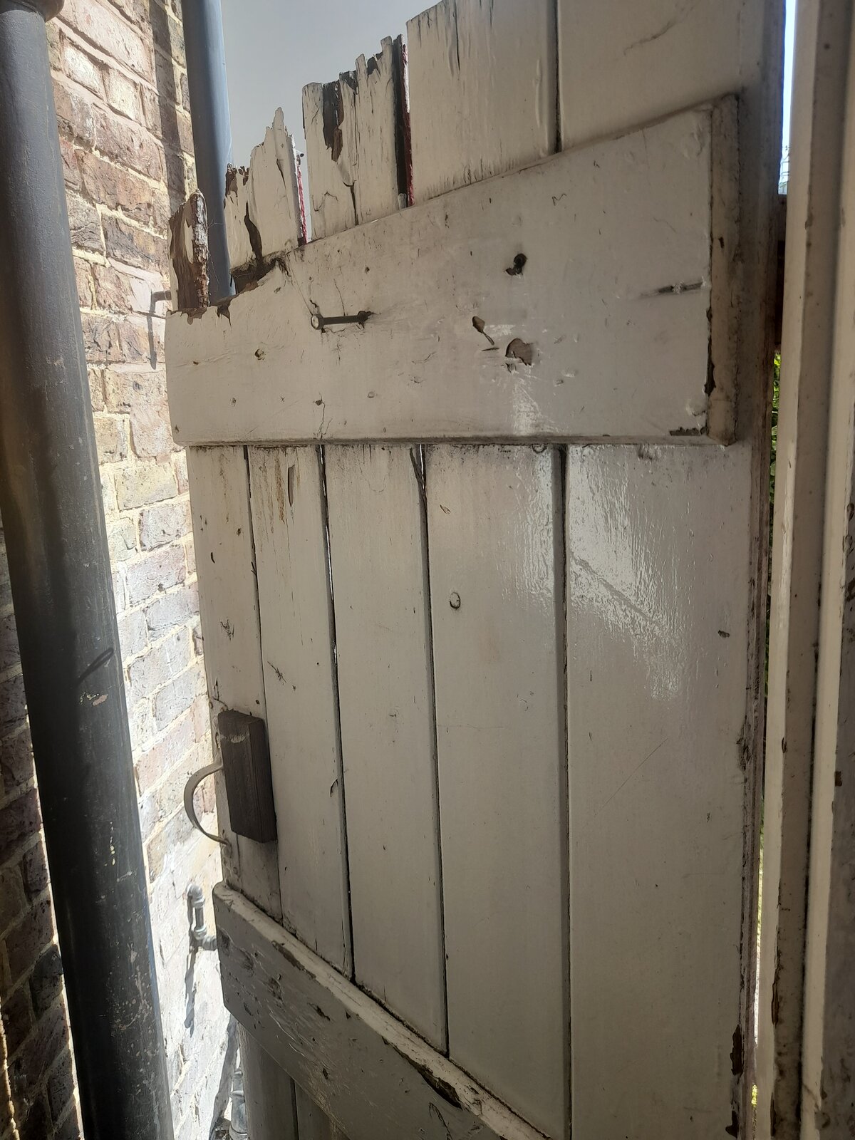

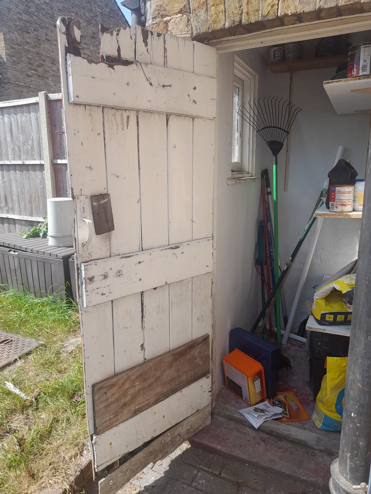

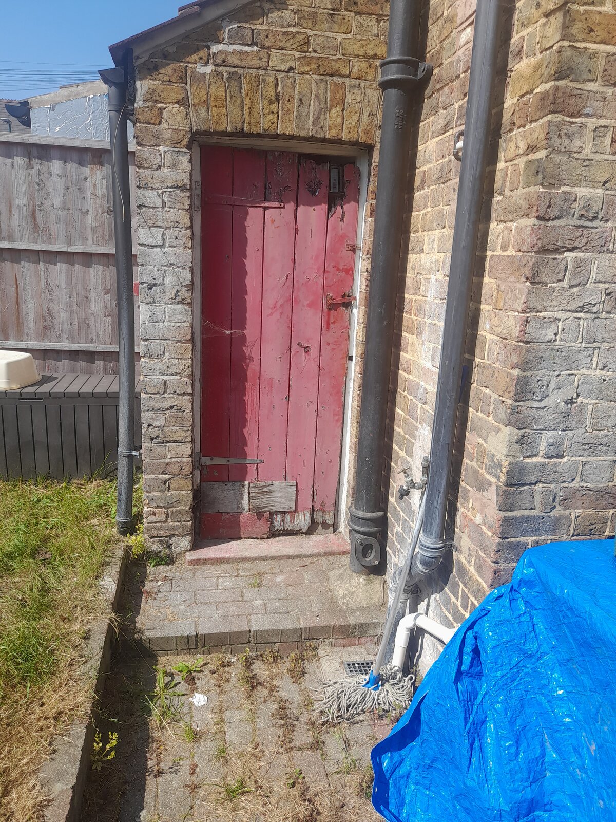

Here are a few photos of the old door/frame.
It doesn't seem repairable to me. I note the old door has 6"x1" planks as cross bracing but no frame as such. I guess I could copy this design incorporating a 3x1" frame and diagonal bracing.
I imagine the door will be largely protected from water ingress due to it being within an alcove when closed but direct sunlight will certainly be a problem. Would black 'barn paint be suitabke fir this? I do want it to fit within the frame though snugness is not a real concern.

You could quite easily just replicate that, no problem using KD if it will be primed and then painted twice.
Copying existing is far easier than designing from scratch. Just be sure to add a weather bar at the bottom, with a bead of sealant on the top edge. You could also leave a small gap at the bottom and attach a rubber strip where it touches the floor.
If cut the rotten ends off of those vertical boards, you might be able to reuse them as horizontals.

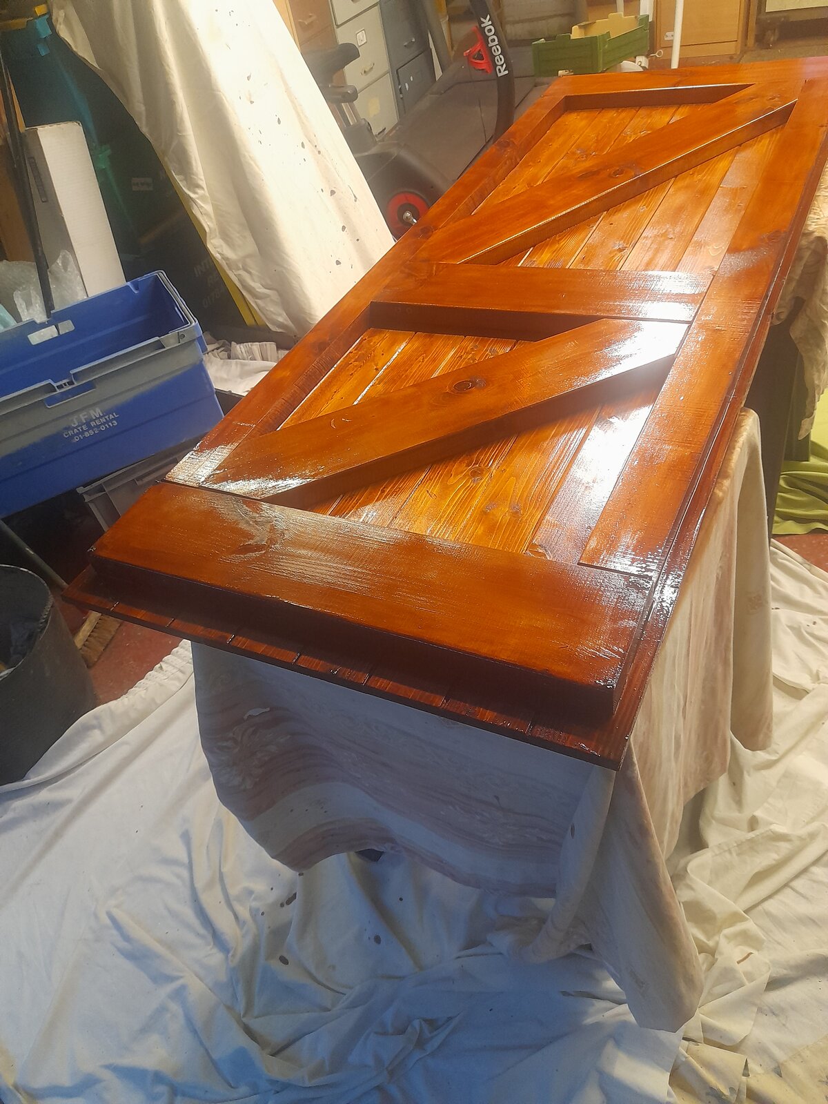

Hi all,

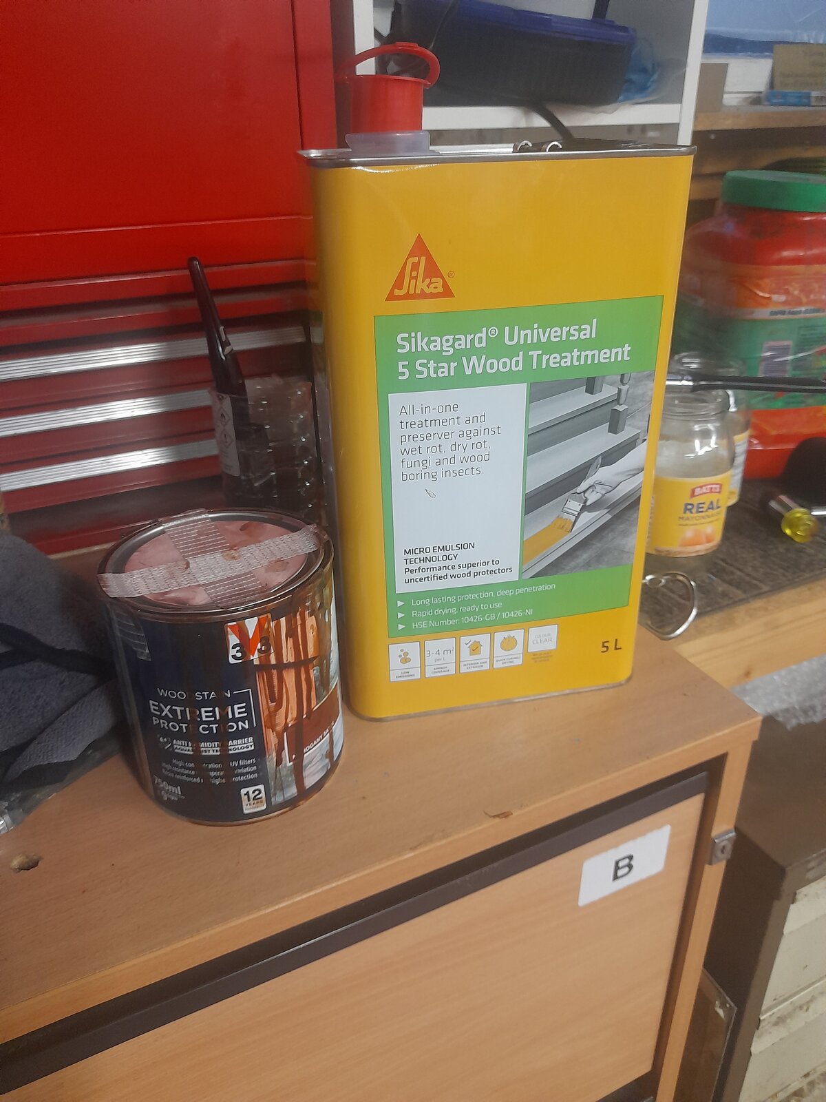

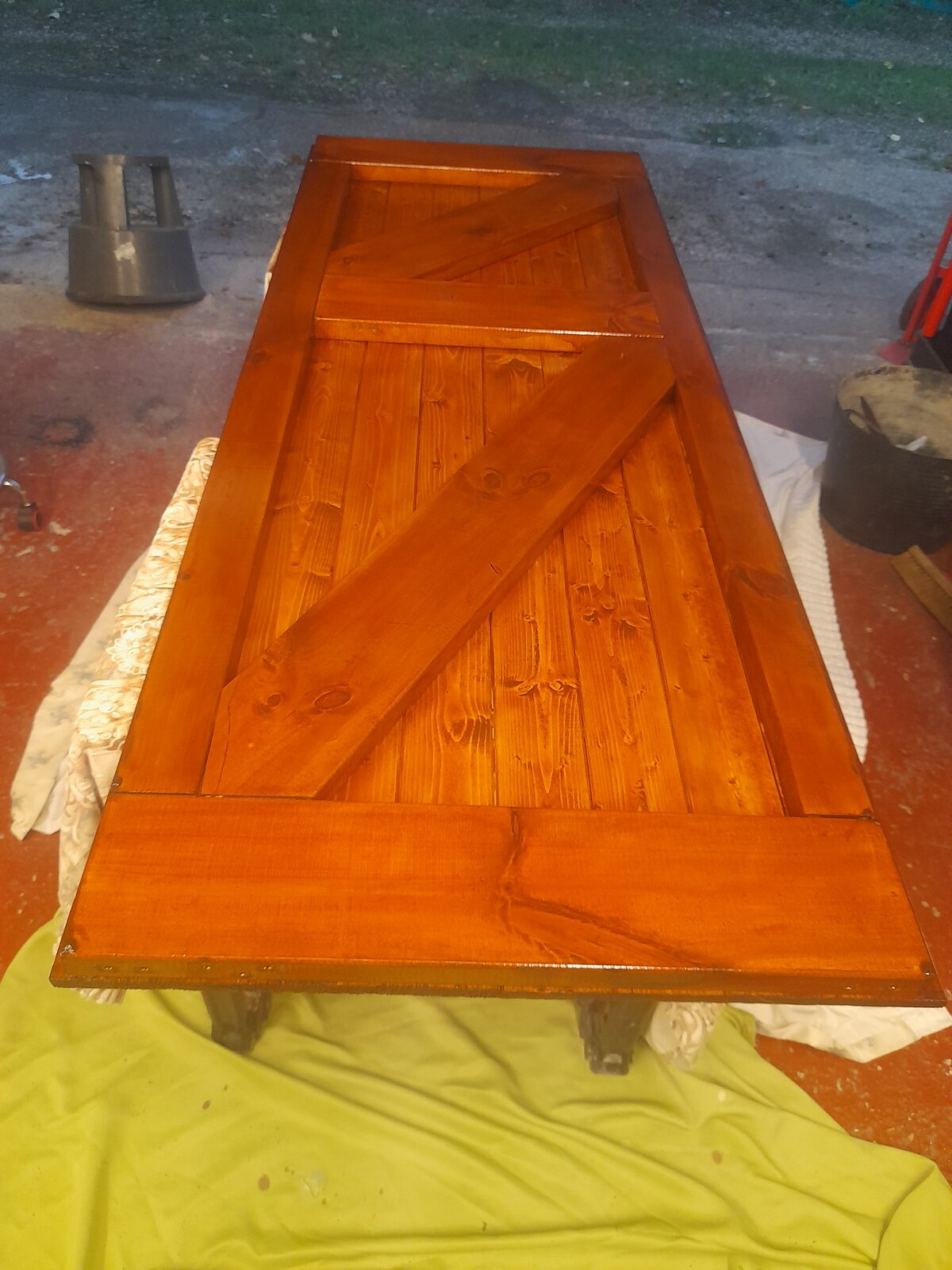

Here's the door I came up with. The crossmembers are of 5 1/2" x 1 1/4" and frame 2 3/4" x 1 1/4" planks i rescued from a bed I was getting rid of and brace the planks of kiln dried T&G highlighted earlier.
I treated and varnished the finished door with the products shown in the third photo, 3 coats of treatment and 2 coats of varnish.
Gonna hang it on Friday. Any tips?

You've built a hefty-looking door there, should last you decades if you keep on top of the treatment.
I do wonder how the previous door got to the state it's in, it looks reasonably well sheltered there.
Thanks for the tips Delux.
Yes WNI, it looks good but maybe I've over engineered it a bit. Damn thing is pretty heavy so I'm concerned the hinges will not support the weight. I'm using 3 hinges, they come to just over halfway across the door. I can't really go any bigger as I am limited by the width of the doorframe.
As to why old door got in that state, I've no idea. It has been in for at least 35 years and is subject to direct sunlight.
Looks to me like the thin planks couldn't take the strain of being slammed shut and the sun looks like it leached the life out of them, alongside the rainfall.
