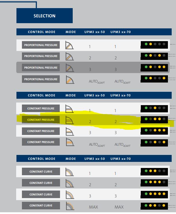

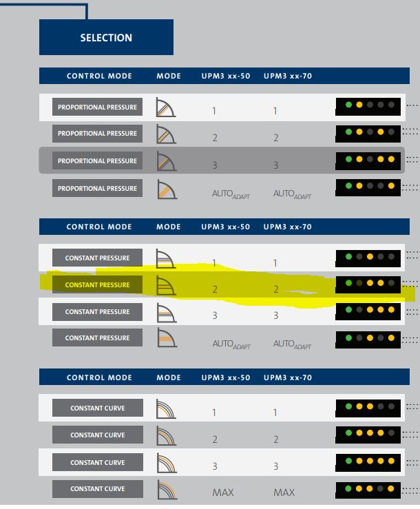

Similar problem here. System fine for 3 years and now a high pitched whistle (not v.loud) that is annoying me.
THere are three loops and whistling only seems to be prompted by two of them.
Emmeti FMU3 and Grundfos UPMP3 Pump.
Boiler is Vaillant EcoTec 830.
Temp on manifold TRV is 45.
Could adjusting the Grunfos Pump setting help? It's simple to do but what the various meanings of the modes are beyond me. I've just checked the setting as it was not on the one advised when first bought (maybe a powercut or something). Anyway, I've now put it back to this setting, see image. And I don't seem to hear anything more atm...
