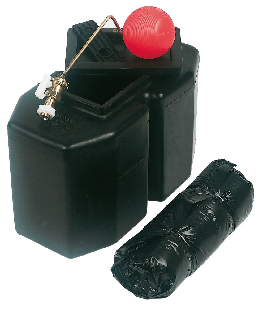

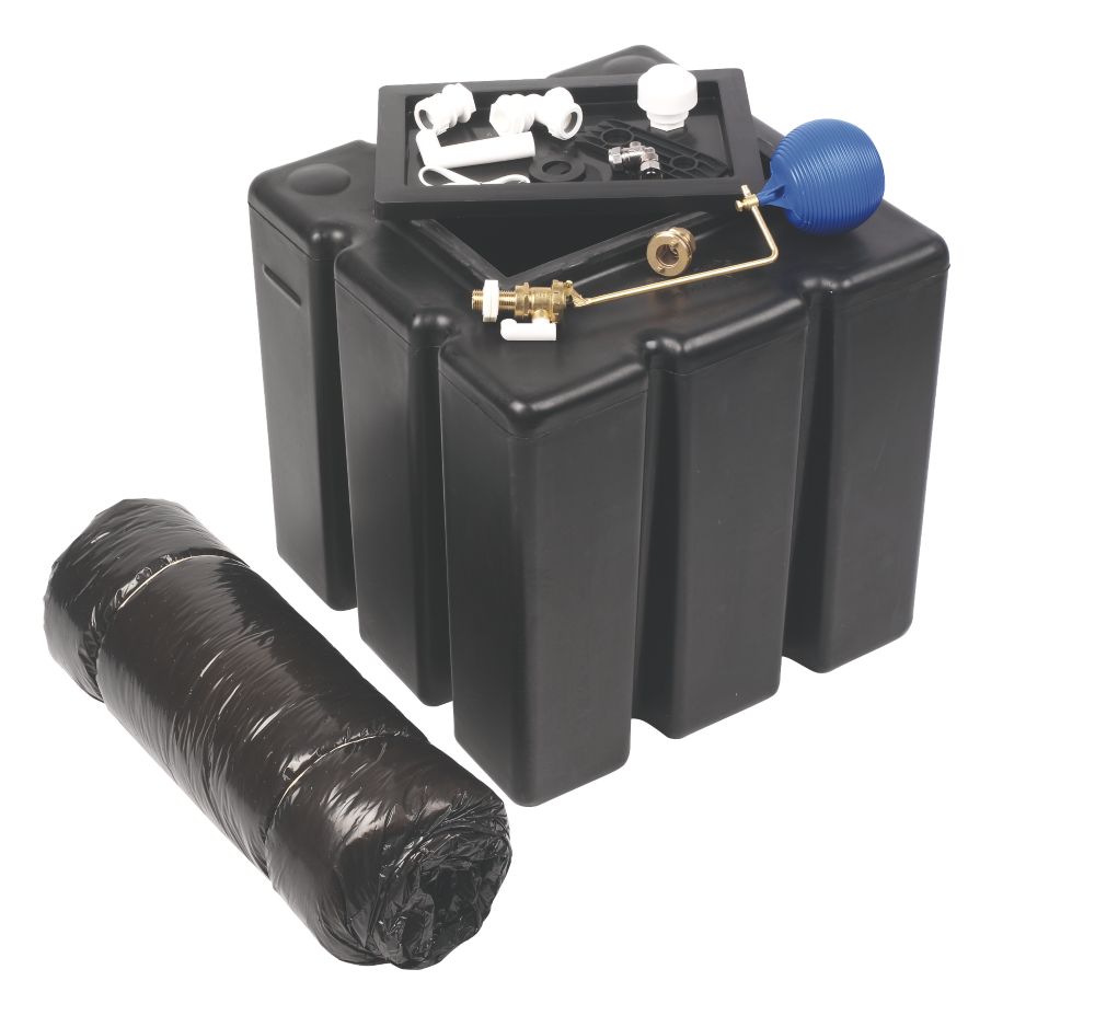

and a small feed and expansion tank
ae235

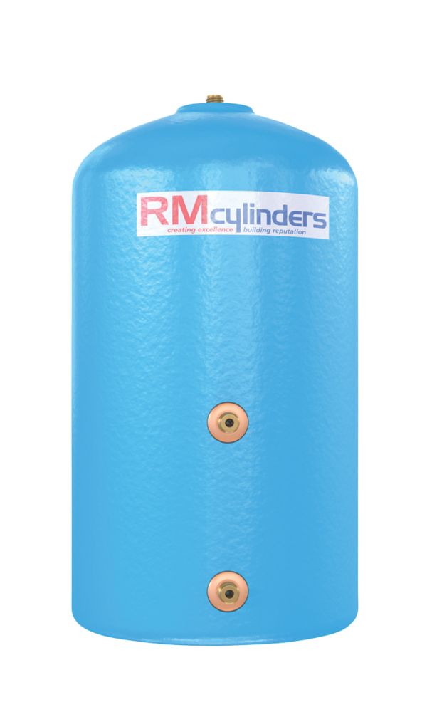

and a cylinder in the airing cupboard
ae235

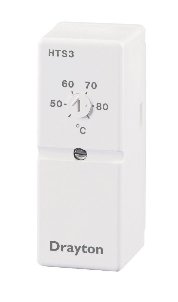

which has probably got a thermostat strapped to it
ae235

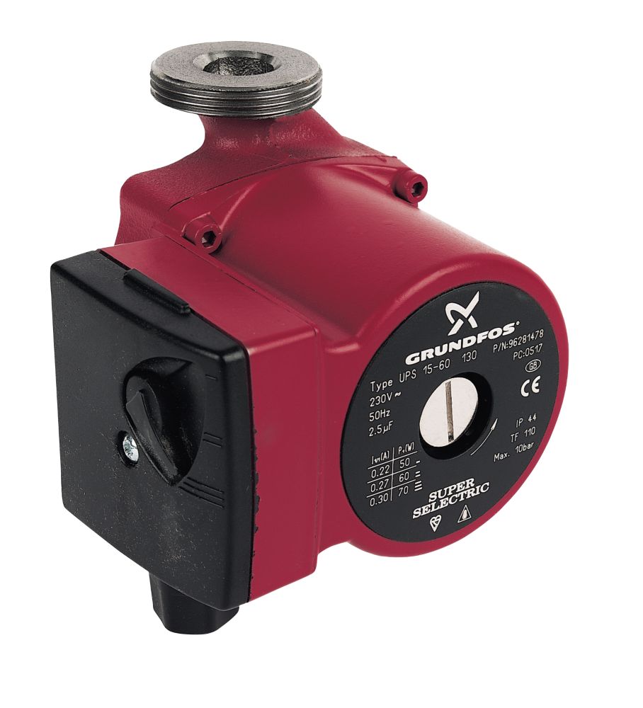

and you have probably got a pump
ae235

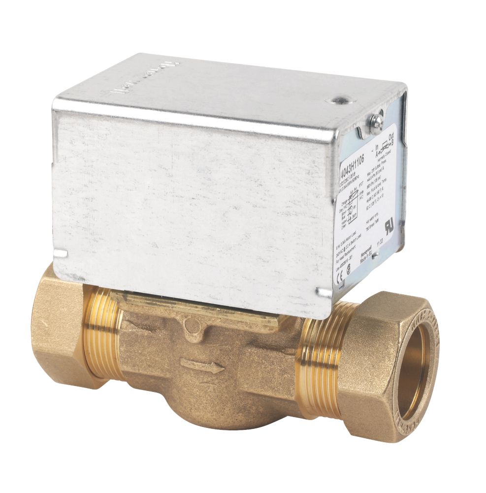

and a 3-port
ae235
or 2-port valve

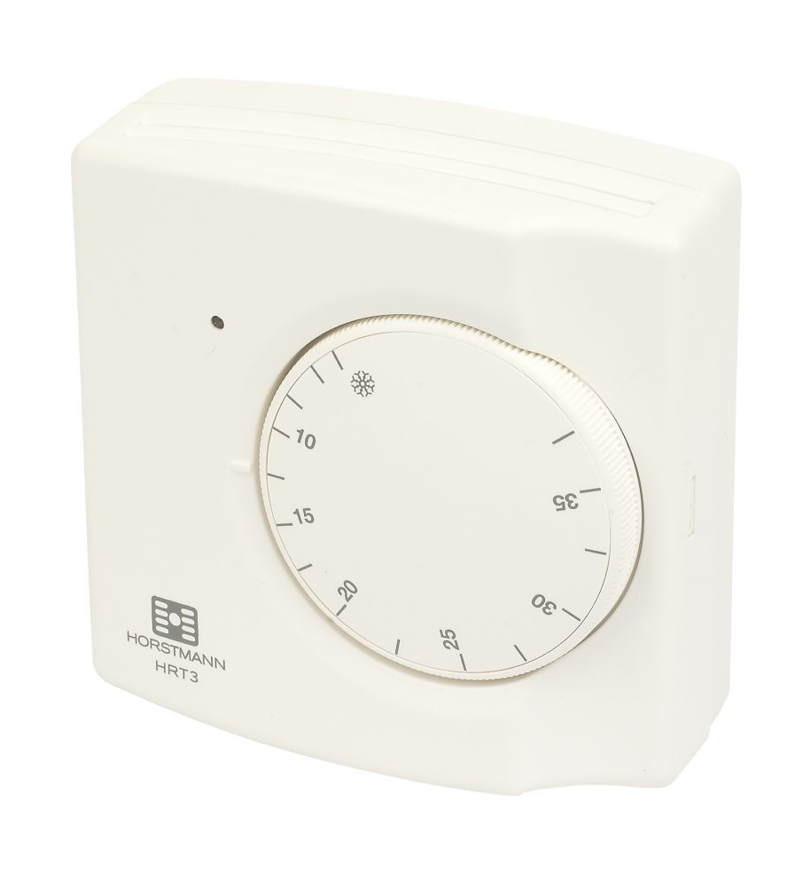

and a room thermoststat on the wall
ae235

the boiler provides hot water. The pump circulates it. The valve sends the water to the cylinder or to the radiators or to both, subject to calls from the thermostats.
If neither thermostat is calling for heat the boiler will not fire. If the timer or programmer is not set to either HW on or CH on, or both, it will not fire.

the motorised valve sends the heat to whichever needs it.
