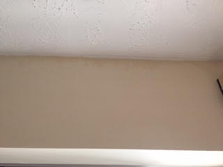

There's a patch of damp above my front door and I'm not sure who I should be contacting to get it looked at. Should I be speaking to a window fitter or plasterer or someone completely different? The door itself hasn't been changed in years.

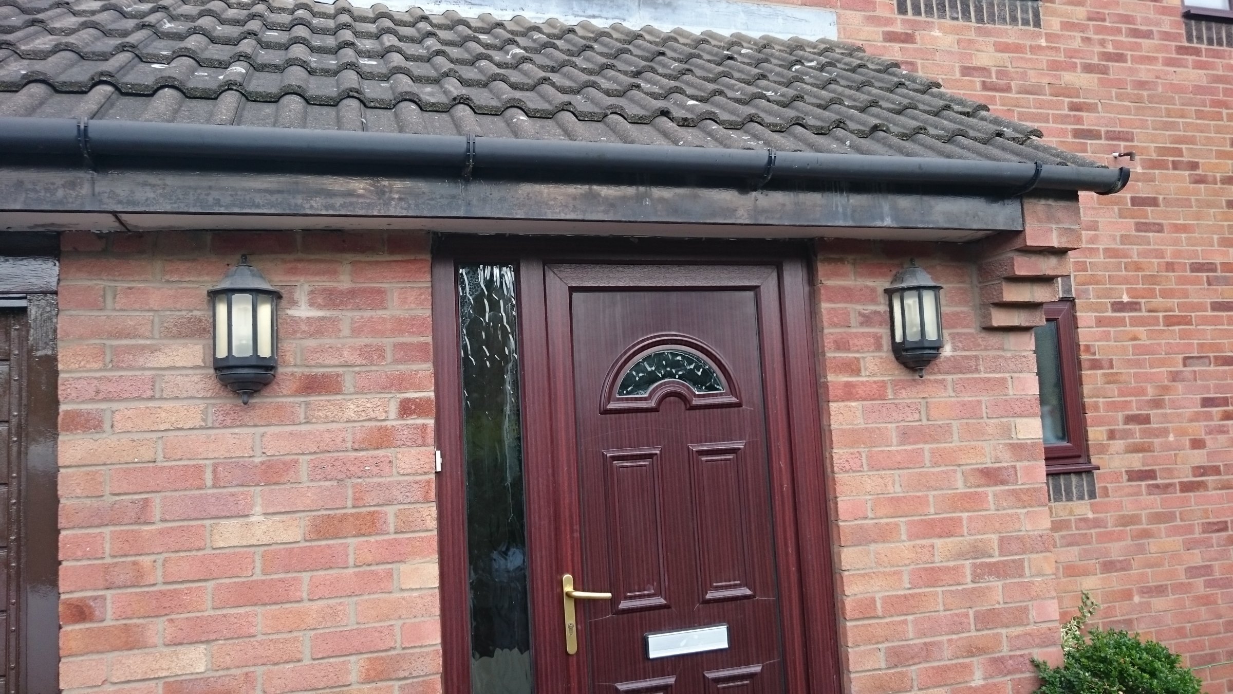

Post a picture of the damp and the outside of your house.
It could be a faulty guttering joint.

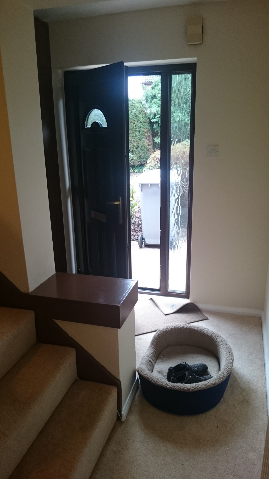

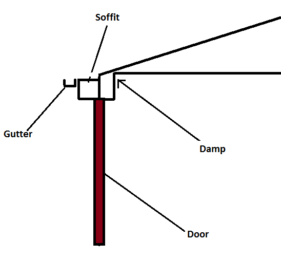

Thanks for the replies - I rent the house out so I've only got a picture of the damp inside (I'm 400 miles away), however I've done a very basic sketch of a cross section showing where it is, along with the best photos I can find of the inside and out.
I did have the soffits / facias / gutters done in the summer (the photo shows the old ones, but they're similar just square and brown), but the damp appears to be set back from the gutters as the door itself is in a recess. I do know that to fit the new bits they took off one or two lines of roof tiles. I don't really know about roof construction, but is there something below the tiles that they could have disturbed that's lead to this happening? If it was something to do with the gutters themselves I'd have thought the damp would have been at the top of the door?

the area of damp is a classic condensation area. probably you have bitumen felt 1f . have the fitters clad over soffit vents?..there isnt much else they could mess up...
