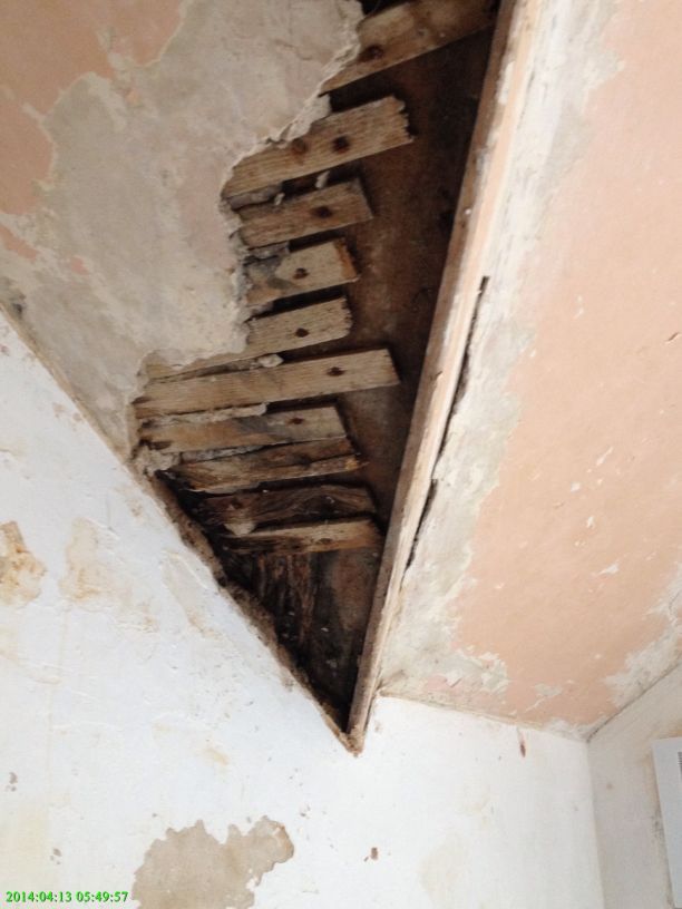

Not so much roof work but the wooden beams (or rather, pieces of wood until someone confirms they are 'beams') that are located between our bedroom ceiling & the roof.
The house had a leak before we bought it which has apparently been fixed. Roughly around where the red dot is on the fascia board here:

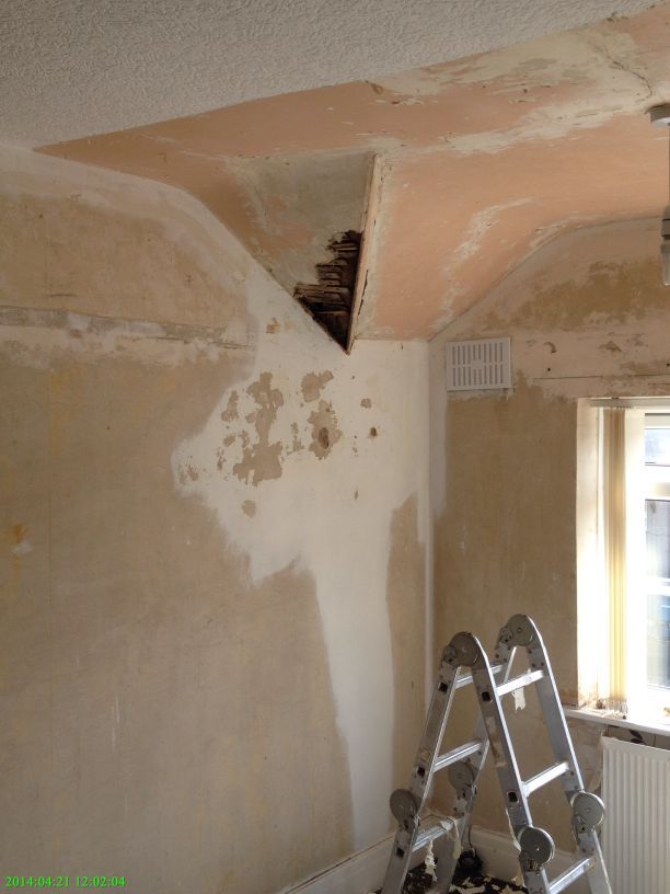

To cut a long story short, we had to whip off the ceiling paper. The ceiling is plaster & lath & the woodwork where the leak has been was sopping. You pressed it & water came out. It was quite soft. It has dried out massively since we removed the paper & some plaster but sections are still kinda soft.
The ceiling is a bit shaped where the valley is...
I had a look in the loft & there appears a 7x2/8x2/9x2 (can't tell & can't get close enough to measure) piece which may run from that corner of the room.
Only at the weekend did i see that this isn't THAT piece as it looks like some 4x3 (perhaps) cocked on its side with another bit running along side it. Perhaps this is supporting the 7/8/9x2 i wonder.

Two dormer lead valleys are converging onto a lead flat gutter that discharges through a chute into the hopper (& RWP) that you can see below the barge board meeting "V".
Usually, the dormer valleys and the flat lead gutter need stripping - perhaps more demolition will be needed depending on the extent of the wet rot spread. Others have discussed the roof(s).
But be cautious about removing anymore of the ceiling surfaces - you might bring down slates and debris. But more ceiling will have to be removed when work starts.
The meeting barge boards are probably damaged at their tails, if not further up?
When reinstating: the gutter must be to falls and the outlet must be into a short length of plastic guttering - the chute has to be eliminated.
The odds are that your neighbour has water damage too. Whatever, you will have to do the above as a joint task
After opening up, a careful search must be made at the party wall, down any cavities, and back into the adjoining lofts for any signs of dry rot - so far only wet rot can be seen.

It's tricky getting a view of the whole area because your close-ups are very close, and it's not clear what is what.
The rotted parts look as though they may be battens and the valley board, but you really need to see the state of the feet of the main structural timbers as well.
You cannot do this from inside the room. If you want the job doing once - and once only - you should be prepared for work above the roof.

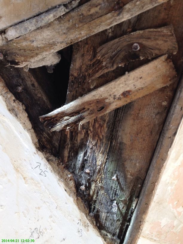

This is how it looks now:

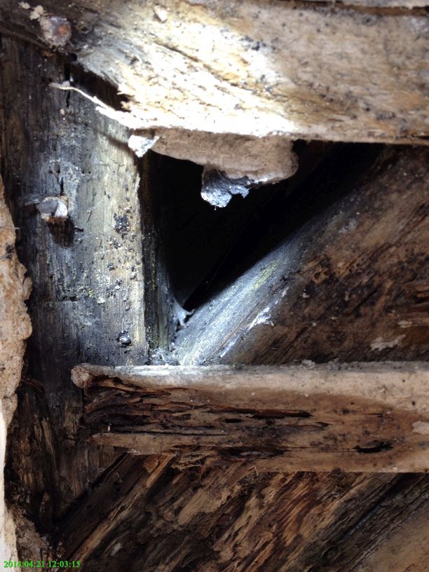

Anyway i got my screwdriver in between those slats that are nailed to beams to pull out the loose plaster.

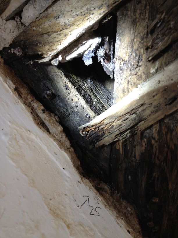

I'm far from an expert but the 'beam' that is 'sticking out' is about 4x3 or 4x4. It was damp where it meets the wall but it feels quite solid still. I can probe it with a screwdriver & it feels solid. I wonder if this could have the dry & wet rot treatment/hardener on it & it be 'good to go'.
Although i've a feeling that's where the good news ends. The smaller beam that runs down the length of the wall (it seems to actually be 'bedded in' to the wall) certainly feels worse. The timber feels much softer when i probe it with a screwdriver. I could possibly rip the whole thing apart it's that soft. There's certainly movement at the end.
This runs for a few inch from the end upwards.
And i'm suspecting because of that, what has been said is correct - roof off is requirement.
My concern then is HOW would someone repair this. The process. It's not just a piece of timber donked on top of another, whip off, whip on. Like i say, it's bedded into the wall.
As i look through those slats i can see daylight. I'm not talking a big gaping hole but daylight through the slate. I'm guessing this is normal as it'll need to breathe??
On top of these beams appears to be that 8x2/9x2 that i see in the loft.
So looking at the layout, i think where the triangle piece is on the front of the house, i suspect only the right hand side of that where the valley is - only those slates would need to come off & then somehow (i've no idea how) the timbers replaced.
