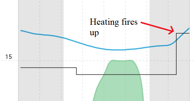

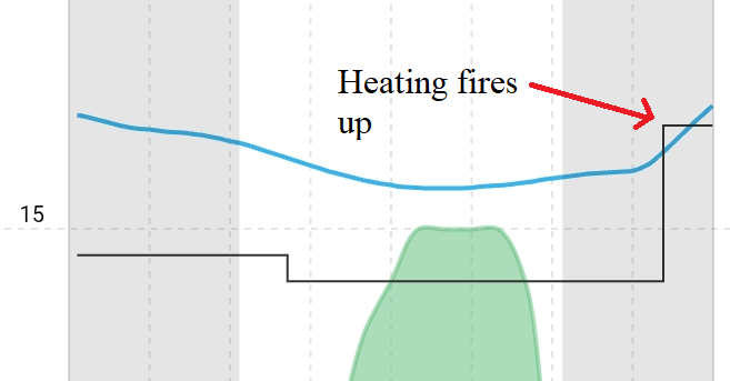

Since the TRV and wall thermostat are opposite sides of the room. And the wall thermostat is set higher, in the room, the TRV typically 6" from floor, and wall thermostat 4 foot from the floor, if set to same temperature, the wall thermostat will switch off before the TRV fully closes.
When fitted in odd shaped rooms, like where a staircase leads off the room, the TRV nearly always shows a lower temperature to the wall thermostat. This room now, wall thermostat 21.5°C, TRV at 90° to wall 21.7°C and opposite 20°C the one at 90° behind a chair, so set a degree higher to compensate.
It is so easy to see what the TRV and wall thermostat is set at, easy to compensate for furniture. With silly mechanical heads, the range between fully open and fully closed is around 4°C so a wall thermostat set at 20°C and a TRV set at around 3 is unlikely to cause a problem, and it does not take much to adjust.
But since I don't have a wall thermostat at a single temperature, but it varies through the day, can't really use a TRV head which also does not vary through the day. So a mechanical TRV head for me is a non-starter.
The hall also TRV and wall thermostat, not ideal, as on the same wall, and wall thermostat closer to the centre of the house, so now they show TRV 15°C and wall thermostat 19°C. I only expect the wall thermostat to activate when some alternative heating warms up the living room, but again so easy to see what they show, and to adjust with any off-set required.
Third TRV of interest is wife's bedroom. Current 15°C set to trigger boiler at 14°C. Due to furniture and clothes, although this should have been the easy one, with same device running boiler and controlling room, heat does enter her room from the landing, but it again is so easy to monitor what is going on, not a problem.
The shower room, kitchen, office, craft room, and my bedroom, are harder, as the TRV heads don't tell me what the room temperature is, they are not as easy to monitor, but I don't have any eQ-3 TRV heads in same room as a wall thermostat. It would require a thermometer to monitor the rooms. I know my room at 18.1°C, living room 21.3°C the utility room with no heating at 13.4°C and the flat under main house at 16.8°C. Again so easy to move the monitors around, easy enough to set when required.
May as well finish it off, dinning room showing 15°C. Without leaving my chair, it is so easy to see temperatures around the house, can't see a problem setting TRV heads and wall thermostats to control the house, if I hear the boiler running when I don't expect it to run, I will quickly have a look why.
