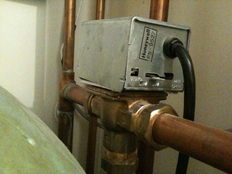

Why are the radiators hot when the centrel heating is off?!
Check port B is to the cylinder and port A is to the heating.
Well, the lever isn't hooked over, best to get your Plumber out now, unless you feel confident replacing it???
Please tell me that the pipe on the left of your pic has an air vent on it and doesn't feed a few rads in a loft conversion, otherwise i will be Doitall's forum slave forever :LOL:
I think it does - it goes up about a foot with a little cap on the top!
Simon,
Did you say in a previous post that the valve wes re-newed last year? Is so, it aint half aged.
Paul
It would be nice to have a bigger pic with more details innit.
