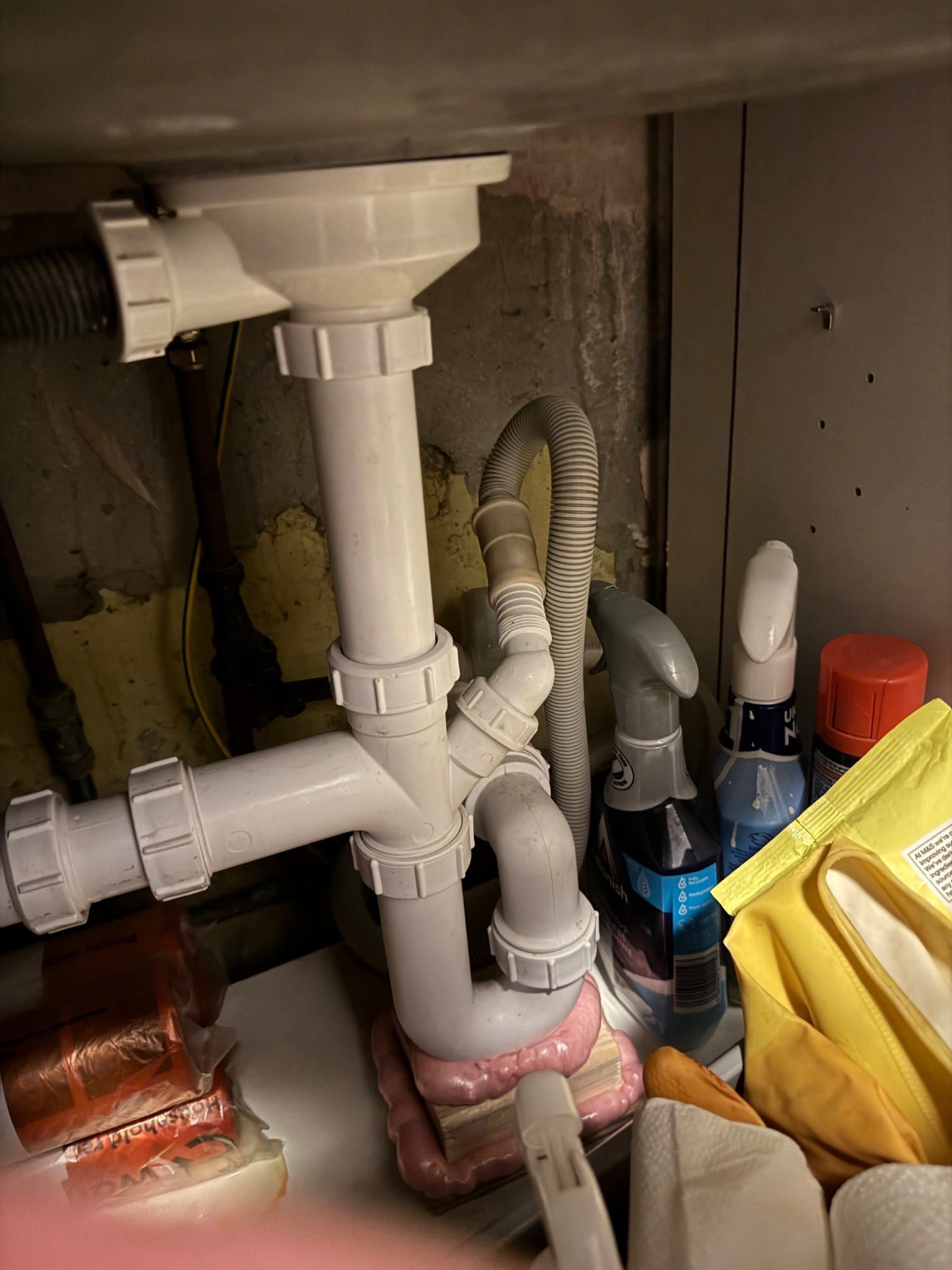

Why does my kitchen waste keep blocking?
It frees up with a quick plunge but I find I need to do at least once a week.
If your wondering, it is propped on some wood blocks as it came loose and was leaking a while back.

Probably due to the waste pipe being clogged up and it doesn't take much for it to block. Fill the sink with boiling water and soap and let it go, do that a few times.
Alternatively get the pipework apart and inspect/clean out.
Do you use it like a waste disposal and flush food down it?
Do you do a lot of greasy cooking .?
Both clog sinks quickly , hot soapy water helps keep pipes clear .
After making tea I always empty the kettle down the sink , not only helps keep sink clear reduces scale in kettle to practically none .

OP,
You dont show the whole of the unit plumbing but in terms of what you show:
Say I'd been sent for on a service call - first thing I would do would be to drop the basket waste, & strip & clean the pipework & compression fittings - I'd use new friction rings & new tapered rubber washers when re-assembling.
Correctly installed sink plumbing typically has no need for supporting blocks.
The waste hose needs to be pushed all the way over the spigot ribs, & secured with a jubilee clip. The waste hose should have entered the unit at high level just below the work top.
