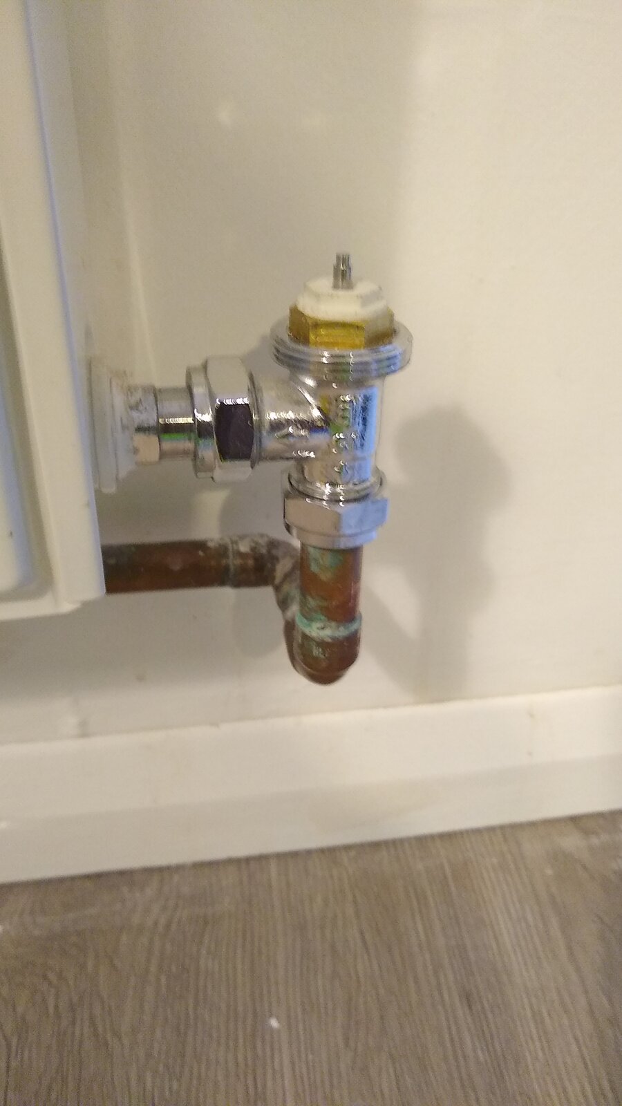

New boiler was installed about 6 months.
Following installation, the boiler has been mainly switched off due to renovation etc
During the renovation all the rads were removed. Then refitted and inhibitor added to system
All the rads upstairs work, but the single one downstairs does not
I've bled the system, shut off the upstairs rads (lockshield and trvs) to force heat downstairs. Still nothing.
What else could it be? The pump?
If it helps, my boiler is outside

If the downstairs one is fed by dropped pipes from above, radiator could be airlocked. If so, there should be bleed points on each of flow and return drops, use these to get rid of the air.
Have you shut off lock shield and opened TRV and bleed then open lock shield and close TRV and bleed so both supply and return both bleed?
Tried this and had no joy unfortunately

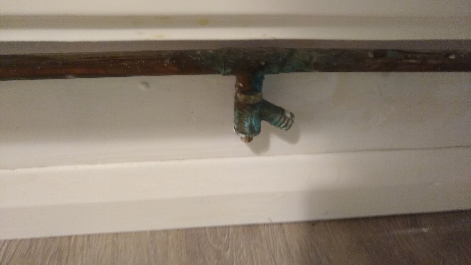

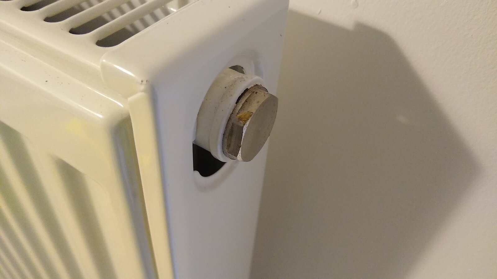

My radiator has a bleed valve on one end and a plug on the other end
However, to try amd remove air i followed this guys video and the rad is still not working

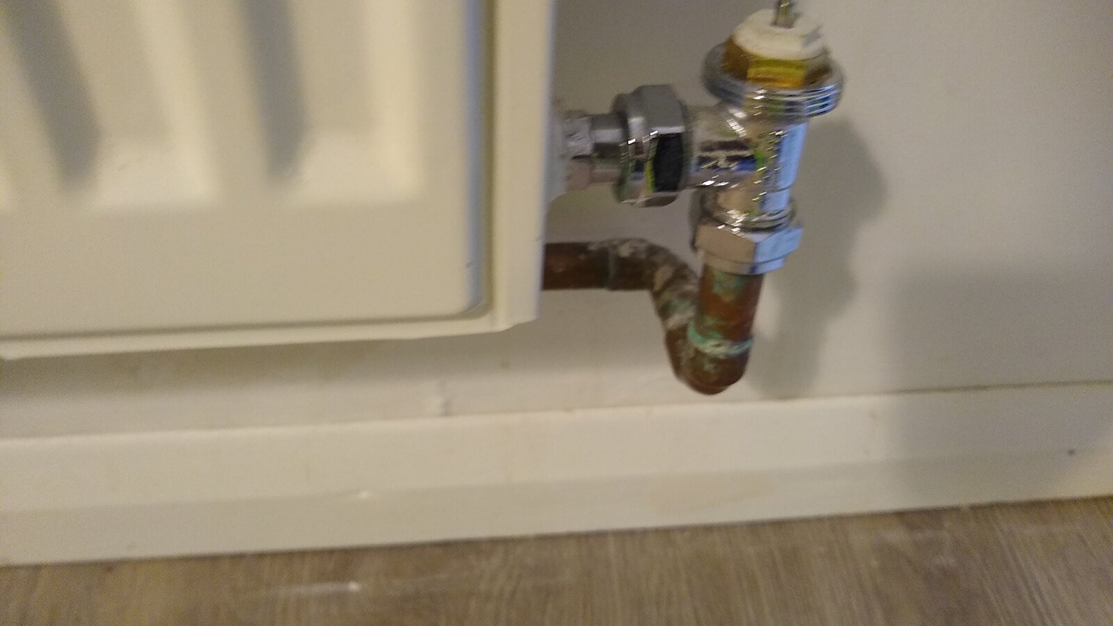

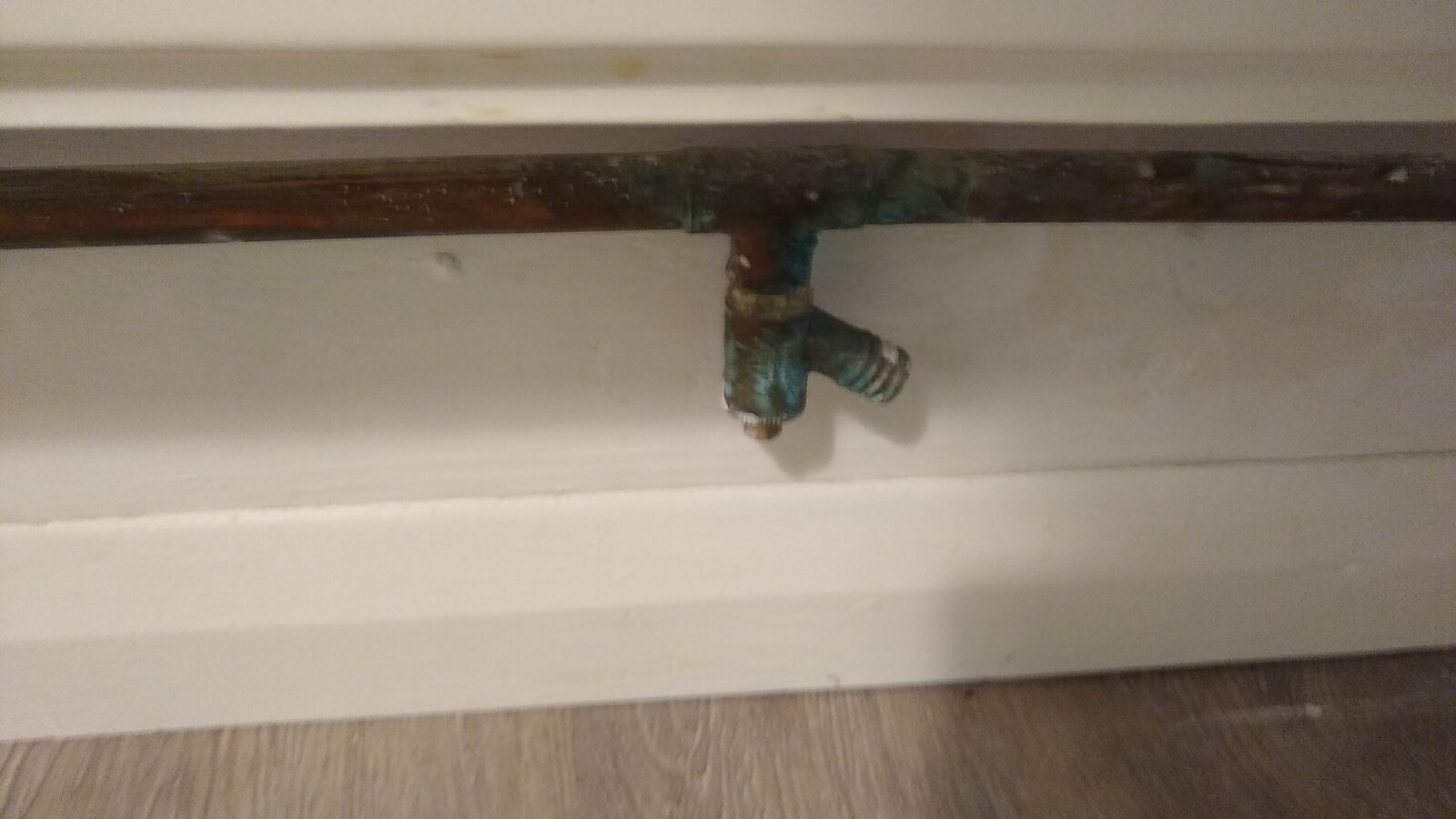

I then drained down the system and one pipe got warm but the other is ice cold.
Does anyone have any suggestions?

That’s an erp pump, don’t think you can get to those screws. X2 flow pipes or return pipes plumbed in by accident?
Does the problem rad have a thermostatic radiator valve ( TRV) ?
It may be stuck closed.
I don't think that it is that

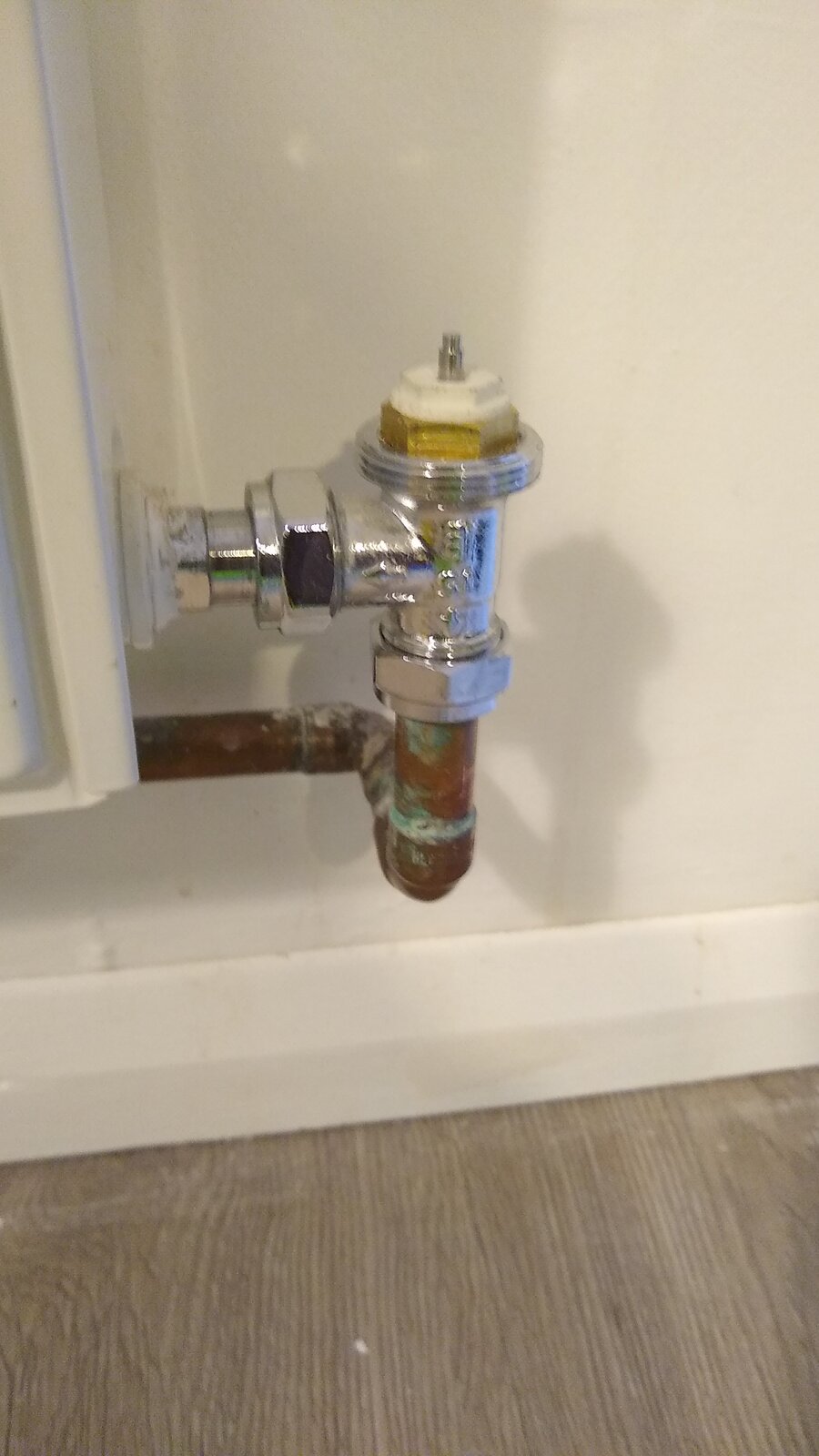

As the trv is new. I removed the head to make sure that it is not stuck

I see in pics that you do have a TRV ,press down on the pin to see if it moves freely up and down.
