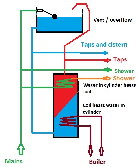

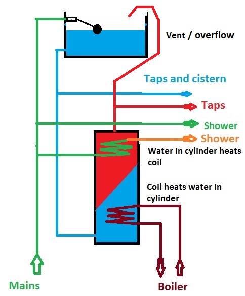

My sister lives in London and i was sure her cistern must be blocked as it was so slow till i realised the bathroom supply was tank fed. Is that just lazyness/cost saving of not wanting to reroute the plumbing? Why in this day and age would anyone not want mains pressure when it's everywhere?
Tank feed to bathroom taps is standard in all houses in the UK apart from those built pretty recently.

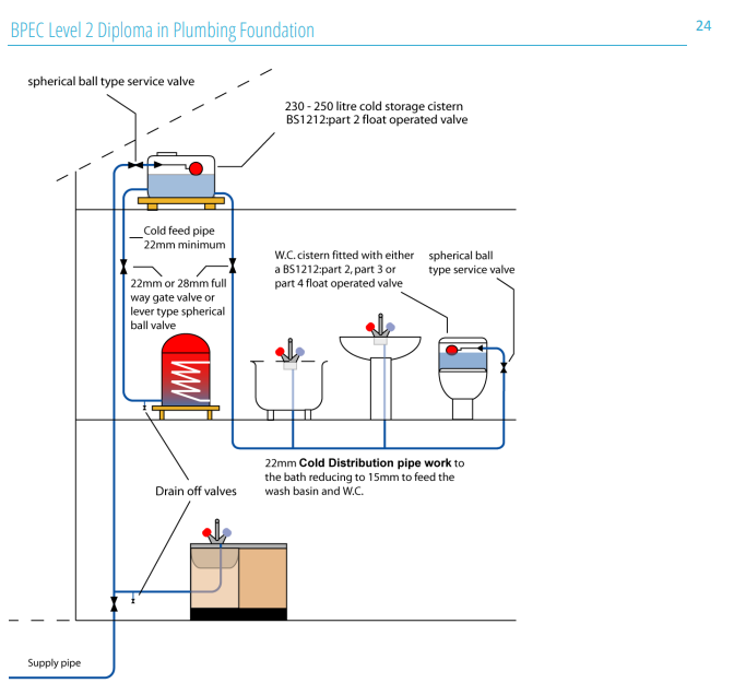

Indirect water supplies are still common and are, in fact, still taught today.
very common, if water supply is shut for some reason the bog can still be flushed, with the move to combi boilers this has been done away with , but was the norm back in the day
Plus if cold water is tanked you don't get a neighborhood flow drop when everyone is using water at the same time. Supplier can run distribution network at a lower pressure which has advantages for them.
I live in West London. We lose the water supply 2 or 3 times a year (although it seems to be getting better). With a tank based system we can still wash, make tea and cook so long as the tank supplied water is boiled first. The only thing a higher pressure is needed for is a shower, and a pump takes care of that.
