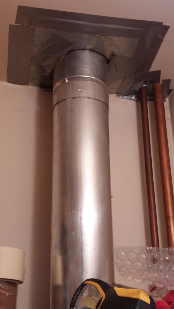

Thanks all. It looks like a Slimline RS55 although can't say 100%. The flue goes directly to ceiling then vented out of the roof.
Yeah I get the fact the vents aren't there in case of leaks, however I quite like them being there in case there was a leak, specifically the one on the floor that leads to the airy crawl space.
If you post a pic of the boiler and the front controls and the visible flue if possible.
I'm not going to take the panel off cause knowing my luck the boiler will shut down! Anyways, here's some pics. Ignore the tape around the flue entry into loft. I did that years back to stop wasps.

Thats a mexico cf
rs donates room sealed .
Your boiler is classed at Risk because of the ventilation configuration and they should advise you not to use it and turn it off with your permission .

close the floor vent ,
to make it legal vent sizes on page 3 then a vent in your hall to outside
