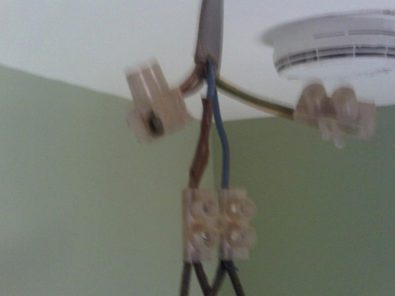

do you see on the photo where everything is taped up for safety - the two brown are already in a plastic box.... is that ok then to leave them like that - then wire the rest in as i should.....?
Im sure i already tried it that way but maybe not - i got too confused. I think by wiring in ALL the brown was how i got it to come on but never turn off,
Yes the connector on the brown cables is okay.
It will as you have made the light permanently live by doing that, therefore cancelling out the function of the switch
You need a separate 5 amp connection block for the two red cores,
where do i get the 5amp connection box from
You could remove and use the one from the earths in picture one, as the earths will go on the block provided with the new light that then pushes on the metal tab of the fitting

why? Can't see the other light was it connected to two lamps? Must admit the core colours look alike but the lamp don't know that!
Just out of interest what distance is there between the new fitting and your smoke detector, it's hard to tell by the photo but the should be at least 300mm between them.

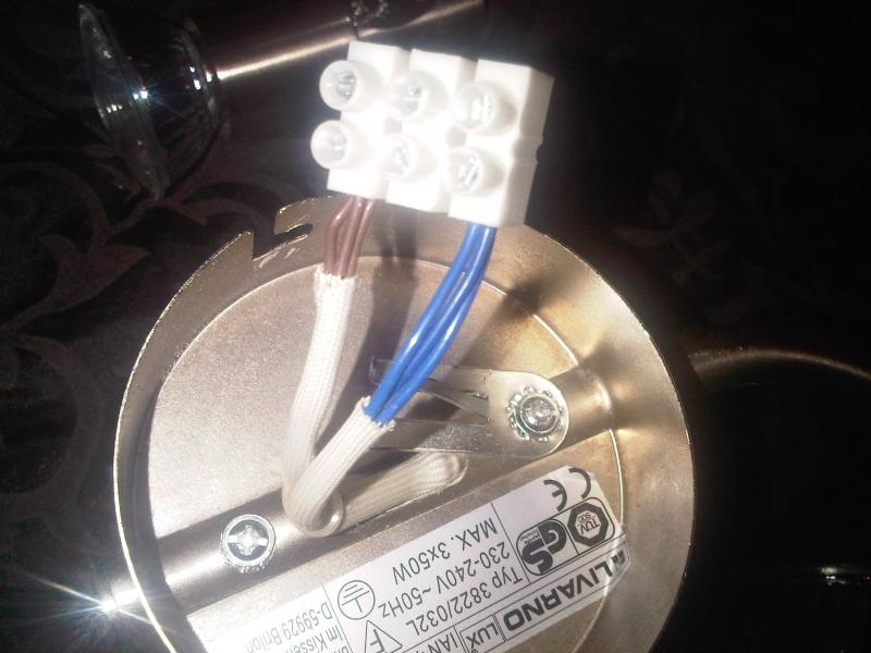

2. The earth is a metal strip in the light fitment.... it is physically impossible to attach it to the earth hole in the plastic box.... you just cant do it and fit all the wires in the space available.

As regards to the earth terminal, one end should fit over the earth strip. Don't put too much of the strip in, as there won't be any space in the other end ofd the terminal for the earth wires to fit.

Still can't get the metal earth strip in. There's just too many wires to squeeze in. What's the consequences of not doing it I'm worried!

Can't you get the metal strip on it's own?
Put the wires in a bigger block and use a short peice of earth wire from that to the second block that pushes on to the metal tab
