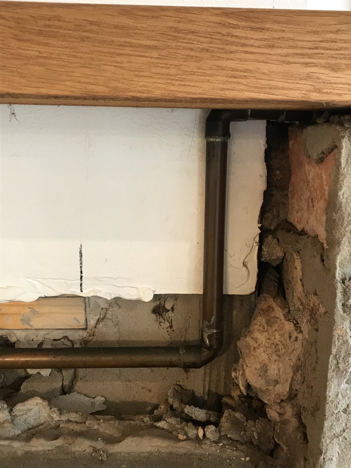

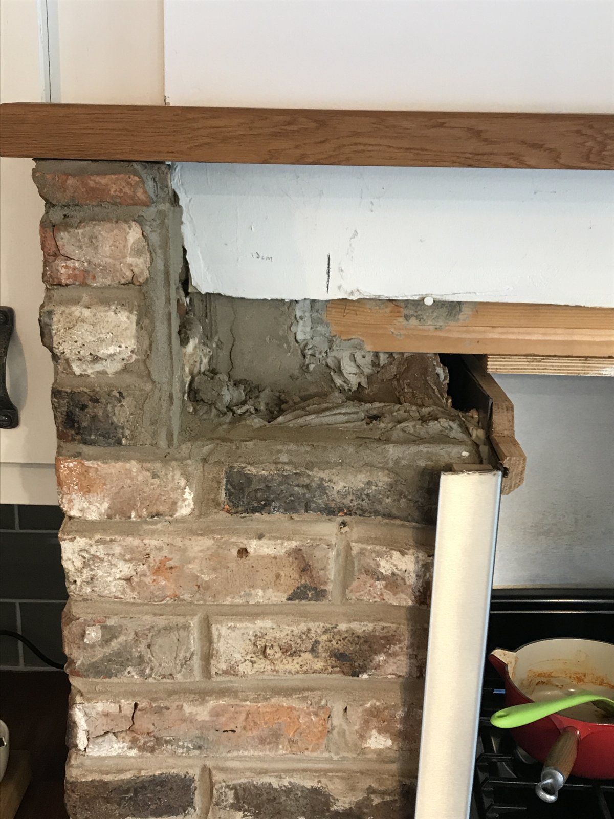

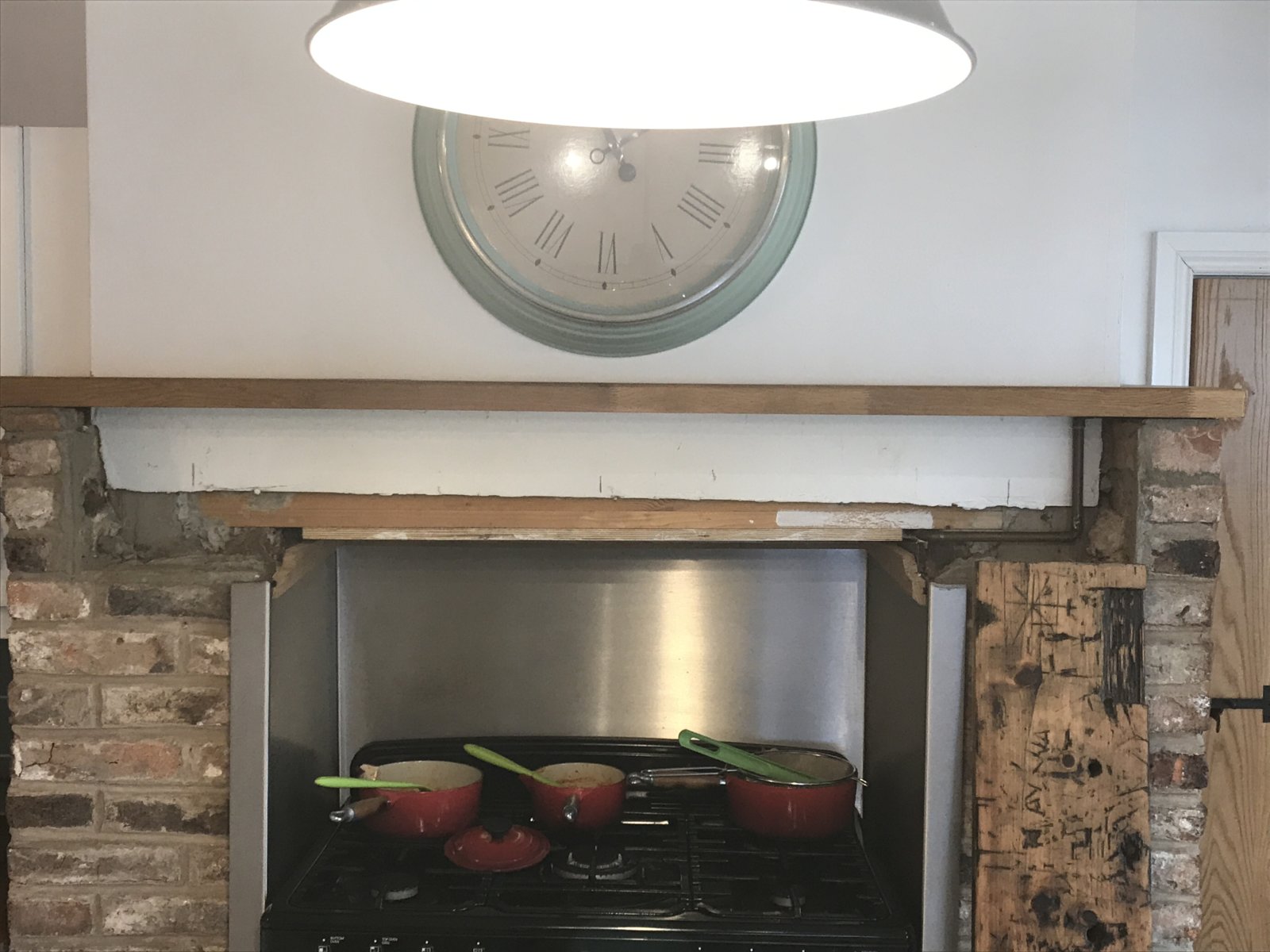

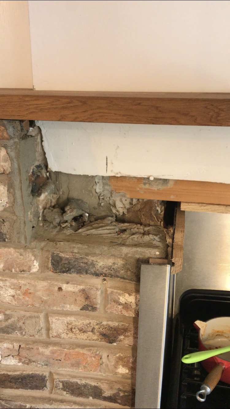

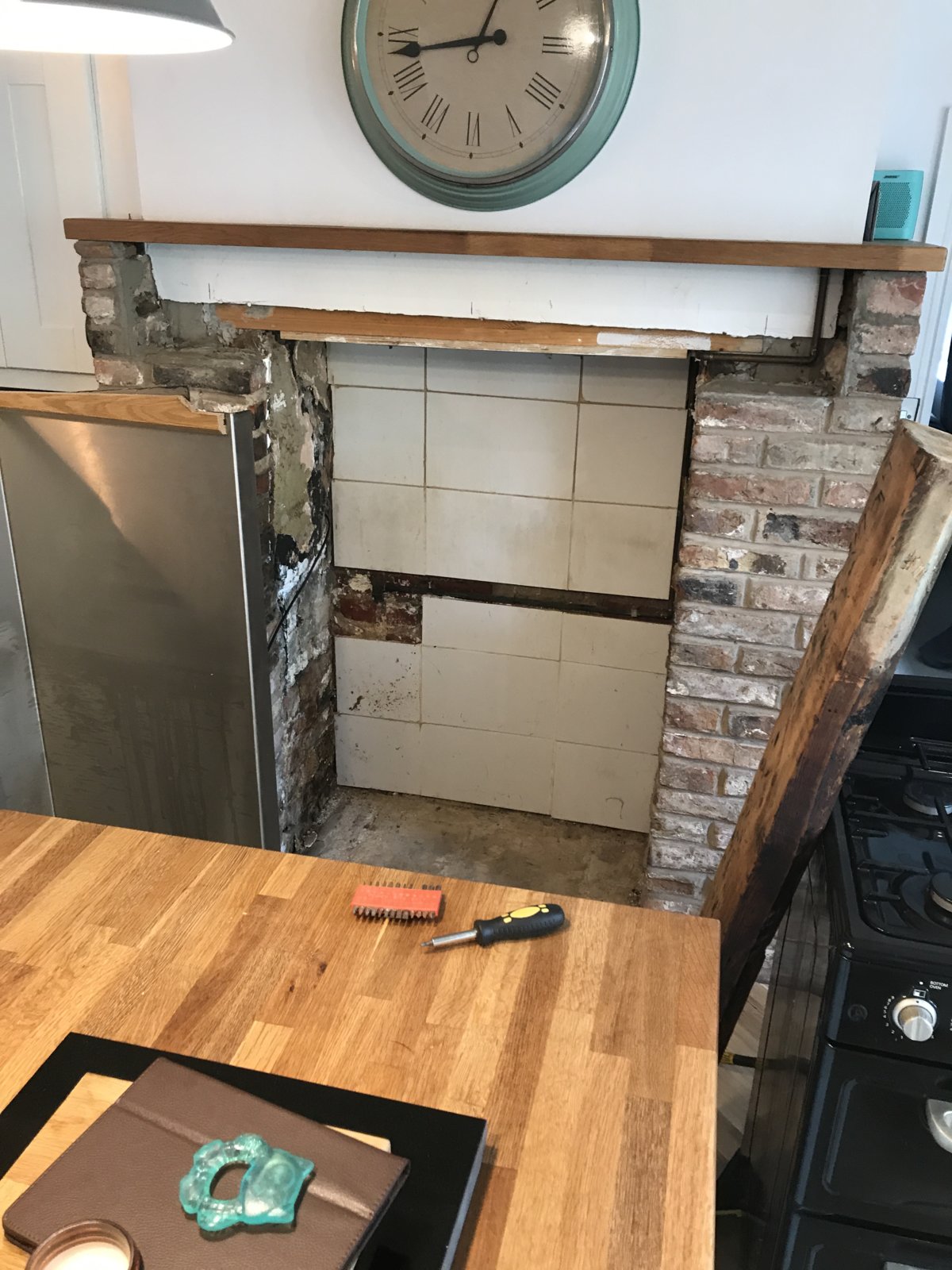

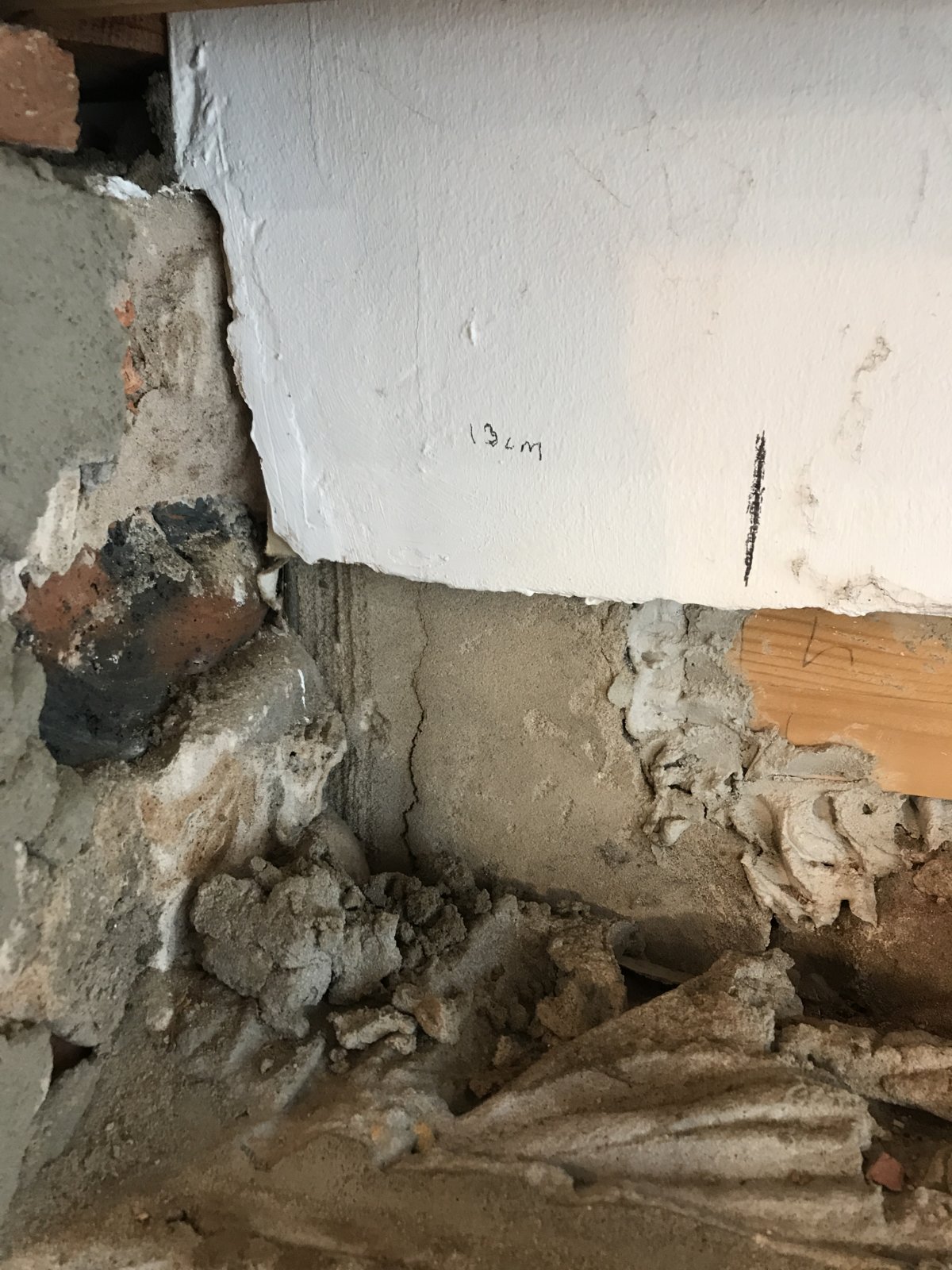

You want to get a few pics posted before doing anything else.
Here are some to start...
The brick work you can see is purely decorative on the front.

What you show looks to be potentially shaky - but then i'm not on site.
My rough calculation using a 1090mmW Everhot 110 dont work out for you.
I'd need the total width of the chimney breast to be accurate?
Its difficult to tell from the pics if you still have the old lintel installed - i cant see one?
I guess that your familiar with the Regs dimensions for what you are doing?

Thank you for getting back to me. Of course; the overall width is 1550mm, but I do know the plaster board I am taking the measurement from is dot and dab so that is adding some to this.
im going to chase out some of the plaster to see if I can find a lintel. There is a small wooden one by the look of it, you can just see it in the picture. But it’s not very thick maybe 60mm.
We’ve only been here 6 years so I don’t know much of the history of previous work. I know in the 80s the two Cottages were put as one house.

op. from the pics, there seems to be only a single skin of facing on the left side as it doesnt return, so behind there will be some mighty stones, which your not going to be able to remove set amounts off. it’s a whole stone or nothing really.
I don’t see it happening, unless you can get the whole amount from the right side , which will leave it not central.

Measuring from the D&D is useless - the face of the original fireplace, brick corner to brick corner is needed.
Perhaps you can measure a comparison in the bedroom above - thats if the c/breast Keeps it shape?
Have you considered stripping everything off to reveal the original c/breast?
Its all very well putting in steel but what will be supporting the steel, cannot at present, be seen?
