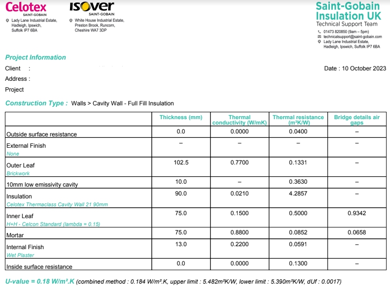

With the 2023 building regulations changes it looks like the external wall width (from exterior brick to finished plastered internal wall) for a new extension would be:
102.5mm - exterior bricks
150mm - cavity for standard insulation (unless using some higher performance / more expensive insulation)
102.5mm - blocks
10mm - dot and dab adhesive
12.5mm - plasterboard
3mm - skim plaster
= 380.5mm
Does that sound right?
Thank you.
On an incredibly tight site I've just specified an external wall of 290mm (U Value 0.18), 75mm inner skin mind + wet plaster.
