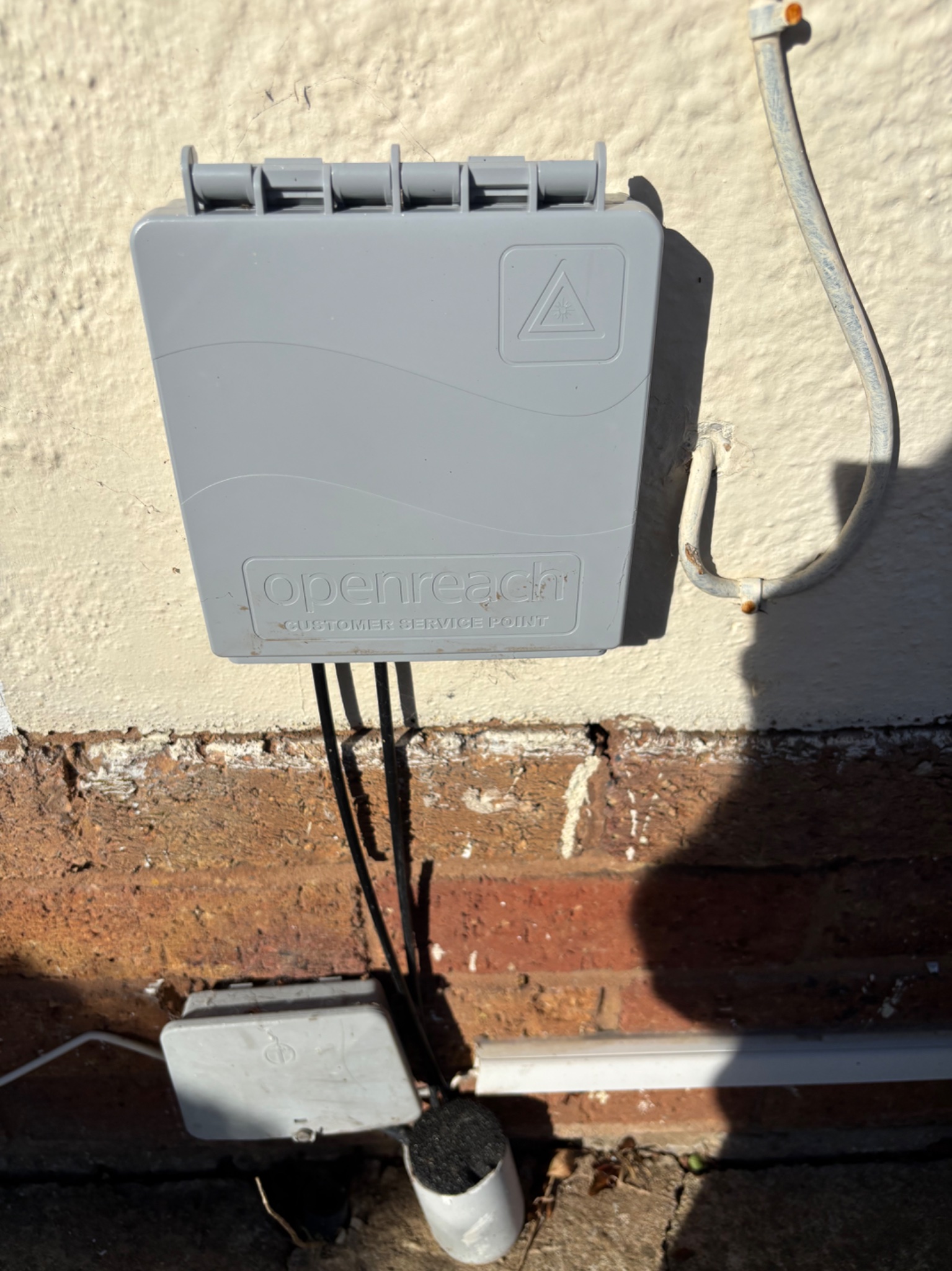

We’re with TalkTalk, for our sins, and we had full fibre 900 installed in May 2024. The coverage in and around our semi detached bungalow is excellent, or rather WAS excellent till Openreach turned up the other day and did something to our external box. I didn’t ask the engineer what he was doing but really wish that I had done, because from having excellent coverage both inside and outside the property our external coverage is now almost non existent, and it’s definitely happened since Openreach were here. I went through the laborious process of contacting TT ( because service provider is first port of call with WiFi problems) but all they could do was run diagnostics and tell me it’s a router fault and send a replacement, which has made no difference.
The only clue I have as to what Openreach have done is that there are now two cables entering the exterior box when prior their recent visit there was just one ( see attached pic). You can’t contact Openreach direct so I’ll have to go back to TT and ask them to escalate.
But meantime, does anyone have any clue what Openreach might have done to mess up our coverage?

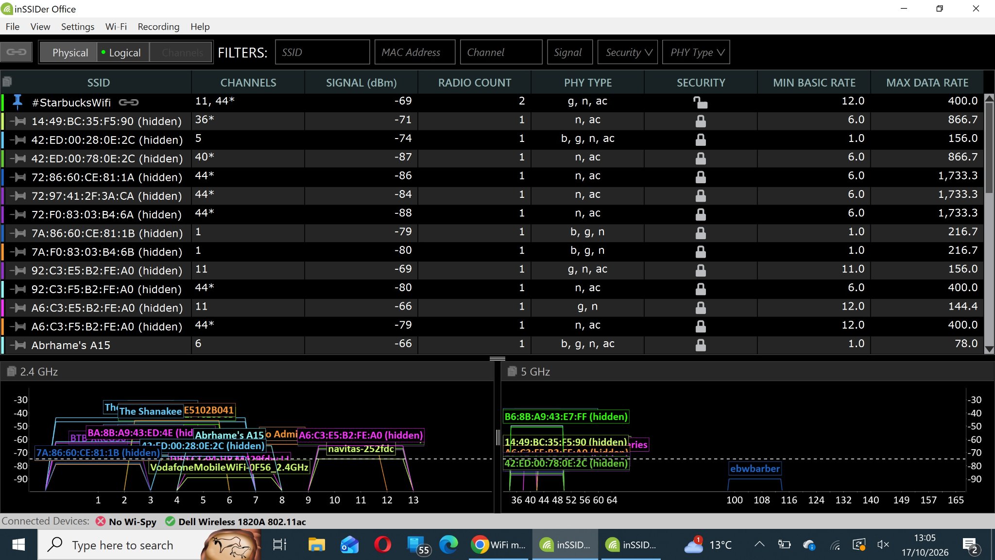

The only thing I can think of is that your neighbour now has wifi and is possibly on the same channel number. Download a wifi scanner and it will show which channels your neighbours use. Then change your channel accordingly.
Have they maybe piggybacked out of your box to a neighnour? Worth asking your other half.
That occurred to me too, but there's no new wiring which visibly enters our adjoining neighbour's property. However, its certainly possible that they've taken that second cable underground to another customer, although I did read somewhere the type of cable used should be able to supply multiple properties without anyone losing coverage.

As far as I can tell from a visual inspection, they've made no changes to our neighbour's phone/ internet line. If you look at the photo that I posted, the small grey box underneath the larger one belongs to our neighbour and the cable beneath that smaller box goes underground via a different route. I suppose they could have joined them underground. But I'll investigate that "channel changing" option, thanks.

Check what channels he is using. In the UK, on the 2.4ghz you can select channels 1-13. 1, 6 and 9 are considered non-overlapping.
My favourite Windows scanner is Inssider (the free version is available from MetaGeek)
Edit- and if none of your products use the old B standard- disable that in the router settings.
