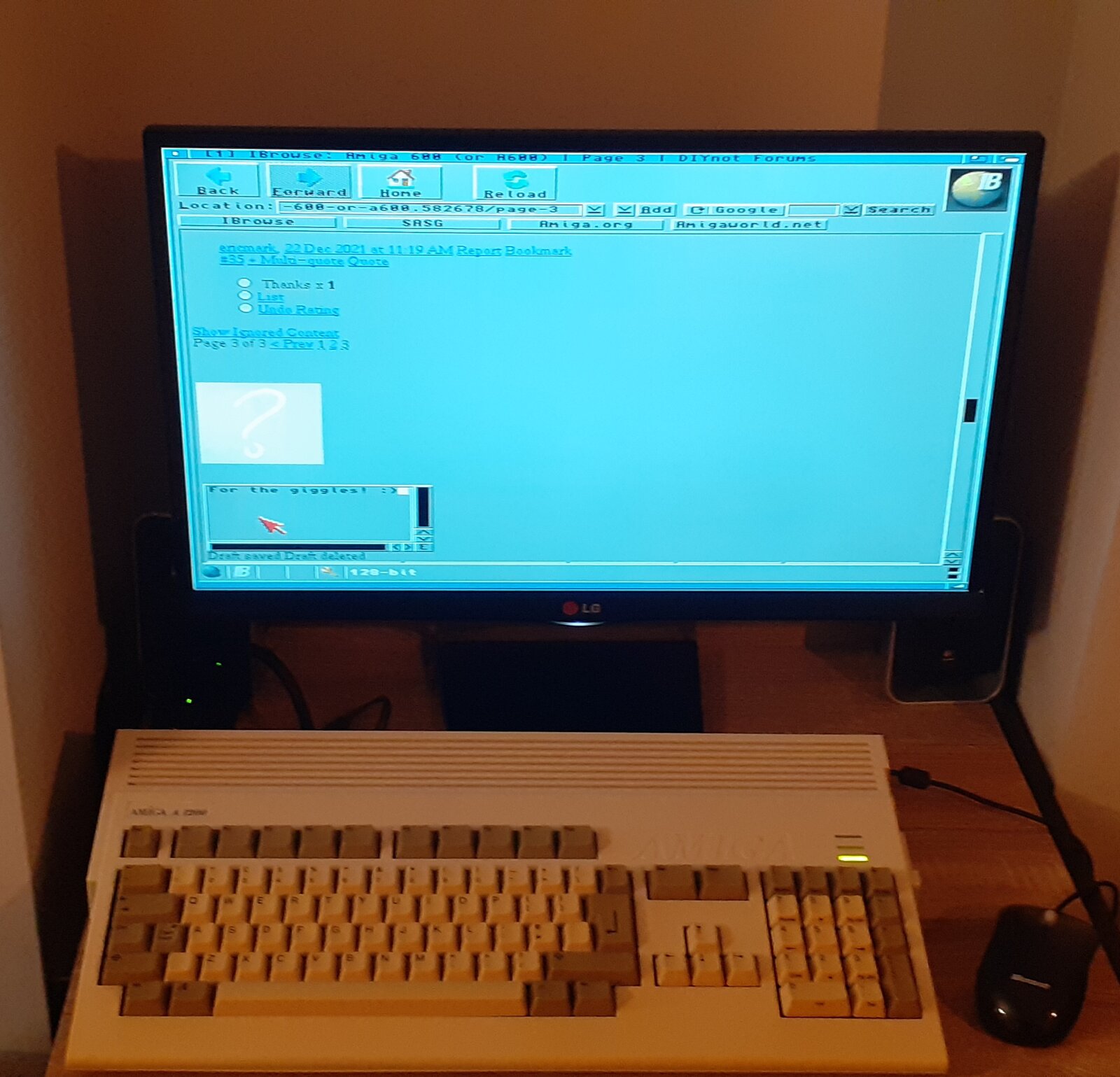

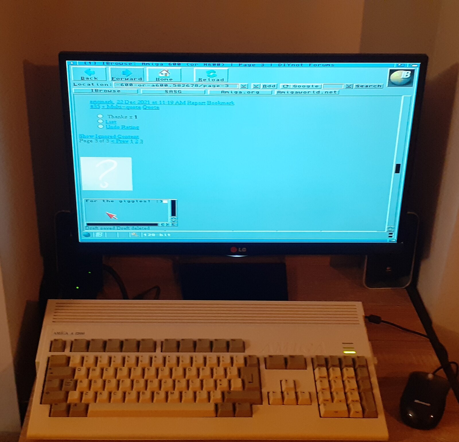

I'm still using my 90's computer, and yes it does use wi-fi and everything! ;)
Nice, doesn't look like a laptop though... did it come with wifi from the factory? Must have cost a fortune. I remember replacing the CD-ROM drive on my packard bell AMD dx2-66 thing and it cost about £400 for a 2x!
