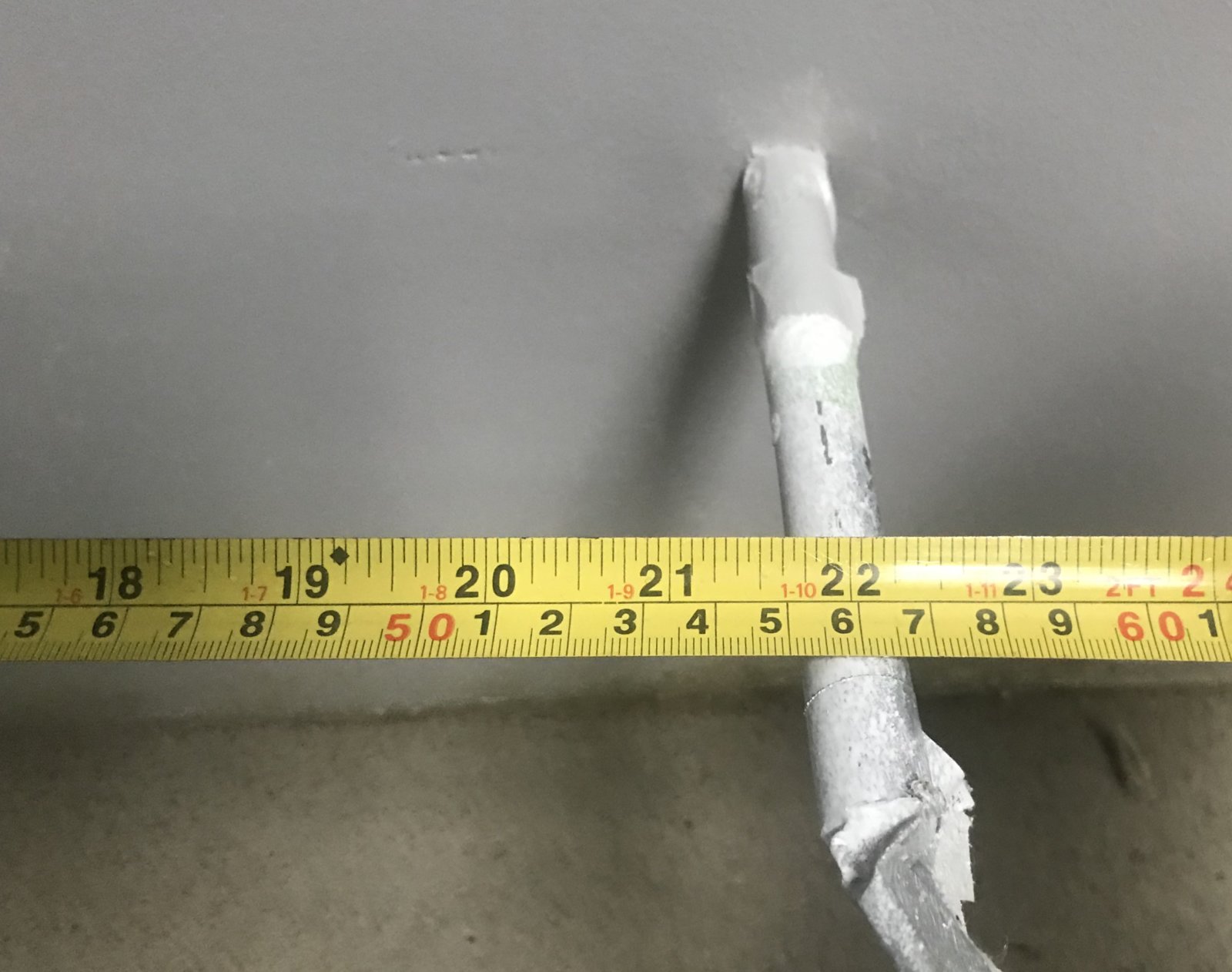

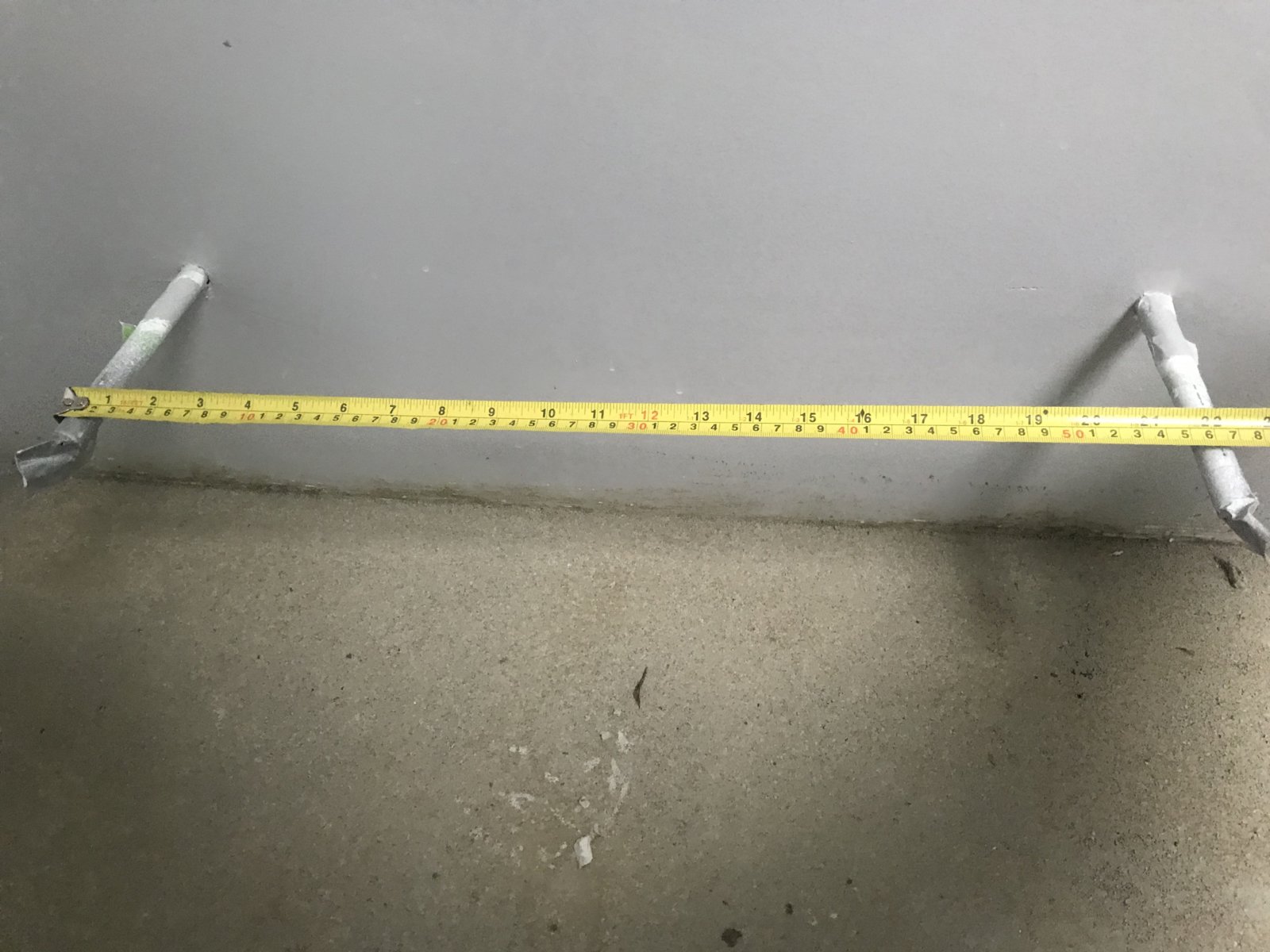

As above guys will 550mm pipe centers accommodate a 500wide towel rail? I'm not sure if the valves allow for the extra?
Just spotted one for sale locally but am unsure.

Nope, a towel rail is usually measure from edge to edge, so a 500mm wide towel rail will usually have pipe centres of around 450-470mm ish, if your pipe centres are 550mm, then even they will need to be 'nudged' in to fit a 550mm wide rad.
How far will be determined by the width of the rad pipe and whether straight /curved/designer etc
Perfect many thanks for the help mate! Appreciated
