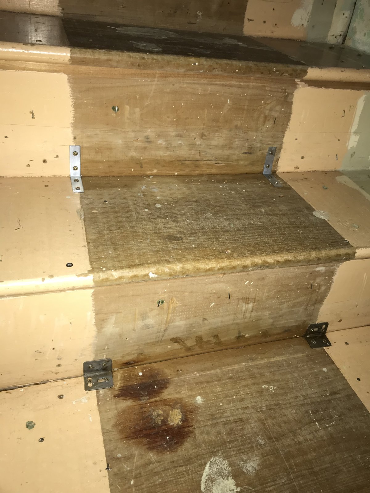

Will a carpet fitter be ok with this?

I’m kinda hoping the gripper can be fitted around the brackets or even bent over em, or do I need to rebate them in? Cheers!

You would be better off securing the stairs from underneath. But this would involve a lot more work if the stairs are boarded.
Andy
Agree Andy but can’t get to it until a wall gets knocked down in the future, so the stairs are good now but hence the question about the carpet
Would take a bit more labour cutting to length and fixing enough, but less than the effort of rebating the brackets.
Offer to cut the grippers to size in advance?;)
