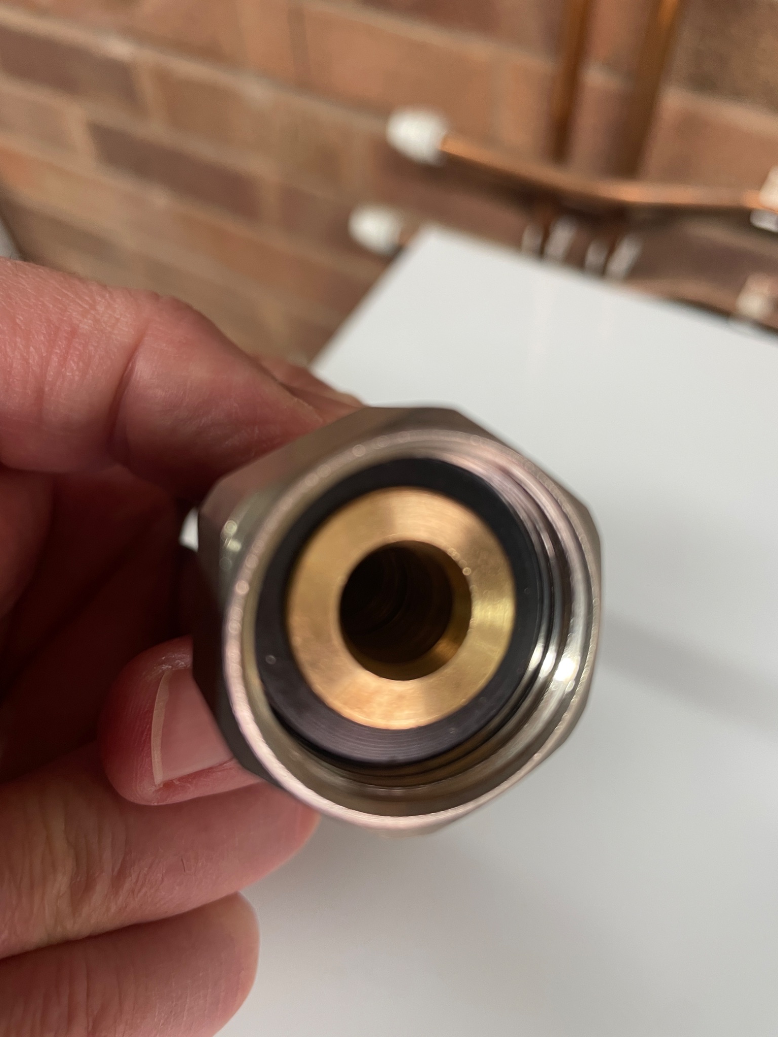

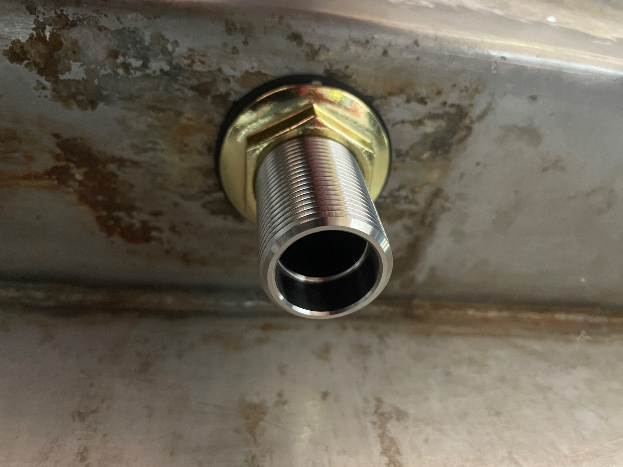

I’ve recently purchased these deck taps from Toolstation
Quality looks really good however I’m a little nervous around whether the braided Flexi pipes that I’ve purchased which has a rubber seal, will it seal correctly to the bottom of the thread as it looks like there may be a very slight chamfer

If you are talking about connecting to iso valves then buy a flat top valve.You could also add a fibre washer into the nut if you are worried about the rubber washer.
1. If you are talking about connecting to the threaded tap shank there is enough flat surface for the connector seal to sit on. Should be fine.
2. Connect, turn on water, observe. No leak = fine.
They are multi fit, they will take a flexi rubber seal fit, a tap connector/fibre washer fit as well as a compression/olive fit.
With a rubber flexi then hand tight and half a turn should be all it needs. Water on slowly and check for leaks, if so then another nip up should do it.
@oldbuffer @Madrab correct, just wanting to connect the flexi to the shank
I really think manufacturers could make it a bit more obvious and give a bit more of a flat surface on the bottom of the shank for a better seal when using Flexi pipes or do they still favour nut and olives?
With taps, the tradition fitting was either a copper tap connector and fibre washers tho some older taps also had a fluted edge to take a compression fitting with olive like yours. Push fit then had a tap connectors with rubber washers and then flexi's with flat ends. A lot of taps came with just a flat face though, hence the tap connector.
There is enough of a flat surface on that the inlet for the rubber seal of a flexi to sit on but again, try not to overtighten.
