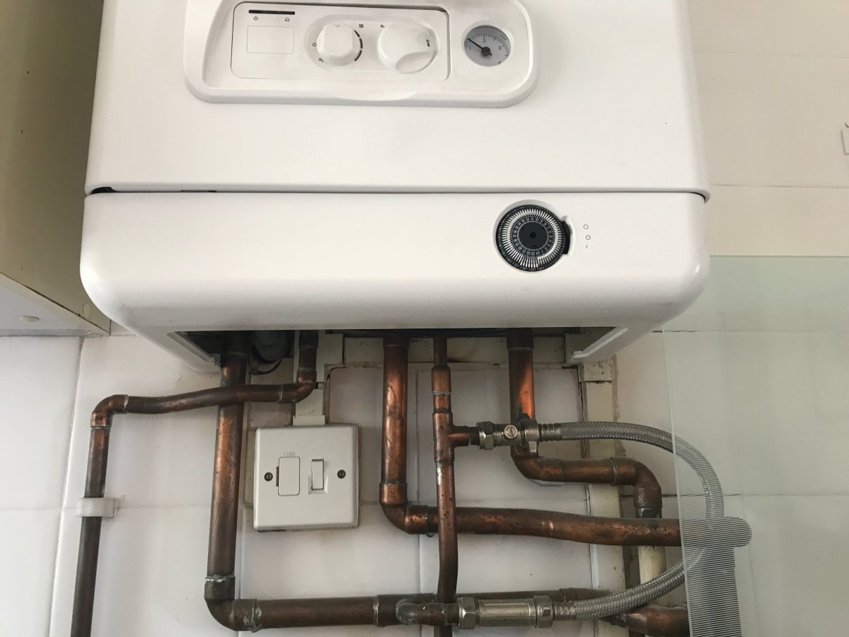

I know how to pressurise the system, as indicated in my photo.

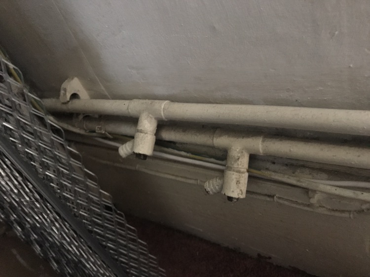

but once or if i've drained the system, by releasing the radiator water from the lowest tap in the flat, wont that drop the water pressure to zero.

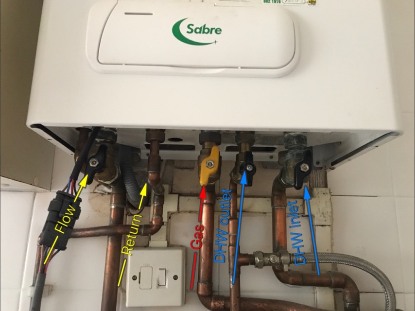

if I release the lowest valve on the Central heating pipes (In the picture), that will drain the central heating and would I be right in thinking that this wont be taking it out of the boiler?

You do know which 2 valves under the boiler you need to shut off to isolate the boiler? I take it you are changing the radiator valves too?
Hi Madrab, my intention is to drain the radiator system, and remove existing radiators and replace and refill.
I figure I would need to turn off the values indicated by the yellow arrow, which would be the return. since there is only one value, turning this off will be sufficient?
thank you
that is not your boiler old son. here is a simple trial , turn a hot water tap on and feel which pipe gets hot , that's the dhw outlet. think you will find its the one you marked " return ".
