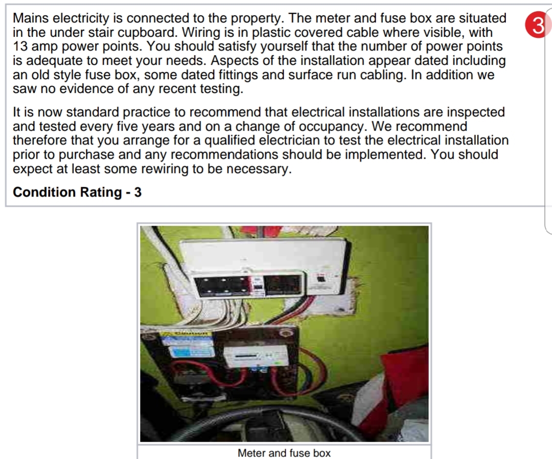

Hello, we're in the process of buying a house built circa 1958 that needs a bit of work. Ideally we would be able to replace the fuse box with a new one without a rewire. An extension was added in 86 but the vendor being quite old doesn't have any information on the wiring within the extension or the rest of the house. My surveyor sent over a picture of the fuse box. I attach this. Can anyone advise if a rewire is likely? Really don't want to fork out 4-5k on this
Nah it wouldn’t necessarly need rewireing.
Looks more modern to me than the dates you give.
Cant see an earth wire in the pic
With plastic rather than rubber cable the socket wiring may be OK, however 1966 the rules changed for lighting, at that point an earth was required on lights, and with that fuse box, it will not be easy to add RCD protection. There is nothing to say you must upgrade, so as long as the cables are plastic they are unlikely to have degraded to a point needing renewal.

Thanks for the detailed reply! To confirm, we can't upgrade the consumer unit without a full rewire? Sorry, I'm new to all this

A consumer unit can be replaced without a rewire, subject to testing on the existing wiring being checked out.
You should take the (unusually correct) advice from your surveyor.
Find a qualified electrician who specialises in inspections and ask for an Electrical Installation Condition Report (EICR). It shouldnt be more than 200 notes and you'll then know what, if anything, needs attention. It will give you an opportunity to negotiate something off the aking price.

The key word is highlighted in red. And how long it takes depends upon how many accessories per circuit you inspect.
With a report of many pages to be written up as well the reality is it cannot sensibly be charged at less than a day's labour unless perhaps severe limitations were agreed with the person ordering the work (and even then it's likely to be substantially a day's work).

Thanks for your replies. Having had another look today I can only see one socket in each of the bedrooms so a rewire looks like it will be on the cards :(
One socket in each bedroom was the norm at that time.
A rewire is not necessary just to add a few more sockets.
However, for an installation of that age, much remedial work will be needed and the time to do it is before the house gets occupied. Get an installation report done, then you’ll know the extent of the task.
I don't even think I'd waste money on an installation report myself, looking at the consumer unit and the lack of sockets, you'll end up rewiring anyway
Before fitting a new consumer unit the electrician should test the existing circuits to ensure they will not trip the new RCD's when fitted, as long as this is done, there is no reason why a new consumer unit can't be fitted. I would say for an older house all RCBO's so any leakage fault is limited to one circuit.
