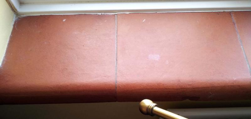

I have created a new window and would like the window 'board' to match that of my existing windows which are tiled in these red tiles.
Any idea what material this is and where I can source similar tiles? Also, what adhesive and grout should be used for these?
They look like old fasioned quarry tiles; http://www.ruabonsales.co.uk/quarry-tile-products.htm
It’s the RE tiles you want.
You can use an ordinary tub mix adhesive & grout but get something decent from a trade tile outlet not the cheap DIY stuff. Tile outlet may also be able to help with the tiles or order them in for you.
