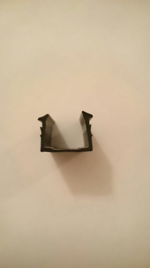

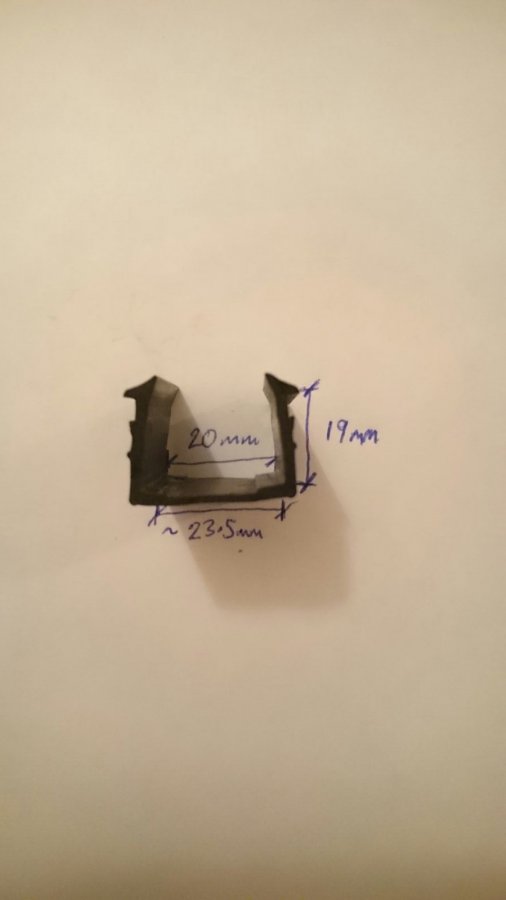

Hi all,
I'm in the process of replacing the sealed units in my windows (well, planning it) and I seem to have hit a wall. I've spent many an hour trawling the internet trying to find a replacement U-channel type gasket to replace the current 30 year old ones, but I can't find the same ones anywhere! The sealed uni sits inside the gasket and the frame just pushes on then screws together. I've taken a sample and pictures with dims are below. Can anyone advise on how I can get an exact replacement / where to look? Or, perhaps what I could use as an alternative?
Thank you in advance.
Regards,
Sam
Just had a quick google but couldn't find any as deep as yours. Have you tried emailing some of the suppliers/manufacturers?
I'm assuming these are some pretty old aluminum windows?
It may be worth posting some pics of the windows as someone may recognize the make which could help.
Also if the windows are that old other bits may be hard/impossible to get (hinges, handles, gearbox's etc.) in which case it may be worth getting some new windows rather than putting in a load of money and effort now to find you cant fix other problems down the line.
Is it aluminium windows? Tried sourcing some a while back, ended up using standard wedge on both sides.

Thank you both for getting back to me.
Yes, the gaskets are for old aluminium sliding sash windows. Everything else I need I have managed to source, so it's only the seals/gaskets that I need to get hold of. I've tried one supplier so far but no luck. I'll keep going though.
DHFrames - did you use some weather stripping or similar to bulk out the frame then use the standard wedges? The current gaskets hold the sealed unit centrally in the frame so if I were to use wedges only is there a risk that the glass could move within the frame?

They certainly look like the gaskets I used years ago on glostal 75mm section Ali patio doors but in 2002 when regs changed and everything needed to be at least 24mm overall it made the 75mm patios obsolete overnight, the same probably for the windows, having said that i'm surprised there isnt any wholesalers selling it, been looking all day between jobs and haven't found any, seem to have drawn a blank this time
Needed two of us, one either side to basically wedge at the same time
