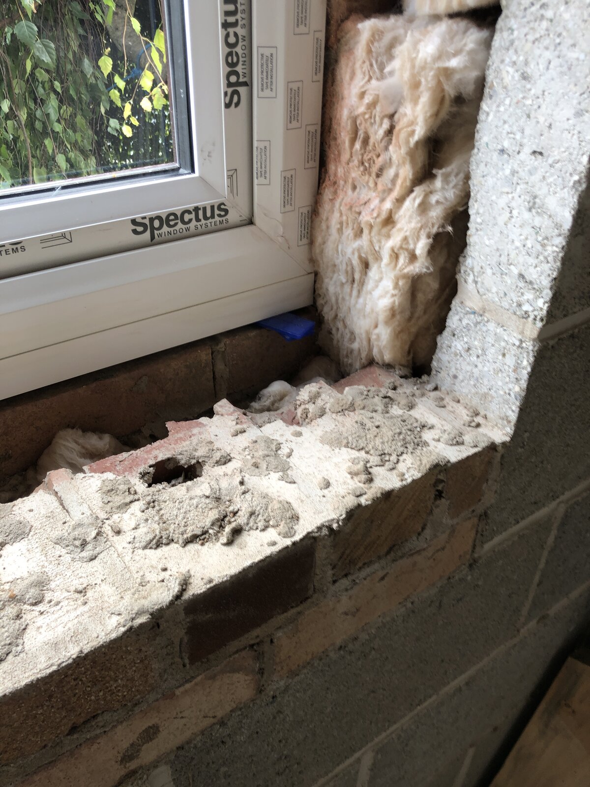

When plasterboarding window reveals what do you do if the plasterboard has nothing to sit on at the outside brick end?
nothing , it’s strong enough to support itself . from the adhesive on the internal brick.......
but you can use the paper board edge and bond it to the window frame if you fancy . show us a picture.
The internal brick is quite narrow
you could fit cavity closers ,or just bond the board to the internal block and gripfill it to the window. your choice.
Hi thanks for the replies. As this is a new build and it will get inspected do I have to put in something in the reveals. The rest of my windows don’t have anything just insulation not damp proof or anything.
Also I need to build up the level from inner brick to outer brick I was just going to add 2 boards if the first board is touching the brick on the outer side and obviously sat on the inner brick will this cause water issues
