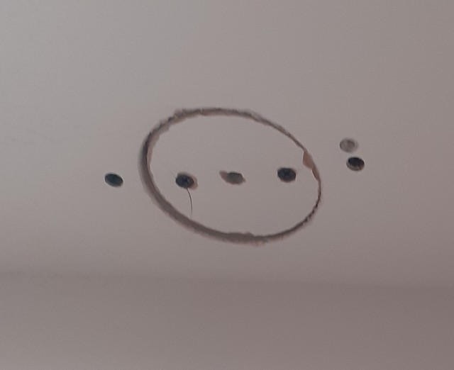

Are your windows in reveals which are smaller on the outside than the inside? If so the reveals will probably need to come out (more a problem in older houses TBH).
Otherwise use a multitool to cut away a small rectangle next to the window, near the top or bottom. Use a light and a mobile phone to locate the straps. Cut away a rectangle where each of the straps are. You may need to make several exploratory openings to find the straps. Cut the straps, sealant, etc and pull the window out. Remove the remnants of the straps. Attach new straps to the new window in identical positions to the original straps on the old window (so you can reuse the cut outs). Install new window and fix straps in place. The cut-outs then get 2 x 1in softwood laths inserted which are longer than the opening - so for a 100mm opening something like a 130 to 140mm long lath is needed. To manouvre this a screw is put into the front of the lath so you can pull it onto the back of the PB whilst screwing through the PB into the lath in order to secure it (the outer screws in the photo below). Once the lath is fixed the locator screw is removed and a piece of plasterboard is cut to fit the opening. This is screwed onto the lath (the inner screws, below). This can then be scrimmed, skimmed (with filler) and sanded. Here is a hole sawn opening in a ceiling after a similar repair (I have just done about 80 of so of these):

Just to make life interesting (not!) I needed to use the self same technique last week when we had to cut out some plasterboard to allow the fire stopper to replace the fire collars from inside a riser cupboard (a dozen holes in all). Bloody awful job!

All I can say is that it's amazing what you can achieve with a multitool, 2 x 1in lath and scrim tape!
