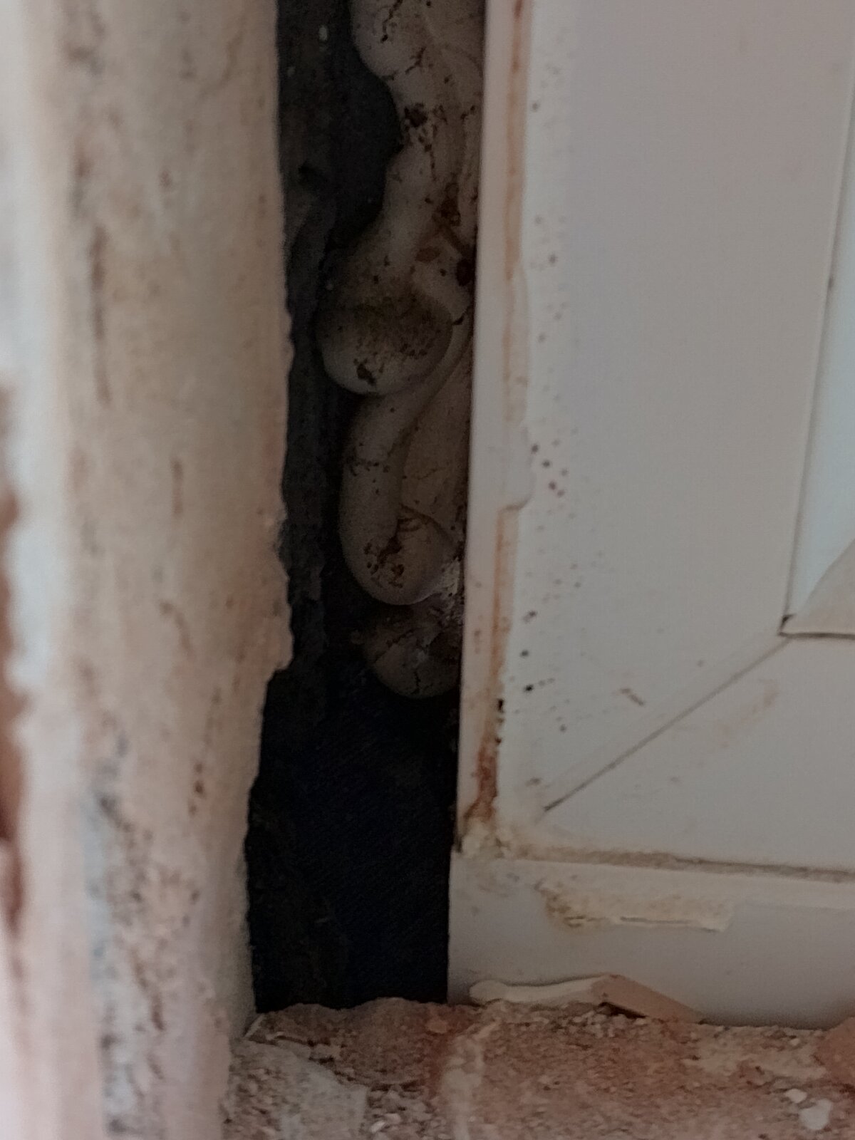

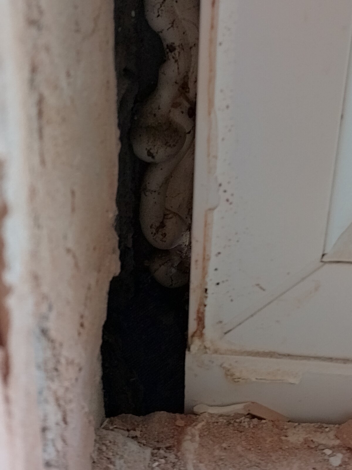

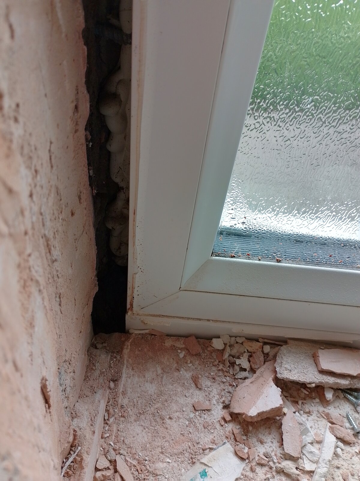

After some advice on how to fix this please.
I took the tiles off in the bathroom and most of the plaster came with them, exposing this gap between the reveal and frame.
It's a solid blockwork wall, no cavity. If I feel inside the gap, I can feel the end of the cill which appears to be open.
I believe water can potentially flow through the cill so not keen on just squirting it full of expanding foam unless it wicks moisture into the wall.
I plan to use insulated plasterboard to repair the reveals (they won't be tiled) but in terms of the gap, what is best to use? Was thinking of pumping silicone into the bottom corners to seal the cill, do I then need a damp proof membrane?
Thanks in advance

Masking over window frame and mist spray water, then fill with foam.
When dry cut foam back tidy.
Remove masking from frame.
Pva dry surface all the around.
Dot and dab plasterboard around to square up.
Maybe more then one layer of board to build out. A sheet of 15mm board will do it all as I bit thicker. About £12 a sheet.
Or that insulated board as you say..
Fit a DPC before foam.
We make our own closers with DPC and foil PIR. Always foam them in.

Sorry no it's uPVC. Asking as I had another window that was causing damp spots in the bottom corners of the reveals, due to water tracking through the cill. So wondered if it was worth sealing the ends with silicone while exposed
Outlaws window was the same.
Fitters wanted to put new window in so I run silicone around but no change to the water leaking in the corners. Had me puzzled as looked fine.
I bought the £15 foam gun from B&Q.
Pushed mastic nozzle on the end.
From the outside rammed in nozzle and filled with foam.
Run new silicone around window and 5+ years its still good
Silicone is the only thing stopping the water running over the flat bricks which wasn't doing then job.
Other problem is fitters not wanting to pull brick out for sill ears. They just cut sill and mastic up. Some sills don't even have the ears which is worse
