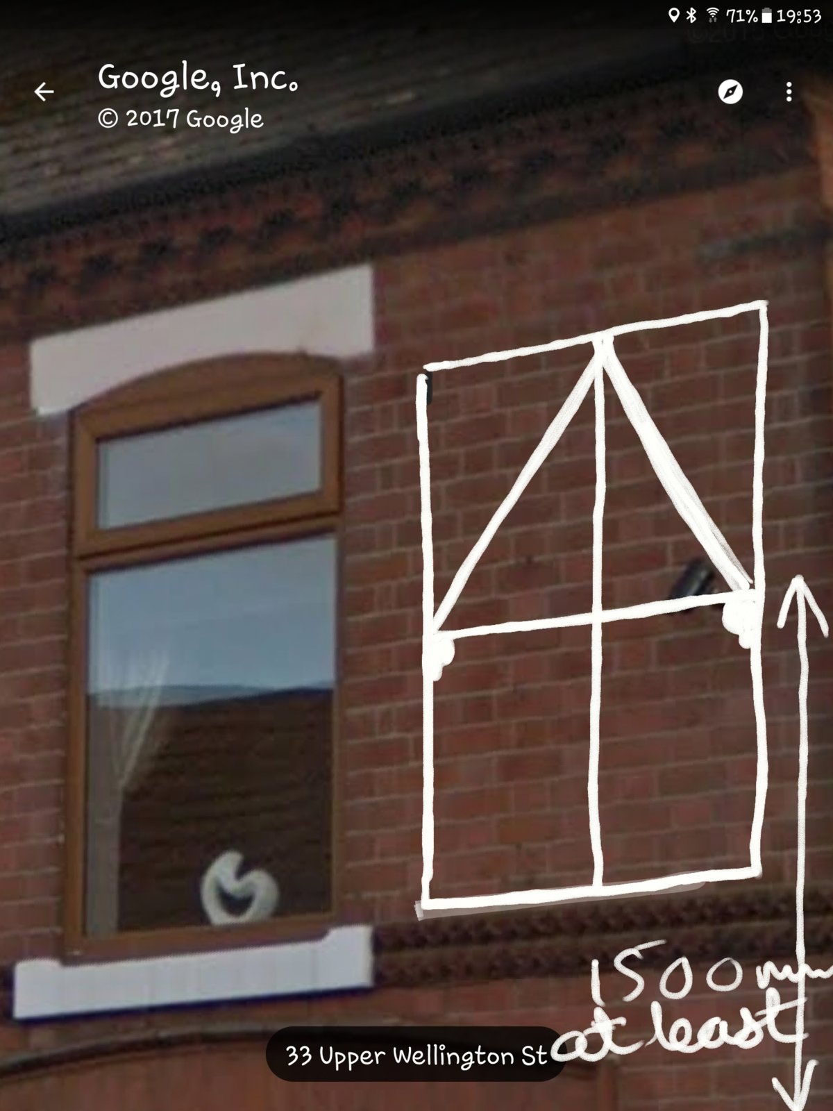

Ok window fitters what's the rules regarding the above, someone I know has had a house full of windows, old pvc out new pvc in, all upstairs windows although have a clear 450 opening going up to 600 but all have transoms at 1500mm, now as far as I was aware transom couldn't be above 1100mm, fitters are saying they're right
What came out? did they just replicate what was there already? If so they fall under ' not making the situation any worse ' scenario
As above, before and after

Is the bit in bold a guideline or is it law, ok they've made it better by lowering the transom but its not enough as it's still at least 1500mm above floor level
Theres the crux of it ' It is considered Good practice ' doesn't mean that it is a failure. At a fensa meeting many years ago, we were told that if you replace Pvc that you can put back exactly what you took out, as the situation is' made no worse ' .
Me , personally , I would have altered it for better Fire Escape as you show, under due care and diligence, better to have an altered window , than a potentially trapped person due to poor window design

Its the bold bit at the bottom....
Yeah it looks like thats what they're clinging on to, where as I was looking at it from the POV that if i were replacing it then I'd of made it easily accessible
I would do the same as you but some just look for the easy way out....
