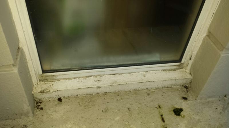

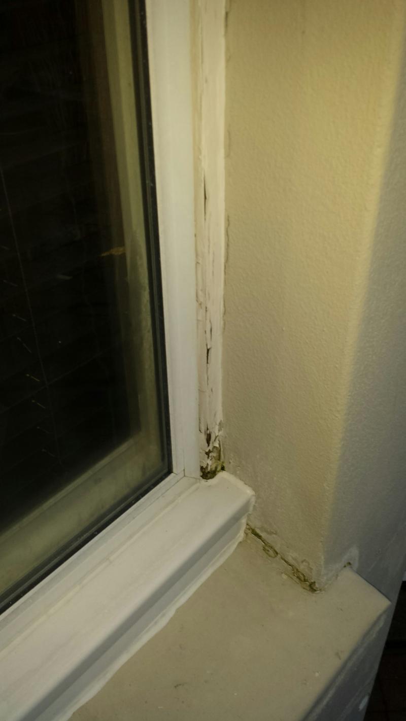

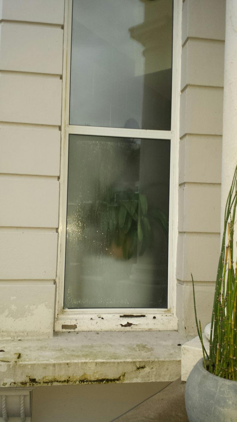

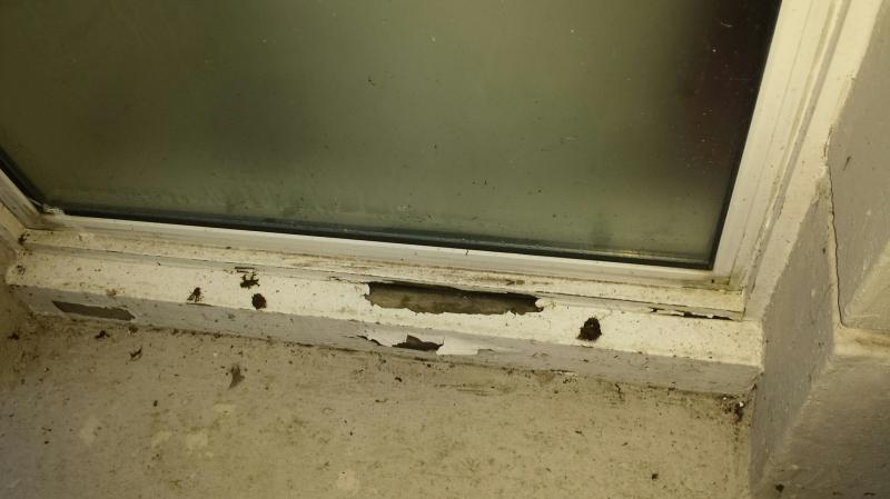

Hi,
Newbie to DIY so looking for your thoughts on the following aspect.
Move into a flat last year - East Sussex - seaside town - 15 min walking distance to sea.
Windows sills / Frame as you can see on the picture need some love and nurturing.
These are aluminium windows - which I guess could be replace but initially looking to maintained the sills in first instance.
First question:
Is that something I can sort out myself easily? or should I get someone to do it for me?
Secondly, if doing it myself, what would be the step by steps, tips, and thought to do it the best way.
Thanks,
Jeremy
Not an expert Jeremy, but best case i would say strip back as much as poss to wood all round, sand and fill any gaps. treat with good quality primer and then paint. ensure you seal sides with window sealant. Remember water is your enemy and it WILL get in if theres the minutest chance.
Worst case some parts rotten, probably bottom windowseal and would need replacing. As you are a self confessed novice I would strongly recomend calling in an expert, or at least a competent friend.
Another option if rotten would be to use a wood hardener treatment?
http://www.wickes.co.uk/Wickes-Wet-Rot-Wood-Hardener-500ml/p/600075
This works well, although not the ideal long term solution, you would still need to take out any crumbling wood that is too far gone so would mean filling holesTo match profile.
