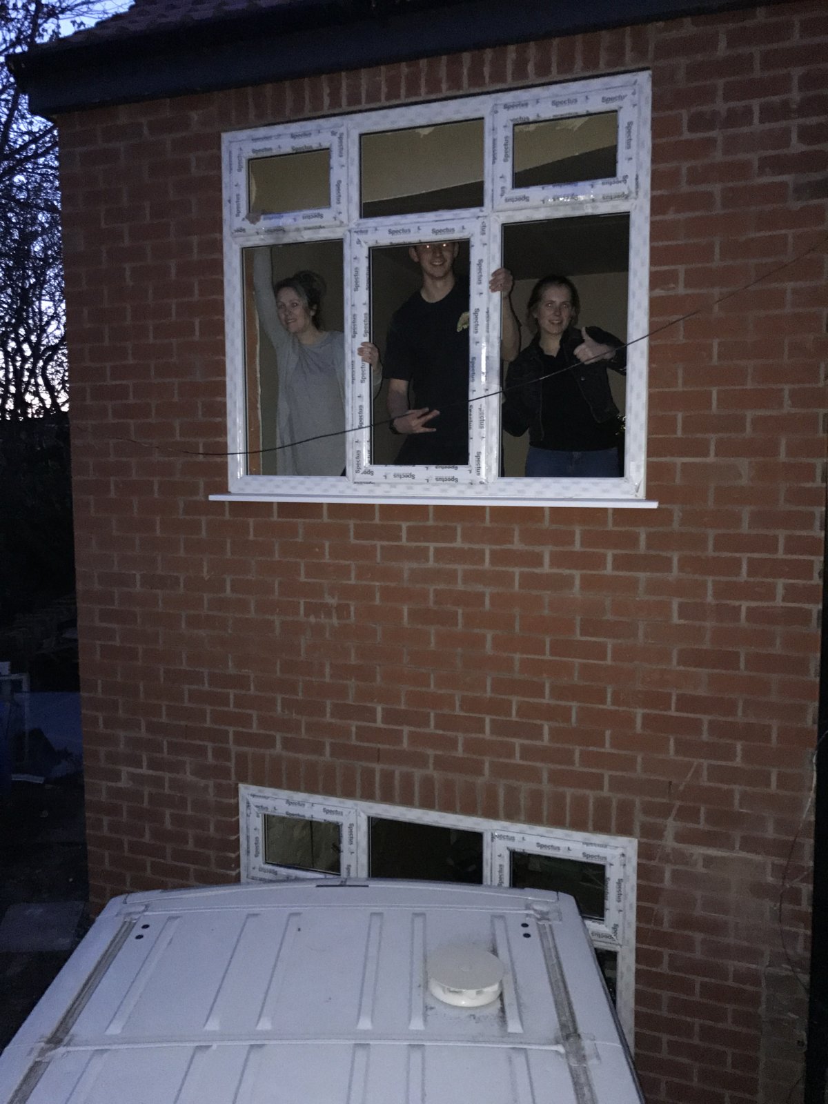

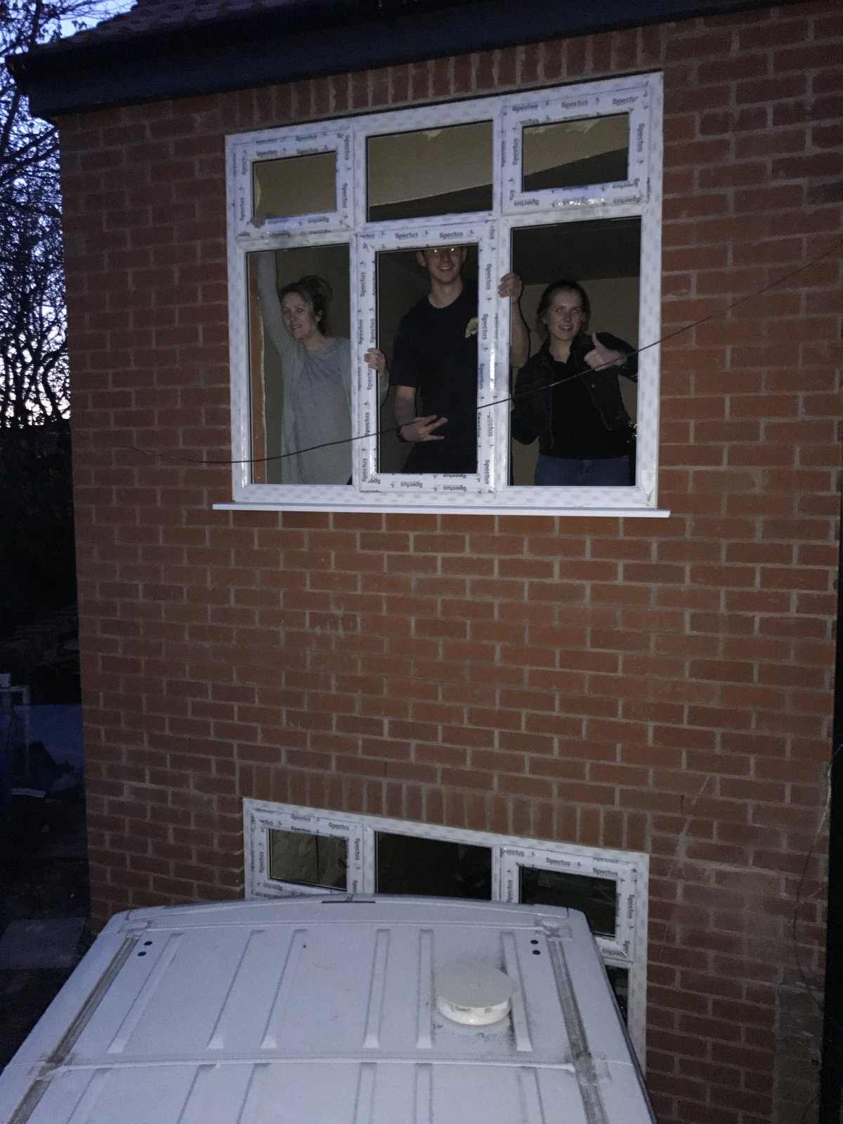

I measured 1 window exactly and it didn’t fit. Best thing was we posted it out through the upstairs opening to pull it back into the opening.
I had the get the missus and kids to hold it while I backed the van upto the house, then I trimmed the fins off the sides to make it fit.
