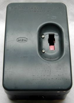

So you are looking at this thread, how about an answer to this?
That one has fuses, so could be a fuse box. What do you think?
I think fuse box would be totally appropriate, in that case how about this one?:
At what point in time did fuse boxes stop having switches permitted?
a different question "When Consumer Units became common, what differentiated them from Fuseboxes?"
The answer is "A Consumer Unit includes a Main Switch, a Fusebox doesn't"
We are going back a very long time now. You are very unikely to find a domestic fusebox less than 60 years old, or a consumer unit more than 120.
See if you can find a copy of BS 1454:1948 Consumers electricity control units https://shop.bsigroup.com/ProductDetail?pid=000000000030307074
You might prefer the description "a particular type of distribution board comprising a type-tested co-ordinated assembly for the control and distribution of electrical energy, principally in domestic premises, incorporating manual means of double-pole isolation on the incoming circuit(s) and an assembly of one or more fuses, circuit breakers, residual current operated devices or signalling and other devices proven during the type-test of the assembly as suitable for use."

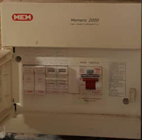

So what would you call this:
or this
