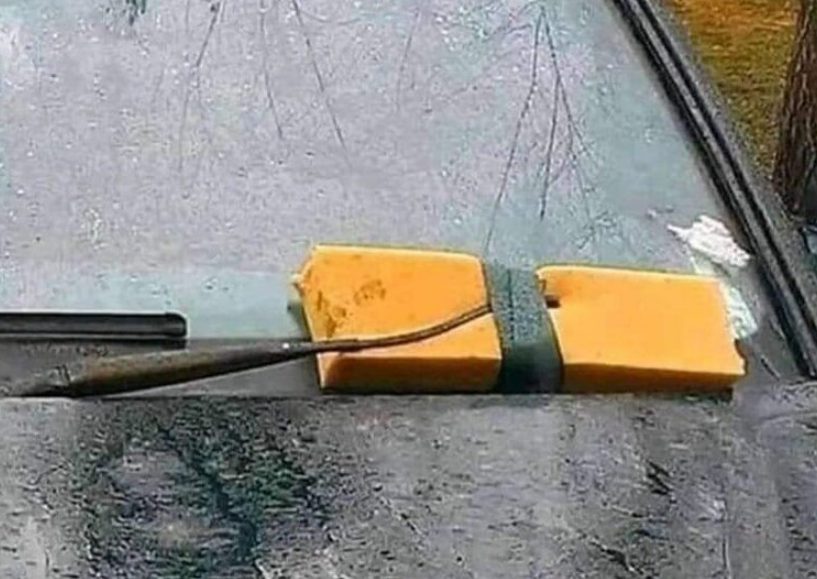

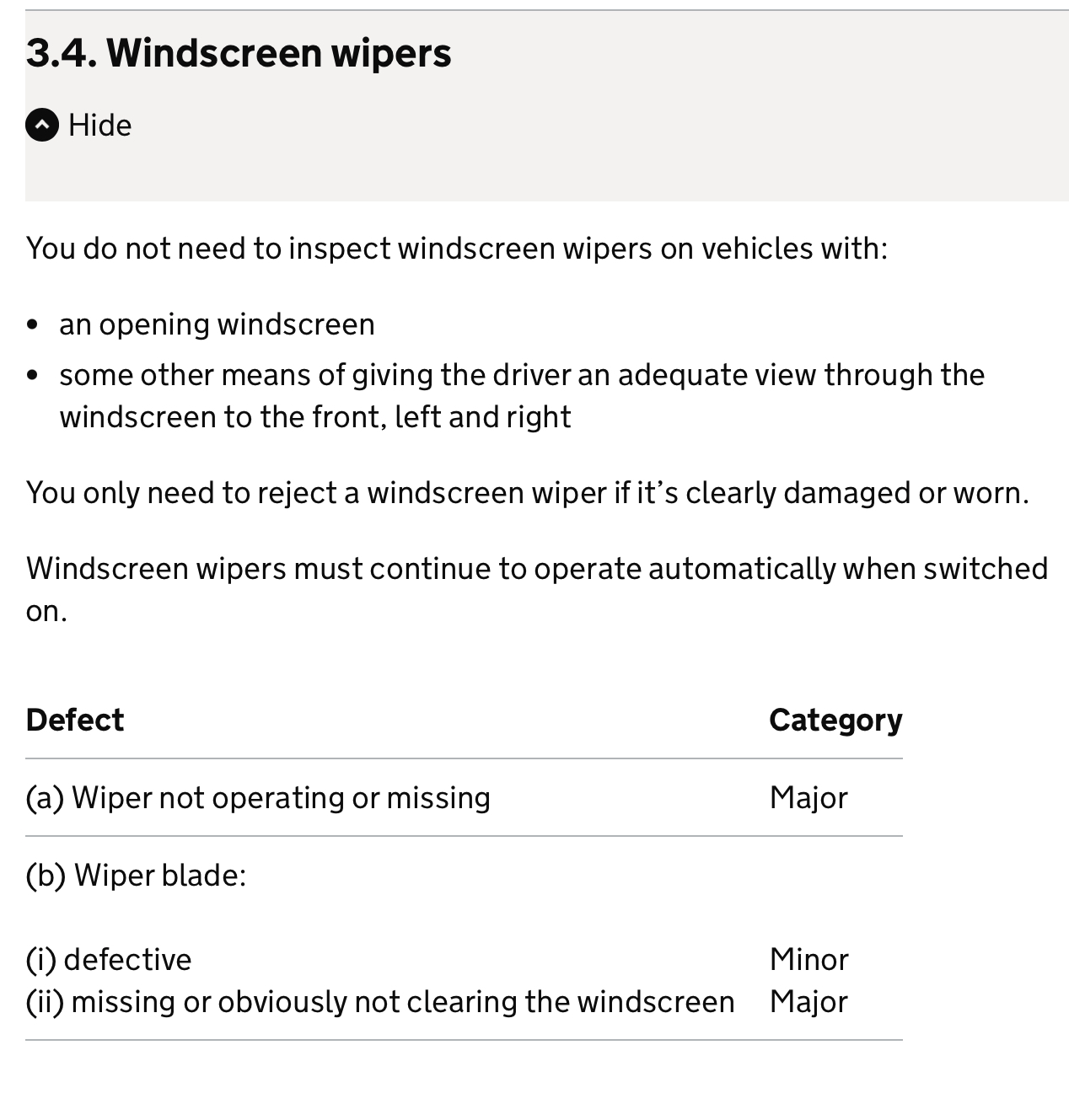

Munroast Joined 17 Aug 2010 Messages 5,230 Reaction score 2,211 Country 21 Jan 2025 #1 would this pass MOT - what are the rules concerning wiper blades ?
Mottie Joined 27 Feb 2017 Messages 55,656 Reaction score 14,538 Location Essexshire Country 22 Jan 2025 #2 Although I think the one in the picture is possibly a temporary get out of trouble job, possibly because the wiper blade has been pinched and to prevent the arm scratching the screen.
