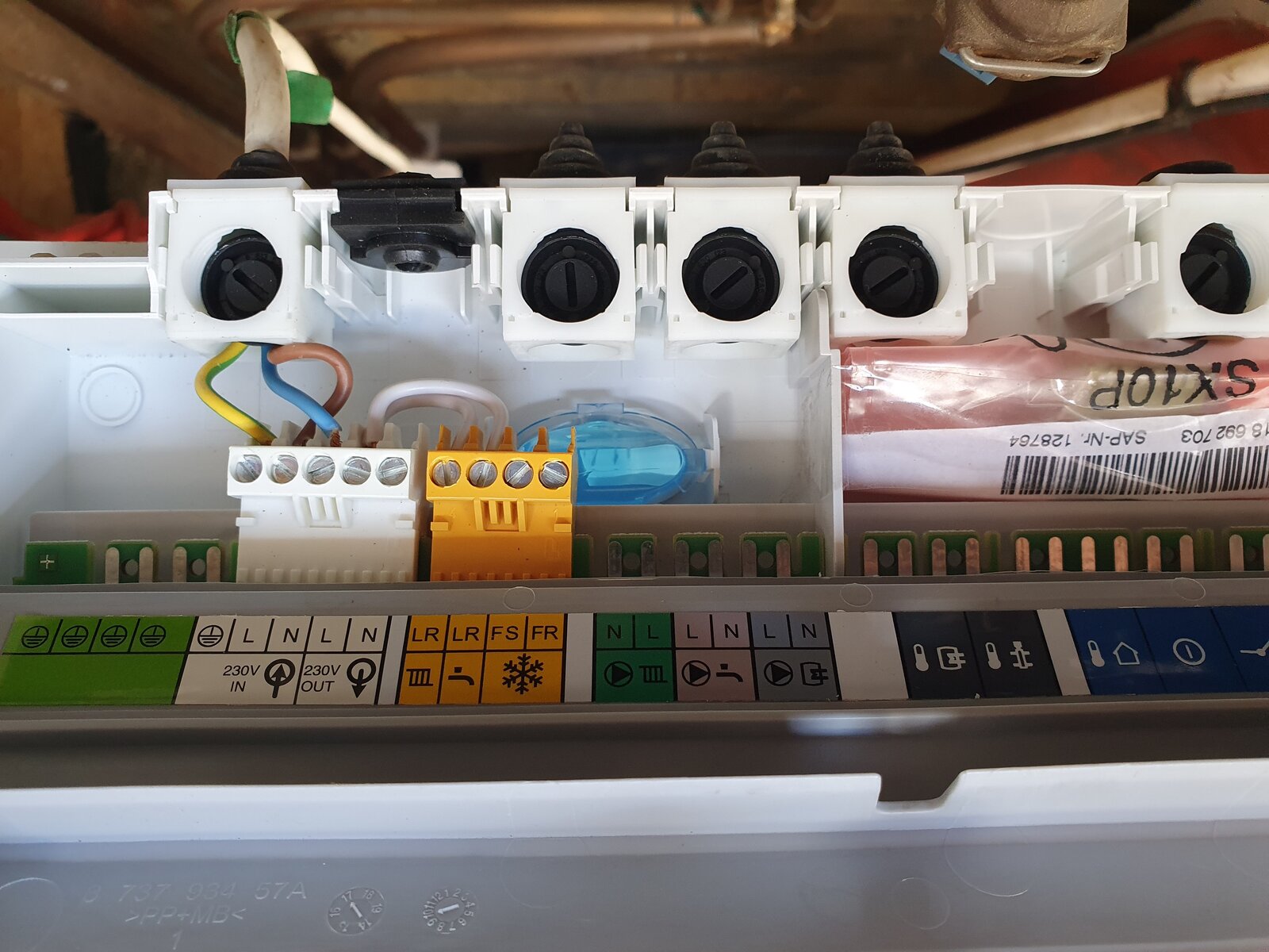

Hello
I recently had my boiler moved by a family friend as we are having an extension done. He wasn't 100% sure on the electrical connections though and since moving, we now have hot water only, no heating.

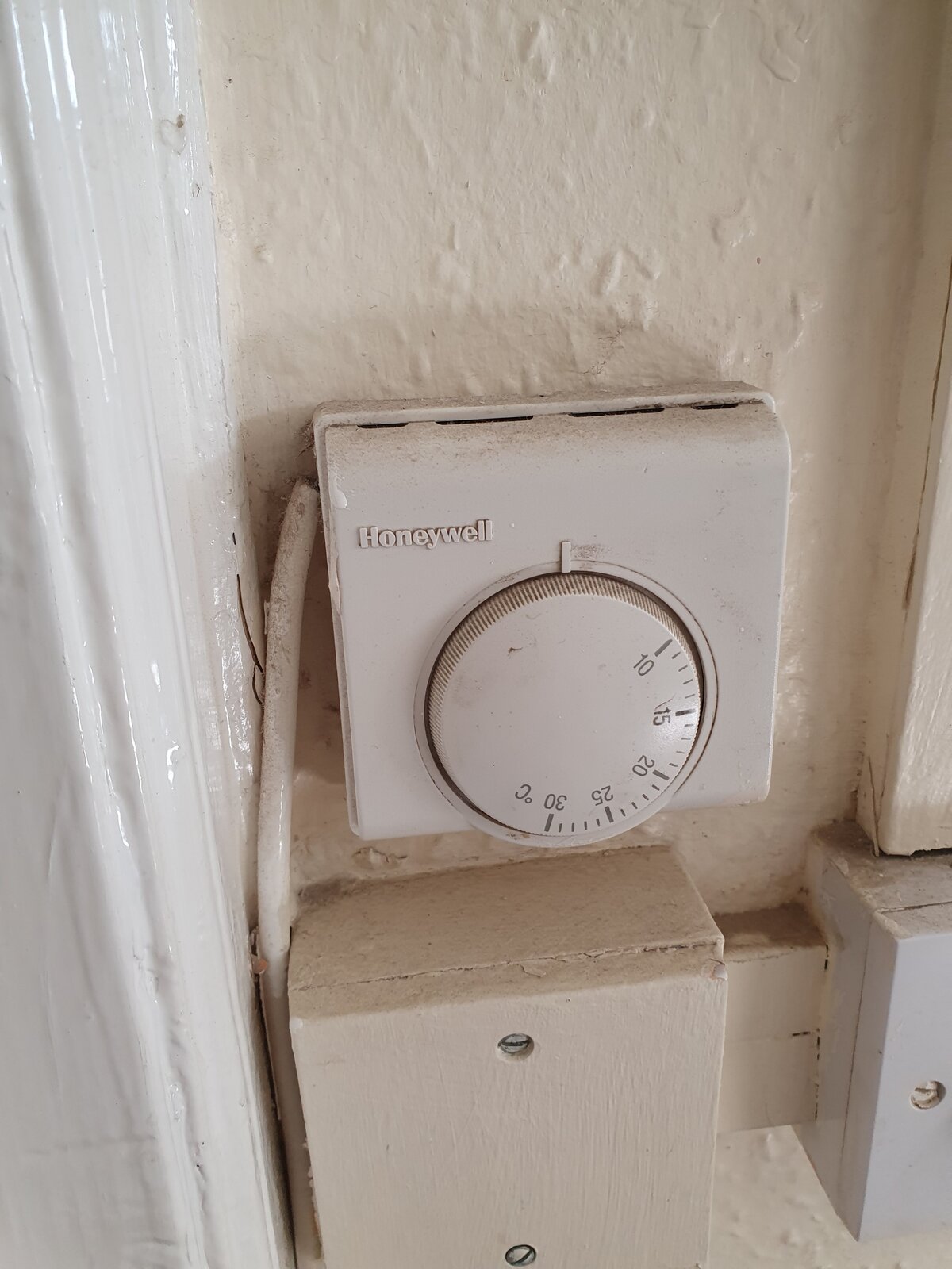

Before I get someone round to fix, I wanted to ask here as can only presume that a connection is missing/incorrect, given we had heating previously. The old wired Honeywell thermostat looks like it has not been reconnected post the boiler move. Having looked through the manual I can't find an obvious answer as to where the connections for this should go.
Any help or advice would be much appreciated.
Cheers
Pics below of current connections into boiler & of thermostat:
Current connections:
https://ibb.co/N7nCL3G
Cable from thermostat:
https://ibb.co/6mnnh61
Thermostat:
https://ibb.co/qsYkrh2

It appears someone has put a link wire in, so you may still be able to get heating. Are you wanting the Honeywell reconnected?

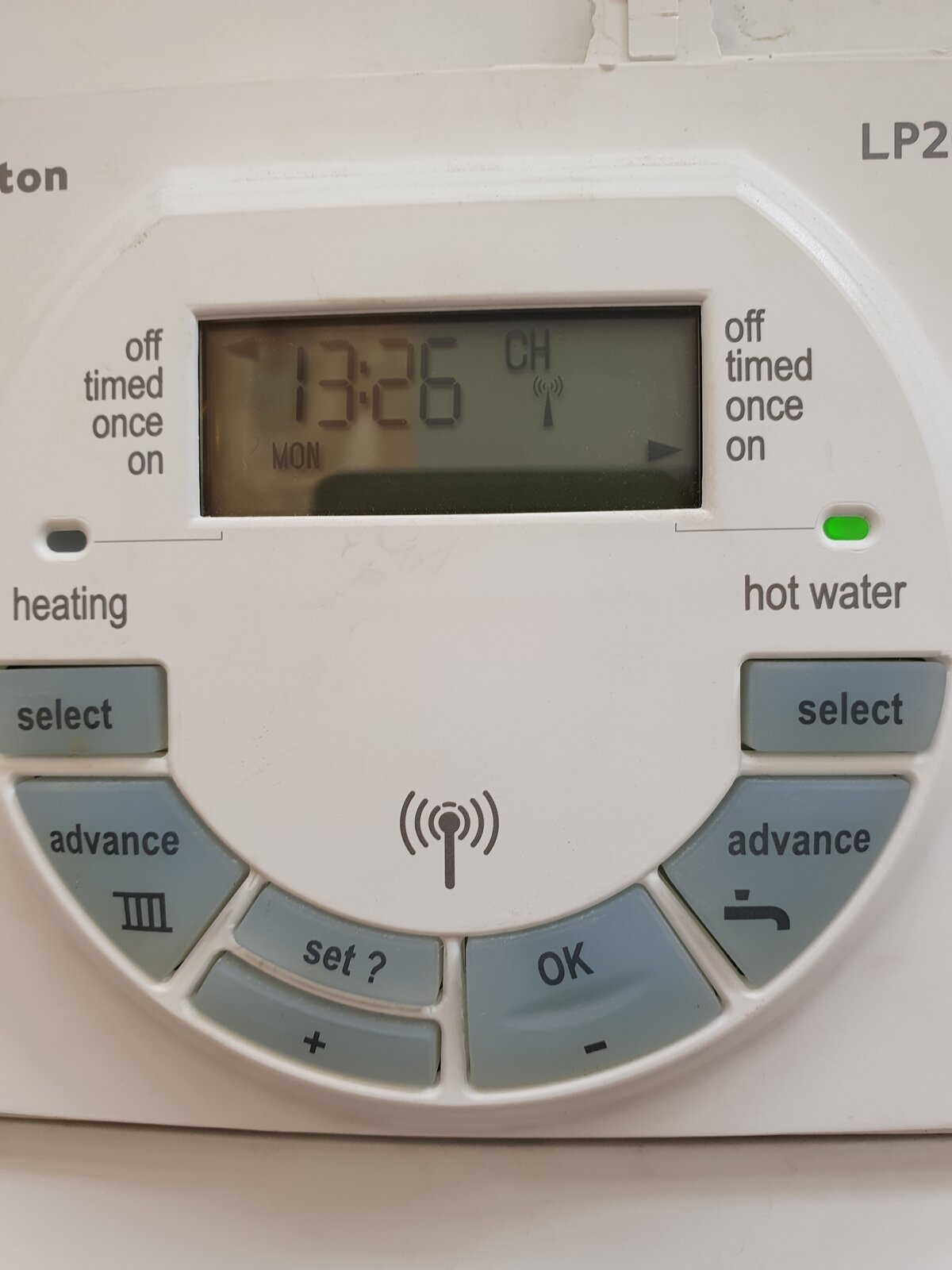

That thermostat is due to be removed/replaced in the next couple months once building work is complete, so if I can get the heating working without it then no, not fussed. I had just assumed that this was the issue, given the flashing indicator I was seeing on the boiler control - am seeing a flashing antenna symbol and letters 'CH', with heating in constant OFF position
Pic of control:

Ok, what happens when you select heating? It looks as though you have a built in wireless receiver, hence the flashing, in which case you just need the handheld thermostat, not the Honeywell you posted a photo of.
That boiler controller is wireless, the thermostat in your pic isnt, you must have another thermostat that is battery powered your Programmer is a Drayton LP20 RF, can come with two different thermostats, if you google it you will see both
