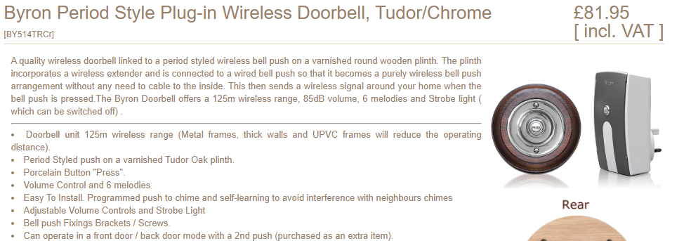

Hi,
I've got an old Victorian tell-tale/servant's call box (the type where some presses a button in a room and a little flag waves while a bell rings to call a servant). Connecting it up to a 6V supply it works perfectly and I can happily call servants to any room from my workbench! So, I'd like to reinstate it (not that I have any servants, but hey ...)
The problem is that all of my rooms are nicely decorated. I don't want surface mounted wire and I don't want to have to dig into the walls to hide the cable. So, what I am looking for is a wireless bell push in each room.
Obviously, the internet is full of wireless doorbells, MK's Logic Plus, TLC Direct's QinetiQ, wireless Z Wave products, ... etc. But none of these things have a bell push that looks Victorian/Edwardian. I guess I am thinking a white china button with the word "press" on it, surrounded by a dark wood or brass mounting plate.
Back at HQ, I'd then need some sort of relay that is connected to the mains (so is always on) and on receiving a bell push can switch a 6V battery feed.
Then, rinse and repeat this setup for each room I want to - ahem - summon servants to.
Does anyone know of any suitable suppliers? As I wrote, the major problem is finding a supplier of a suitably 'period style' wireless bell push.

A Google search for "Period Wireless Bell Push UK" gets an awful lot of hits, and many of the early ones seem to relate to a company called DoorbellWorld (click here) . That company offer numerous variants (appearance wise - colours, material etc.), but all are around £80 each - one example is sown below. However, I haven't looked at any of the other suppliers, so there might be much cheaper available ...
Kind Regards, John

Thank you. Yes, that's the sort of bell push look I am going for. The problem with that sort of thing, though (as you say, available by the million) is that it's a closed/unknown wireless protocol to drive the plug in doorbell.
I need the bell push to be able, ultimately, to drive a switched 6V supply to make my flags wave. It may be that I can take the plug end of the doorbell kit apart, find the wireless receiver, and rig something up. But, I was hoping there might be a "wireless period style bell push drive a wireless receiver relay" solution out of the box.
The obvious thing I've not done (but you've nudged me ...) is to write to DoorbellWorld and see if they know the answer!

Fair enough, but I think it might well be wishful thinking to be able to get precisely that 'off the shelf' - so I was, indeed, thinking that you would probably have to "... take the plug end of the doorbell kit apart, find the wireless receiver, and rig something up". That may well be pretty easy - I presume that all you really need to do is to find the feed to the 'bell'/sounder and somehow use that to drive a really (and silence/disconnect the actual 'bell'/sounder).
That certainly can't do any harm - although, as above, I don't think you should be 'holding your breath' is the hope of finding a ready-made off-the-shelf total solution. However, you may be lucky!
