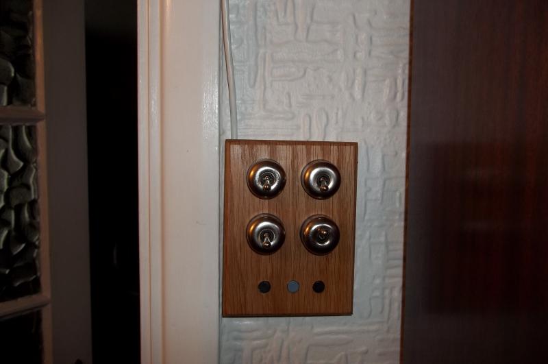

An alternative is to use ELV ( 12 volt ) switches controlling relays that switch the 230 volt supply to the lamps.
This panel controls four lamps as simple ON OFF with the toggle switches and the buttons provide other more complex functions via a 12 core alarm cable and a bank of relays.
The motivation for me was to remove the need to chase into wattle and daub walls and thus keep the Conservation Officer happy.
Wireless was an option but avoided for two reasons.
[a] some of the walls are 2 foot thick stone and wireless does not work reliably through them
activity on the 433 MHz channel used by home automation is very high and lost commands are already affecting a heating control system in a nearby house.

Basically yes but in this cottage more than one "central" controller. Uses a PIC processor, 24 inputs and 32 outputs controlling relays. TImers and multiway switching facility. Flexible configuration via a laptop. Lamps can be paired and for dimming connected in series. ( not for energy efficient lights )
