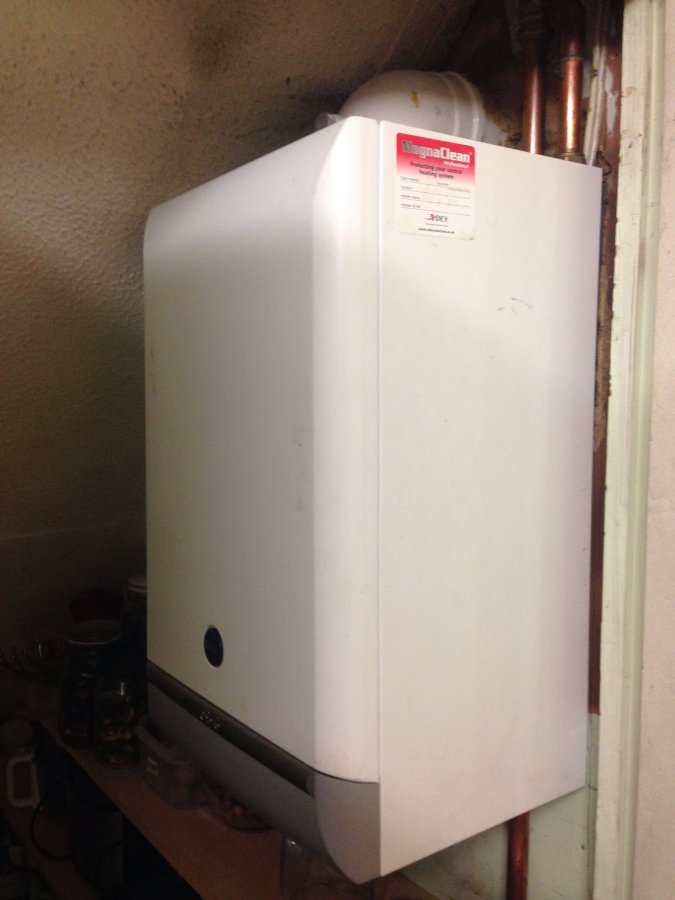

At the moment there is no means to control temperature of CH system other than knob on Baxi Solo 15 HE boiler (flow temperature)

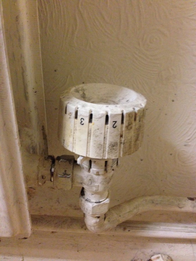

I can also adjust radiator valves but its all or nothing.

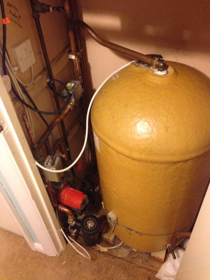

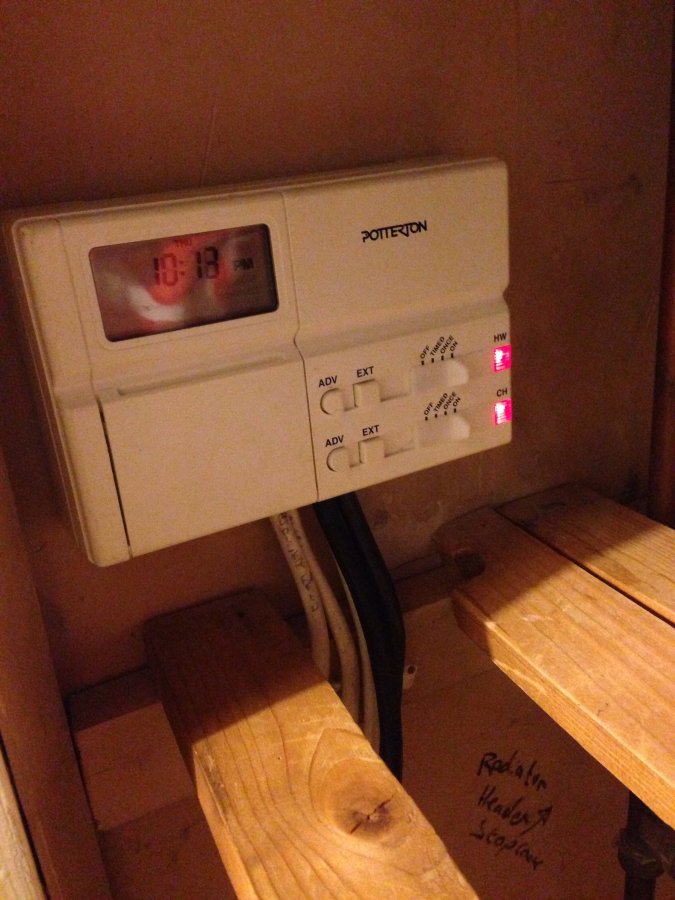

Upstairs there is Pottertron EP2002 programmer, indirect hot water tank, pump and 2 zone valves.
In the loft one tank for HW and one header tank for CH.
What I would like to do is to replace Pottertron programmer with something that could separately control on and off times for HW and CH and to install wireless thermostat in living room.
Can somebody recommend something not too expensive that would do the job.

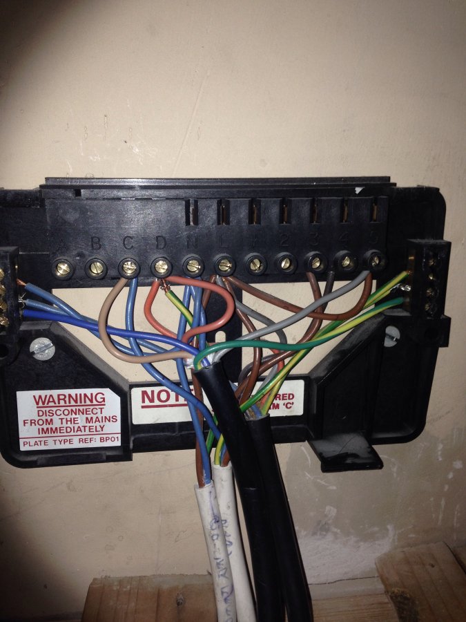

Turn the power off; remove the EP2002 from backplate; take pic of the backplate (so we can see the wiring); replace EP2002; turn power on.
Post pic.
I was thinking about hive, but it is too big for me now defenitely in future after boiler replacement, see photo of programer

You would need a wiring centre (junction box) to replace all the extra terminals (A to D etc) of the EP2002 backplate.
If you don't know what you are doing, leave it to an expert.
The HW on this system is controlled by cylinder stat which in turn activates zone valve and than the pump, boiler fires up etc,
Can I wire in room thermostat to CH zone valve to work similar to HW ?
