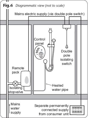

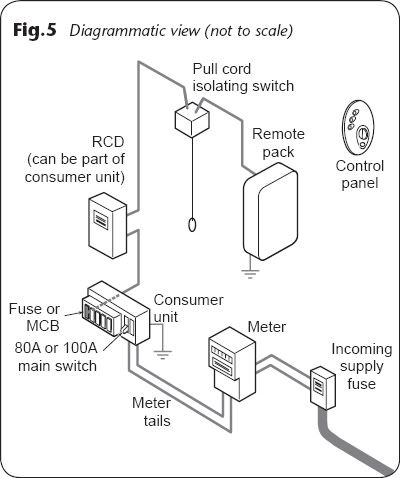

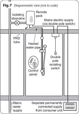

Would these be non-notifiable under part p??? :o
Where would means of isolation go?
It doesn't show any bonding to the metal of the shower head or the support for it.
Maybe I am being over cautious but if the water pipe to the heater unit is plastic and a fault , element to water ocurs is it ok to rely on the CPC in the twin and earth to ensure the water is not electrically HOT as well as temperature hot.
( Note I do NOT like electric showers, specially where there is no way to bond the exit pipe to ground )
In one of the photographs, it shows the metal tube coming down from the ceiling. The tube forms the riser for the shower head to attach to, and contains the plastic water hose. I would guess that due to the metal going out of the bathroom, it is an ECP, and should be bonded.
Bernard, Im guessing here, but aren't the heaters inside a shower enclosed in a metal can in which the water circulates? Thus any fault heater to water, would conduct to the metal can, and to earth, tripping the RCD straight away.
Providing there is adequate plastic pipe work to provide isolation, I don't think I would class the metal drop it as an extraneous conductive part, even if it is metallic. Similar concept to having a radiator on a plastic pipe installation with short metal drops for aesthetics. I was going to say consult the manufacturers instructions, then I looked at them! Appalling:
No. That is not the definition of an extraneous conductive part. (Page 22 BS 7671)
