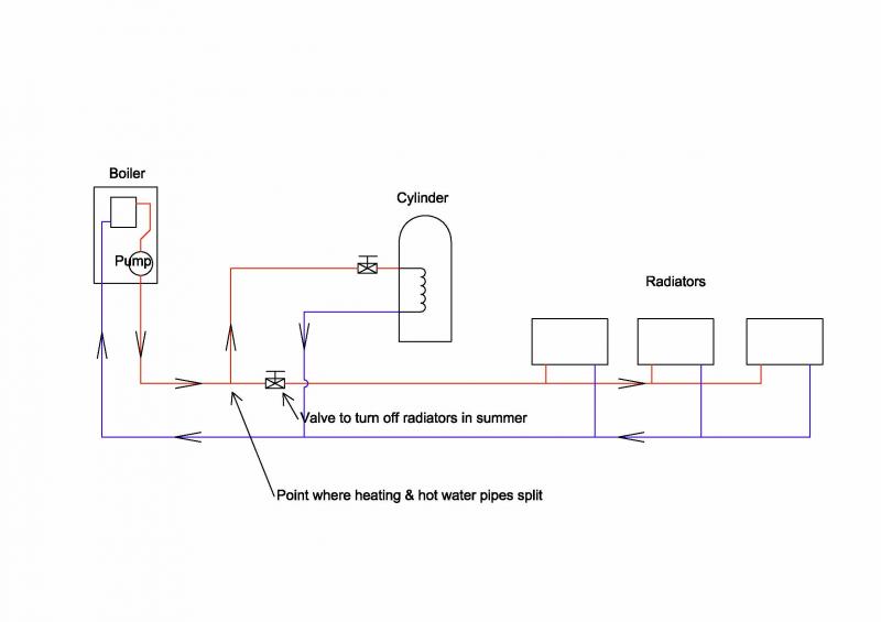

Ok, this is my pathetic way to find out my system. Apologies for the draw and the poor quality of the photos. Perhaps you can find out for me how to isolate the heating for the summer months.
All the manual switches which I find are on the photos below.
Not happy. maybe a drawing error.
What can you tell us about the cylinder.
Is there a pipe out of the top, pic please, not too close.
Here's what will happen. Then you can make your own decision whether to do it or not.
When the room thermostat is calling for heat, the hot water cylinder will also be heated. When the room thermostat is satisfied, it would turn off the boiler and pump and so the hot water would also go off too.
OK, the hot water will come back on again when the room thermostat calls for heat, so you might get away with it in the winter when the heating is running most of the time. If the weather was mild like now, and someone ran a bath you may have to wait a while for the heating to come on and the hot water cylinder to reheat.
In the summer when the room temperature is 22 degrees, and the thermostat is set at say 21, the radiators will not come on at all, neither will the hot water. If you want hot water you will need to turn up the room thermostat, and of course the radiators will come on too.
OK you could turn off all of the radiators at their manual valves and then turn the room thermostat up, but it's not the right way to do it.

It's the two pipes from the boiler to where they split for the heating and connect to the cylinder we need.
doitall";p="2627827 said:
It's the two pipes from the boiler to where they split for the heating and connect to the cylinder we need.[/quote
It has to be the one below!!???
There will be two pipes that connect to the cylinder and go back to the boiler.
Not connected to the shower pump or pipes.
The red valve in you last pic where do the pipes go.
On the left goes inside the wall and on the right goes to the cylinder.
It has to be this one right?
This is a draw of the pipes for that switch.
Apologies for the poor quality and my bad drawing skills. :-)
