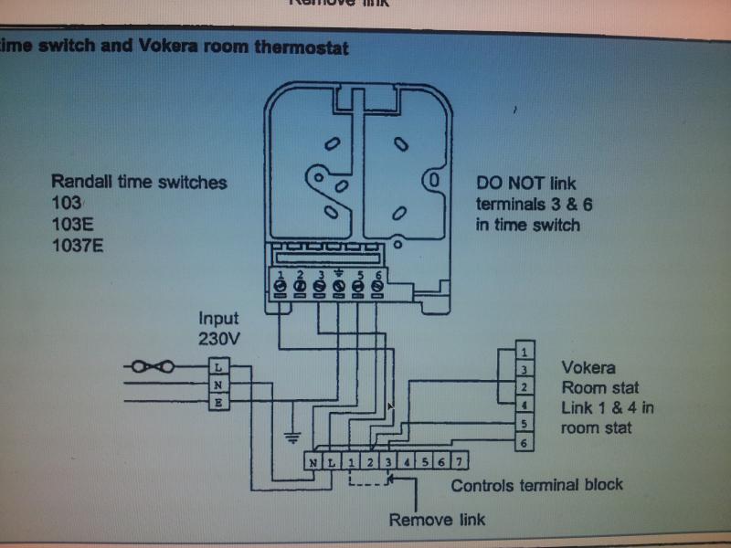

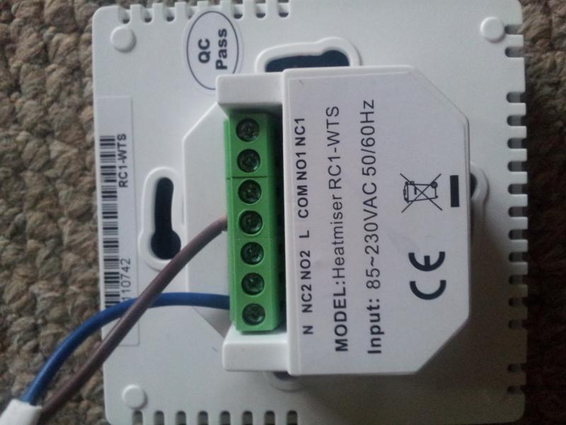

Hi there, I have the same Vokera heating system with the timer and an old thermostat and I got a Heatmiser RC1 WTS wireless thermostat. I was wondering if anyone can confirm the connections I need to make please, I got two pictures , thank you.
Hello scaote and welcome to the forum.
It's not just the boiler that makes up a system, that's the simple bit electrically speaking, it's the controls that are connected that determine the wiring.
Unfortunately you don't give us a lot to go on. However, if this is just a thermostat swap, if you can provide us with the details of the existing thermostat and the wires that presently go to each terminal, we should be able to work out what each one does and where they should go on the new thermostat.
