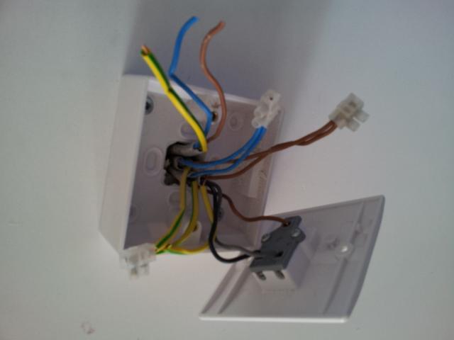

Hi, I have put up a light for someone outside their garage. The wires were already installed by the electrician previously. Putting the light on was not a problem, but the other end of the cable from the light had been left behind the existing light switch that powers the internal garage lights ready to be connected.. Assume this would mean the outside light would come on when the internal ones were put on. I am unsure where to connect the wires into this switch, can anybody help?. Photos attached for info. Many thanks
How does the outside light operate?
Is it a PIR based light or a standard on/off?
The switch is currently wired as a two way switch which is linked to another switch nearby probably at the other end of the garage.
The electrician has left what appears to be both a live and neutral in the connector blocks.
If the outside light is a standard on/off then personally I would replace the current switch with a 2 gang two way switch and wire the three core and earth (brown, grey, black) as they are.
For the second gang (controlling the outside light) I would connect the incoming blue and earth cables (from the outside light) to their respective connector blocks - put the two browns (currently in the connector block) into the Common Terminal and the incoming brown to L1 on the new switch.
The same connections would also apply if the outside light was controlled by a PIR except that the switch should be left permanently on.
Thanks Riveralt, The outside light is standard on/off. I thought it was silly to have the light connected to the one gang switch anyway. Far better to have it work independently, so your idea of the two gang switch is a great idea. Many thanks for the wiring advice, I will give it a go

Just like to say thanks to Riveralt. The switch is all wired up and light is working fine. The friend I done it for is delighted with his new light and nobody was killed in the process.
