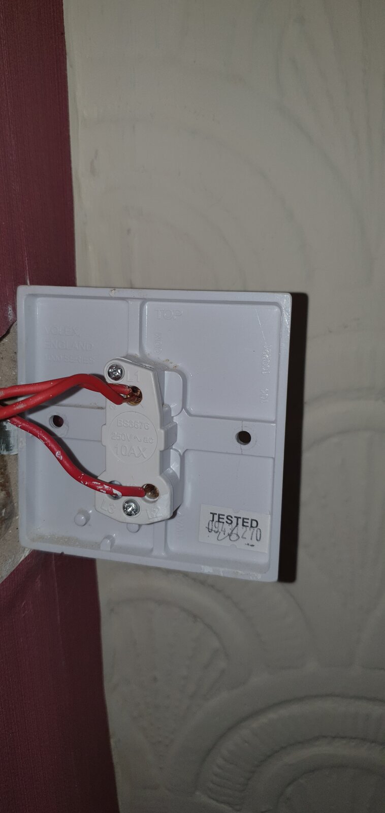

Hi. I have opened the wall Switch cover and I have only 3 red wires and 1 earth. 2 of them in L1 and 1 in L2 none in L3
My Dimmer has 1 x L1 1 x L2 and the curly X terminal.

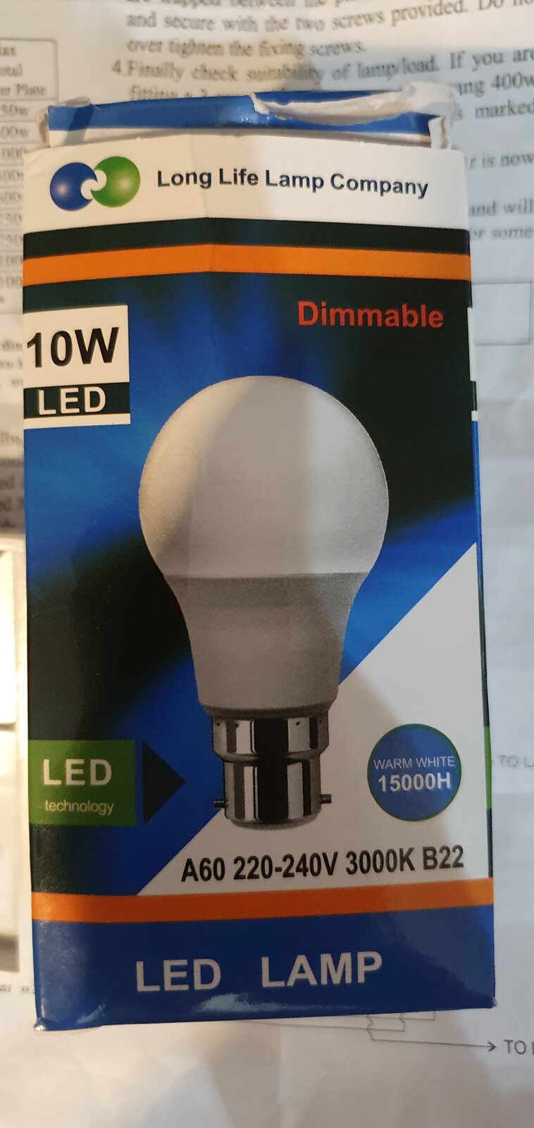

Which Red wires do I put in where.? Just the same as the normal Switch cos I thought that I'd need to have at least one in the Curly X terminal. My Dimmer says min 60w and my dimmerble Bulb say 10w equivalent to 60w ?? I dosnt say whether its for a Led or Normal bulb but says no de-rating required. I don't know what that means so I'm in the need of a little guidance please. Thanks Edinburgh UK oh its a council property !!!!

Put the 2 wires that are in L1 0f the old switch into the squiggly line terminal.
And the single wire into L1
The wiring recommendation above is good and correct.
And the 10W LED bulb does say dimmable, so that is likely to work.
But your dimmer says it is for bulbs greater than 60W. So it is unlikely to work for your 10W bulb. The dimmer is also likely to be designed for old fashioned 'hot' incandescent bulbs and unlikely to work for LED bulbs.
Try your current dimmer and see if it works - it is safe to try it out - but that dimmer is very likely to cause the LED bulb to flash or flicker.
