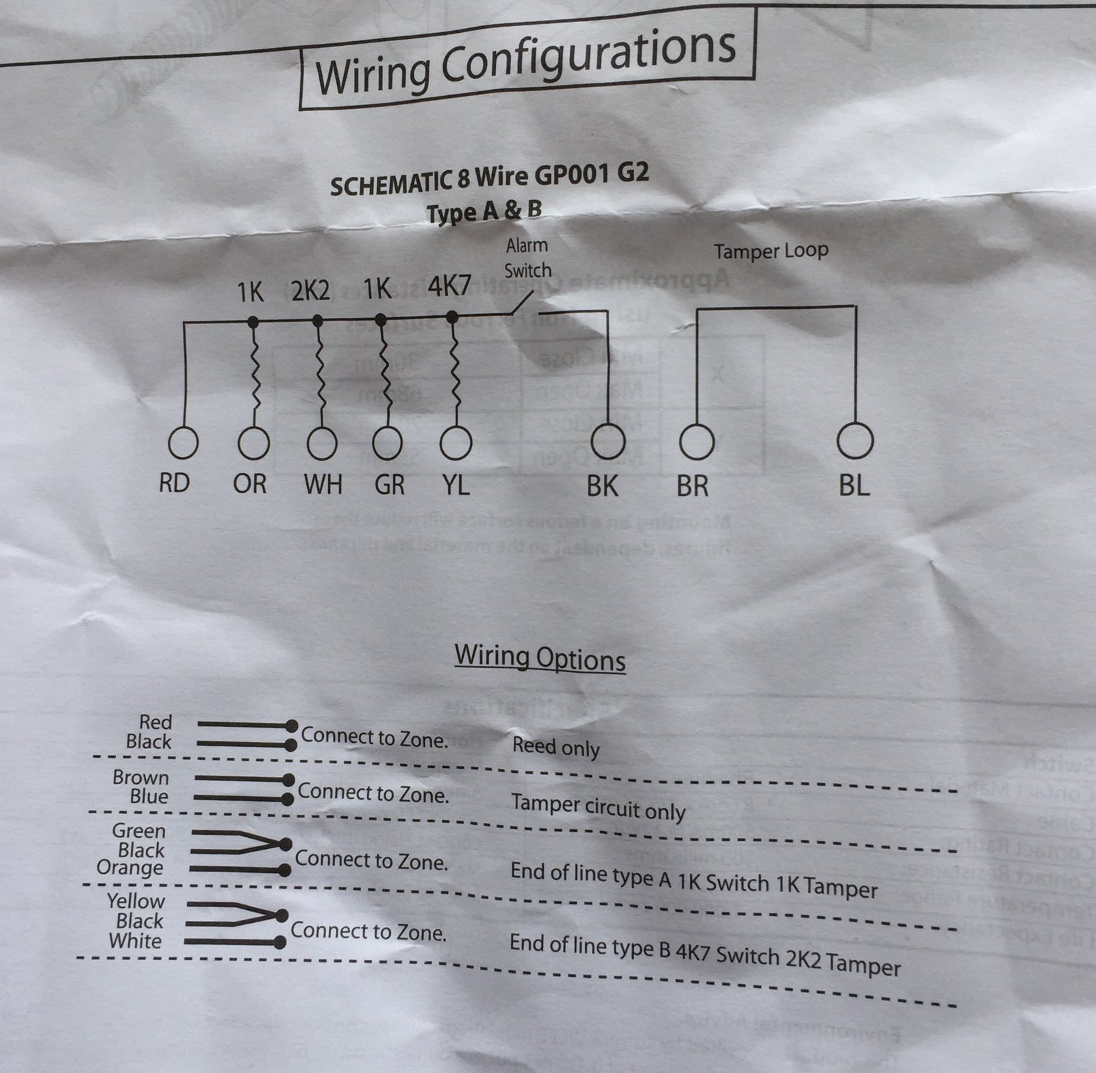

I’ve got a door contact that I want to wire into a Texecom premier elite panel and it comes with the following diagram. My PIR’s are wired in the normally closed config. I assumed there’s two wires here that I need to wire into an available zone but which ones? I’m not using tamper and assume that the contact doesn’t need power.

Sorry guys, can you dumb this down for me please!
I’ve got an expander plugged into my panel which has one wire for the zone and one that goes into a shared terminal for the zone next to it.
Which colour goes where please? Thanks as always :)

But the door contact is pre-wired. That’s how it came. Surely, this means there is significance to the colour of wires I connect into my panel?

normally closed wire red and black to the zone terminals, if 4 terminals like on the metal Elite panels then you wire to the first and last terminal for that zone
if using 4K7 and 2K2 wire Yellow and black to one terminal (the same terminal) and white to the other wiring is the same as normally closed back at the panel.
Thanks @secureiam. Can I please confirm that for the Normally Closed wiring, I wire the red and black into my panel and ignore the others?
If yes, I am wiring these into a 8XE plug in expander. This has one terminal per zone and the other is shared with the next zone. Does it matter which terminal the red and black wires go into?
Thanks for your help
so you have Z9 common Z10 , so whether normally closed or using resistors the wiring is the same . you need one wire to the common and one to zone 9 for zone 9, and you can have a second wire to the common and zone 10 for another device.

the elite QD's you select the resistors and wire according to the manul that came with them its straight forward. You say you have wired normally closed so you should only need to move one wire from the alarm terminal to one of the tamper terminals off top of my head I cnt say which one but I am sure the manual is very clear on where the wires need to go and what positions the jumpers need to be for 4k7 2k2.
