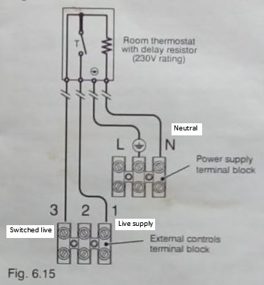

The existing 3+E cable from the old Honeywell stat should be handy, even though I binned the stat itself.
I think that stat fig. 5 and Riva fig. 6.15 are the relevant guides here..
Stat Neutral N (blue wire) to neutral N in the mains power supply block
Stat Live L (red wire) to external controls terminal block 1 (minus link M)
Stat N LOAD to external control terminal block 3 (now also minus link M) using yellow cable (needs brown sleeve on stat end?)
Earth from stat E terminal to E in mains power supply terminal block.
What do you guys think?

For a combi boiler, Fig 5 is the correct version.

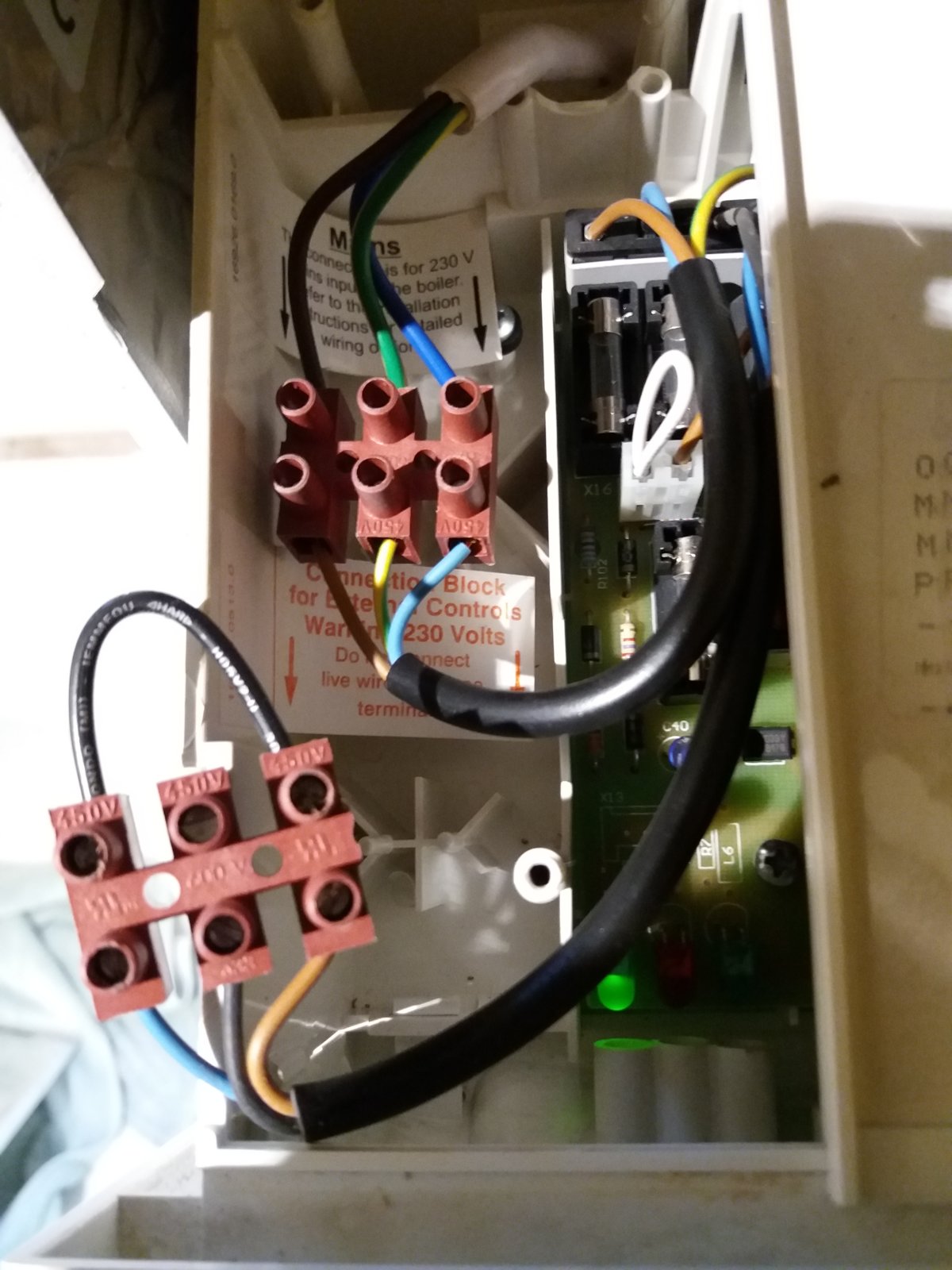

The cable isn't wired in to either the combi or the new Drayton stat (see last image, of combi external control terminal block & mains supply terminal block, both showing no external control wiring).

However, I see that you have binned the old stat, so if you can't remember where the wires were connected to it went, the wires from the boiler can be identified from the diagram you posted below:

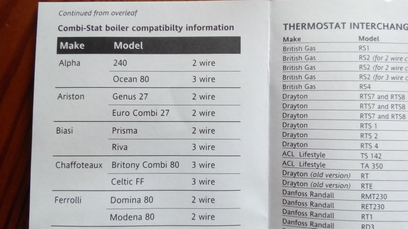

And the thermostat instructions
So, I think your description matches this, and yes the link should be removed. Although I assume you know this as you must have put it back to get the boiler running when you took out the Honeywell.
The Riva was installed without the old Honeywell stat being wired in, hence the image with the link M still in place.
