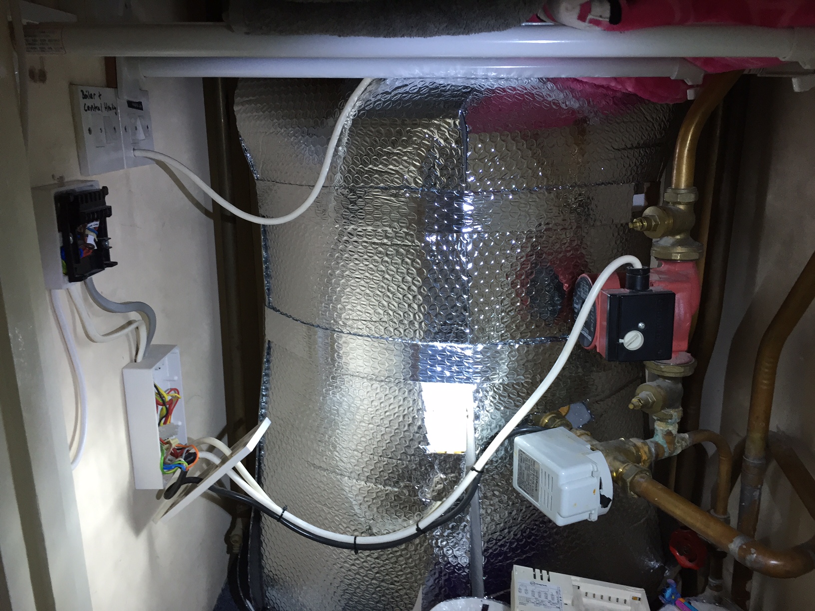

I bought the Hive Active Heating 2 (Black Friday) but I'm having trouble with the wiring. It seems my 20+ year old system is missing one wire - has 5 connected, but should have 6 wires.

I have a central heating + hot water system:
- Ideal Logic heat only boiler
- Lifestyle LP522 programmer/timer
- Hot water cylinder, pumped/gravity fed system/mid position valve, tank and room thermostat

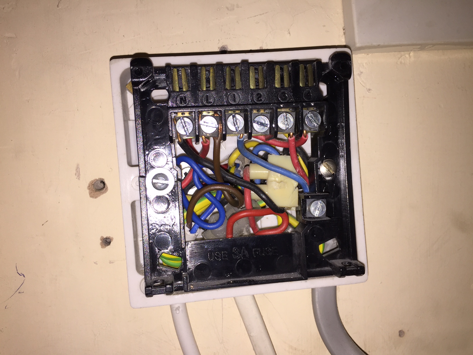

This is the current wiring:
N - Neutral
L - Live supply (red) + Permanent feed for new boiler (brown)
(Previous boiler was switched by the timer but new one required a new core)
1 - HW/OFF (blue)
2 - **BLANK**
3 - HW/ON (red)
4 - CH/ON (red)
I tried wiring like-for-like on the new Hive receiver but when I tested CH, both CH and HW came on which doesn't look correct. I disconnected and put the old programmer back on to avoid any damage to the system.
Does any one know why my current system doesn't have a CH/OFF connection?
How should I wire this up to the new Hive receiver?
Any suggestions/help would be greatly appreciated.

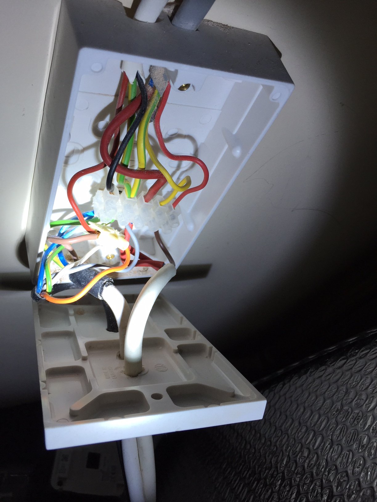

P.S. I opened the junction box on the wall and nothing's labelled. It would take me some time to work all that out but maybe that's what I need to do - but hoping someone has a quick answer:

Exactly the same as the existing programmer is wired.
OK, I did that but when I press the CH button on the new Hive receiver, both CH & HW comes on. On the other hand, when I press the HW button, only the HW light comes on (CH remains off). This makes me think I need to alter the CH wiring a bit to suit the new Hive receiver.
That is a function of the Hive receiver, the wiring doesn't cause anything to switch on or off.
The Hive unit is probably in the wrong mode. Most likely set to Gravity rather than fully pumped.
Spot on! Not obvious the mode when the status LED is flashing amber (in case anyone else has the same problem). Need to follow the instructions and hold the HW button 10 seconds - and check BLUE (gravity) or GREEN (pump). Thanks flameport - was very easy to install had I not overlooked that.
